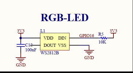

I checked that resistor and it was 10k ohms. I removed it and bridged the pads with solder. I checked for continuity between the 3.3v pin/rail and the led. All seem to be okay. But when I load the firmware the light doesn't light up.

do not bridge the pad, leave it open

THAT WAS IT!!!! Thank you!
I have a bunch of these RP2040-Tiny clone boards. This is the first one I tried to remove the 10k ohm resistor, but removed the one directly to its left as well.
For giggles, I plugged it in and it lights the same way as the one which I did not remove the second resistor.
Anybody know if this matters or what the purpose of this resistor is? Will it be a problem that it is missing? I can easily just junk the board, but if it doesn't matter I'd love to use it.

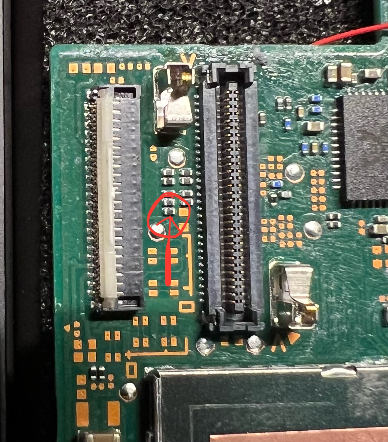

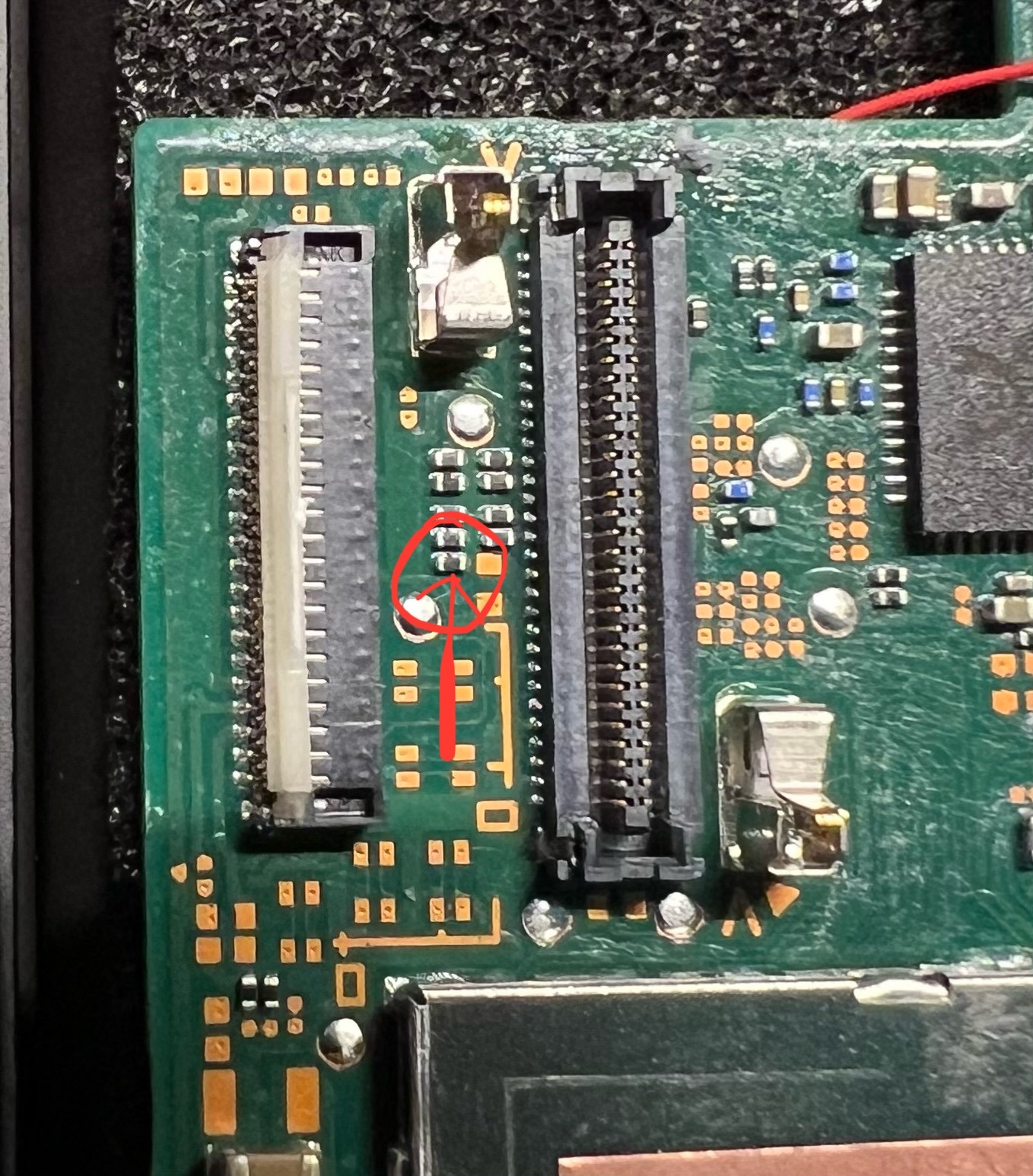

Does anyone knows what might be the resistor value if this for oled? Its near the lcd connector. I accidentally knock it off when I dropped the tweezer.
Yeah, I'd seen this diagram. This is the clone RP2040 Tiny. It's got the 10k resistor at R5. I didn't expect that removing it and leaving the pad open would be the solution though. @psycho-neon even explicitly said to bridge the pad. But also I may have misunderstood.
Any idea why it works with the resistor removed and the pad open? I would think that would leave the DIN open and prevent signal from reaching the LED.
I mean, it works, so that's the solution. But I'd love to know why.
Sorry for the misunderstanding. The bridging i was talking about was the resistors for pin 27 28 29 for dat0, cmd and clk point. For LED it should be left open for clone ones.
No worries at all. Thank you for the info. It all leads to the answers.
