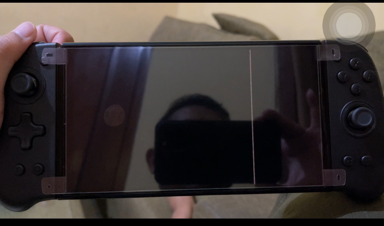

When I enter the EMUMC partition, the official system and Syscfw system I watch the screen show two white color lines time appearance logo atmosphere logo and show the official Netindo screen logo and does not appear something checked Points and check DAT0 cleaning Motherboard Nothing There is nothing but this thing is not separated if you separate the CPU Point wire in the RP2040 CHIP widget ... Please answer this error in Boot Chip.
Cfw ofw emummc 18.0.1 hats pack 17.0.3
I have video.. You can see one line frist inter emummc and after logo atmosphere...

yes but I want to know why this happens because not everyone experiences it even with same chip or not
If you want to know, then you need to buy some Logic Analyzer or Oscilloscope then you need to find a way to clip pin in the oled connector, and find some unusual signal. Then you trace back what line produce those unusual signal, it will ended on some ic or resistor or capacitor. You test one by one, maybe by removing it, and check whether the unusual signal produce or not. Then you found your 'reason'.
For me, thats wasting time. As long as its work, and not interfering with me enjoying the game, then all is good.
It doesn't depend on the modchip, in my case (RP2040-zero) I thought it was the modchip that was the problem and I replaced it but nothing has changed.
Among other tests, I also removed it and the console no longer showed the line.
Of course I checked the flat video as well... perfect. In my opinion it's a bug in the code on the video refresh because it appears when the video is reset on the screen
