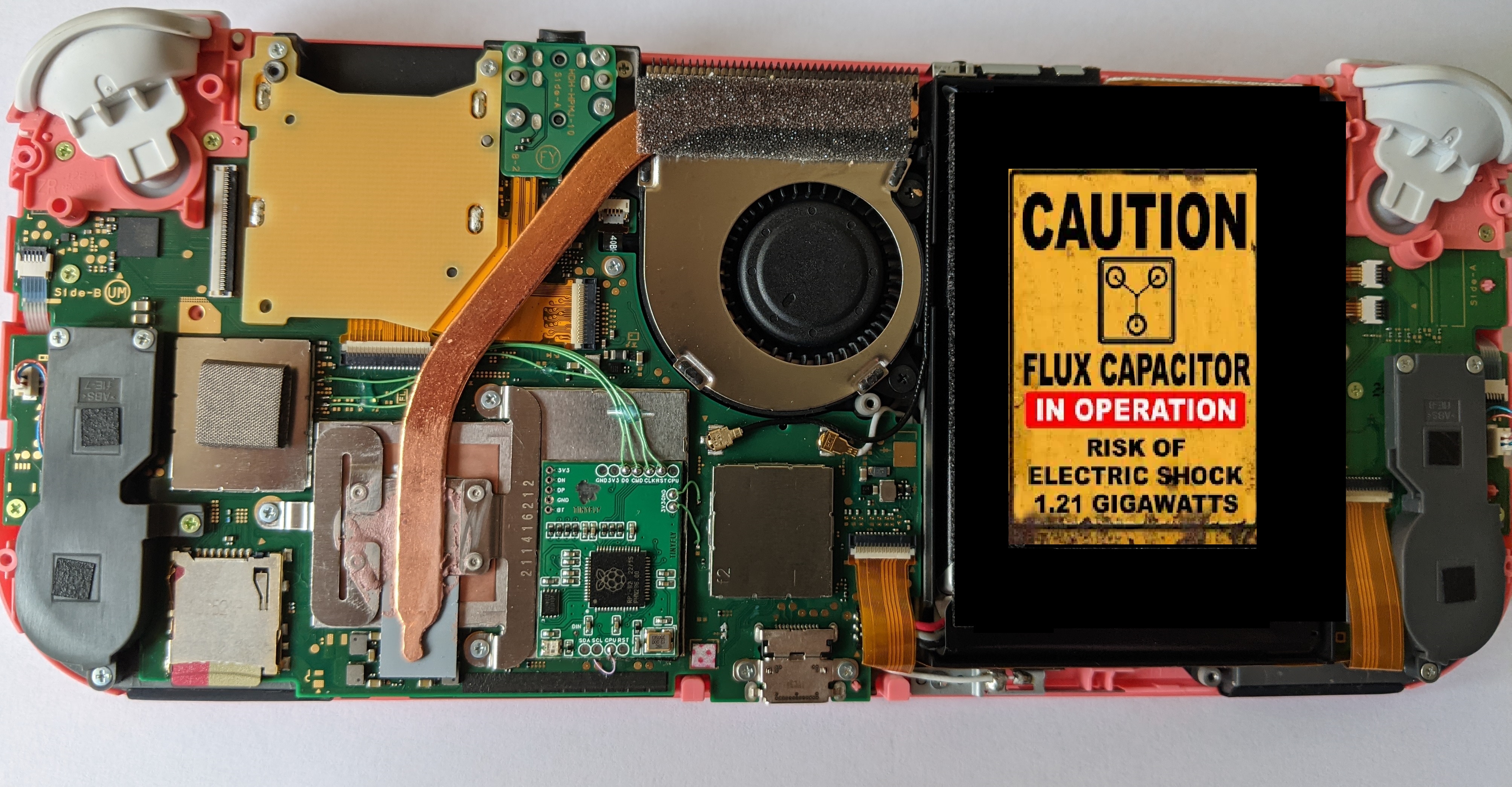

Thank you Doc for rev 2.0c, works great.
@psycho-neon

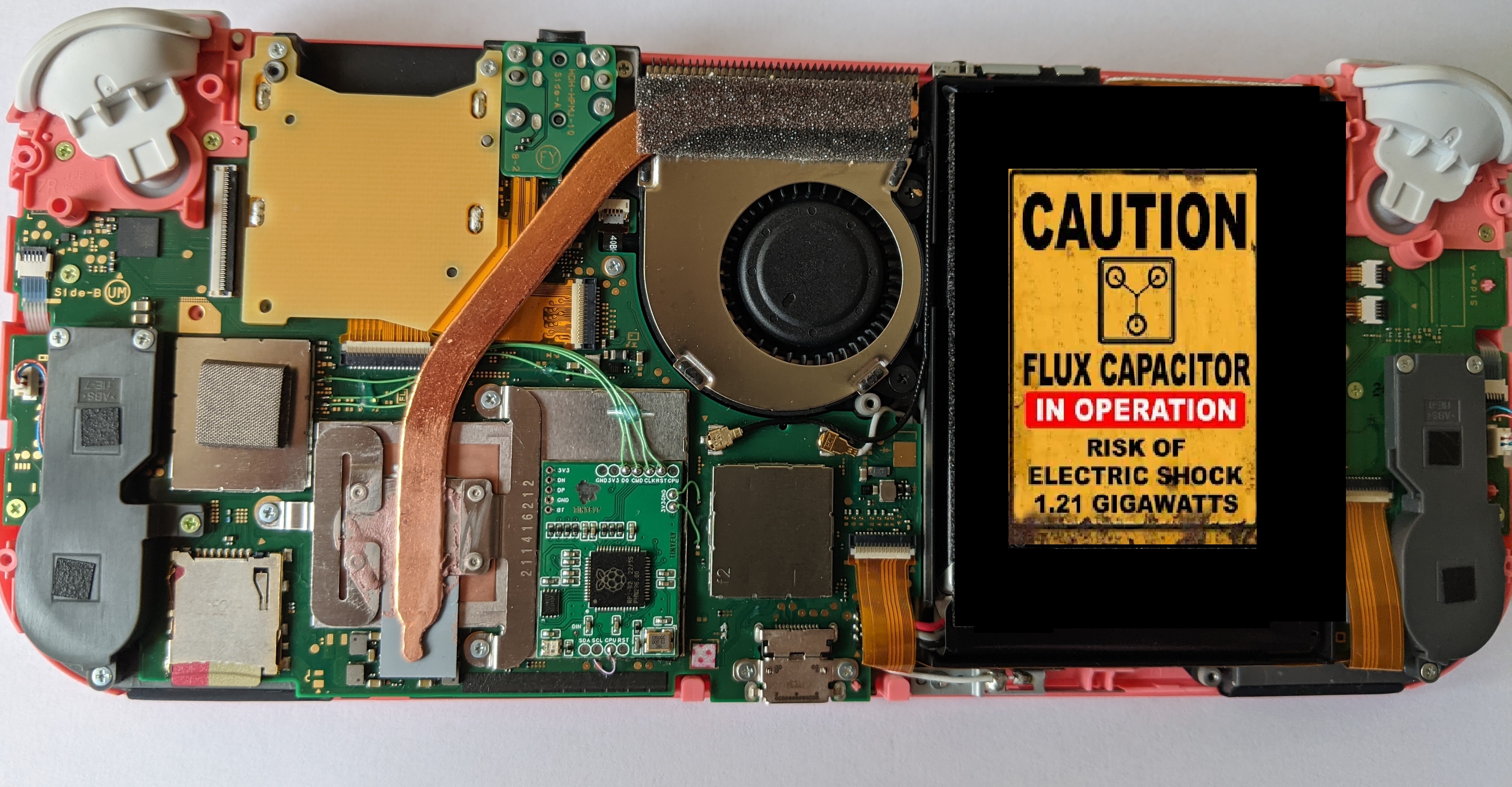

I found a solution for OLED switches with Dat0 adapter which are capricious and refuse to start.
I tap lightly on the place indicated in the photo, this is obviously enough to put the adapter back on the chip and the console then starts on Atmosphere.
Could this pose a real risk for the console?
Did this a couple of times on the first Oled I moded (for a friend) but after a while it did not work anymore so I changed the dat0 adapter and still works to this day (while taking a beating constantly from his 2 kids).
Now, after some experience with these consoles, I think this is not a wise thing to do since depending on how loose the adapter is and which side is leaning toward to under emmc it might lead to corruption of nand or maybe some other “mysterious” issues that we faced here while using dat0 adapters.
Better to redo the work (or better yet do a reball or kamikaze) than to rely on a “lucky slap”
Reactions: Danook28
Joycon buzzing play cult of lamb and 3 to 4 days the adapter move littel bit and the cfw not working so i open console and fix adapter with new one add bit more iron under the point that conect to dat0 iron ball and to gnd legs and now cfw working... 👏

Thank you ,Doc, for rev 2.0c, works great.
@psycho-neon
lol flux capacitor, docs from go back to the future
common issue on flex dat0 adapter
