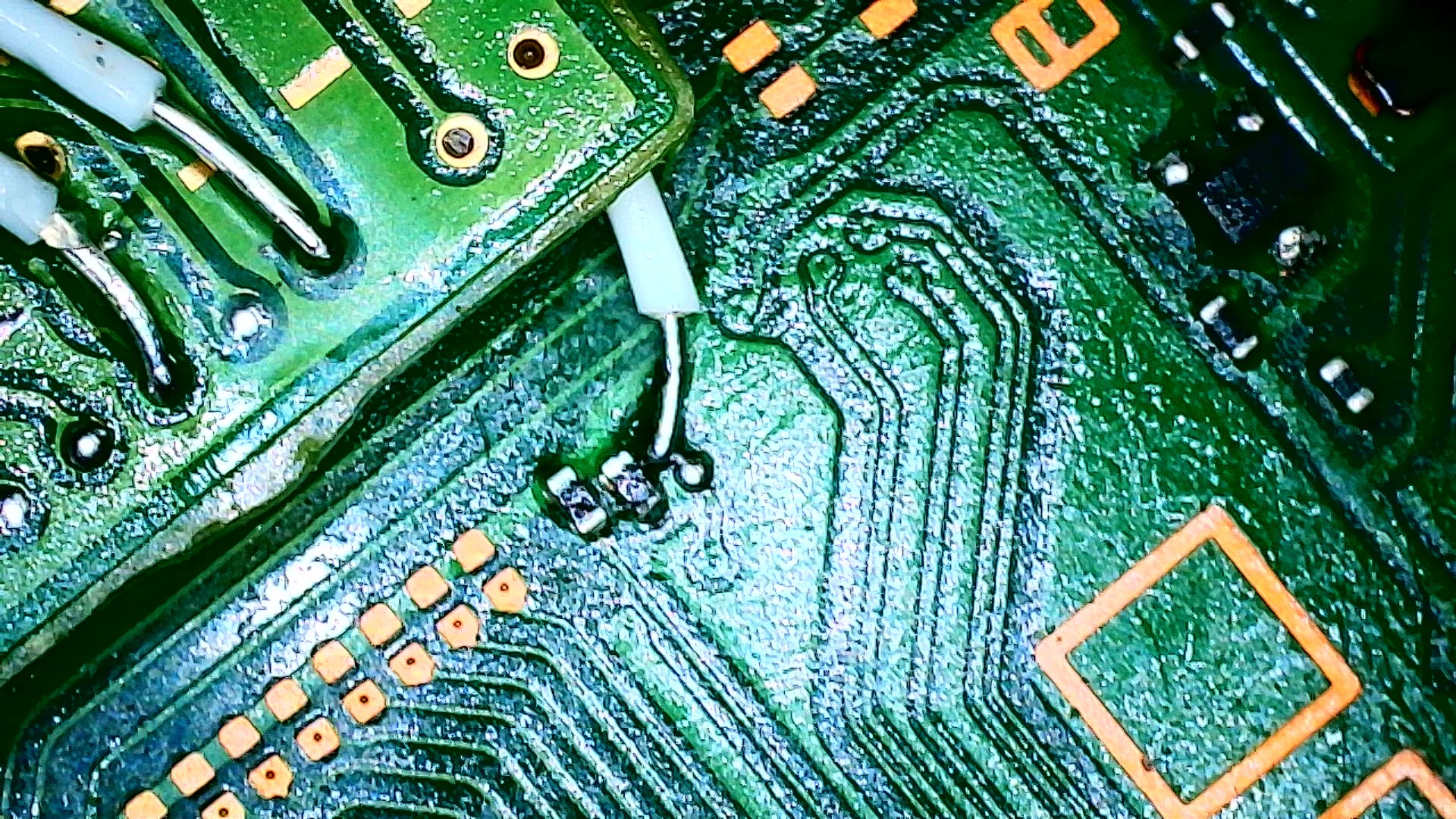

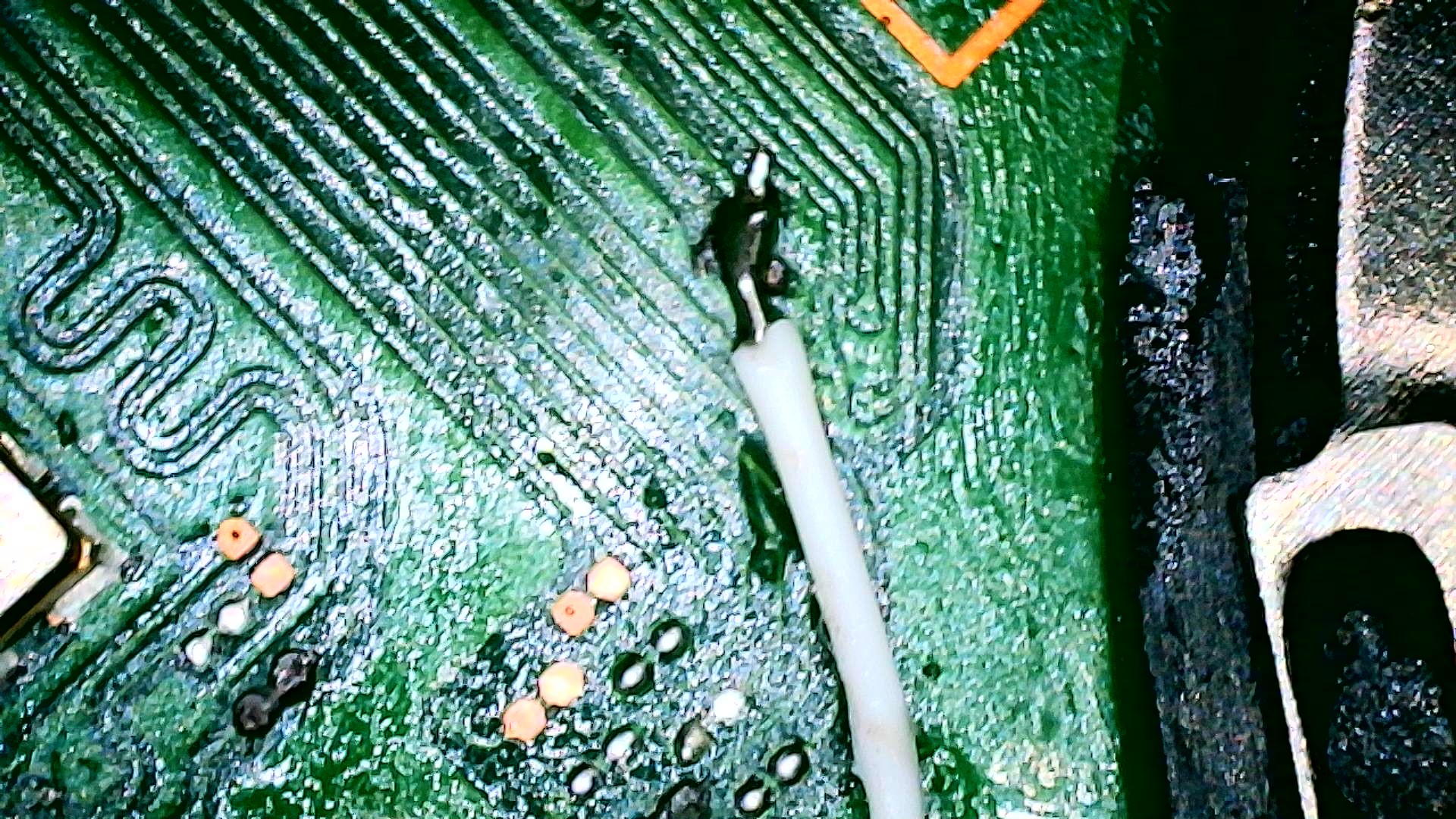

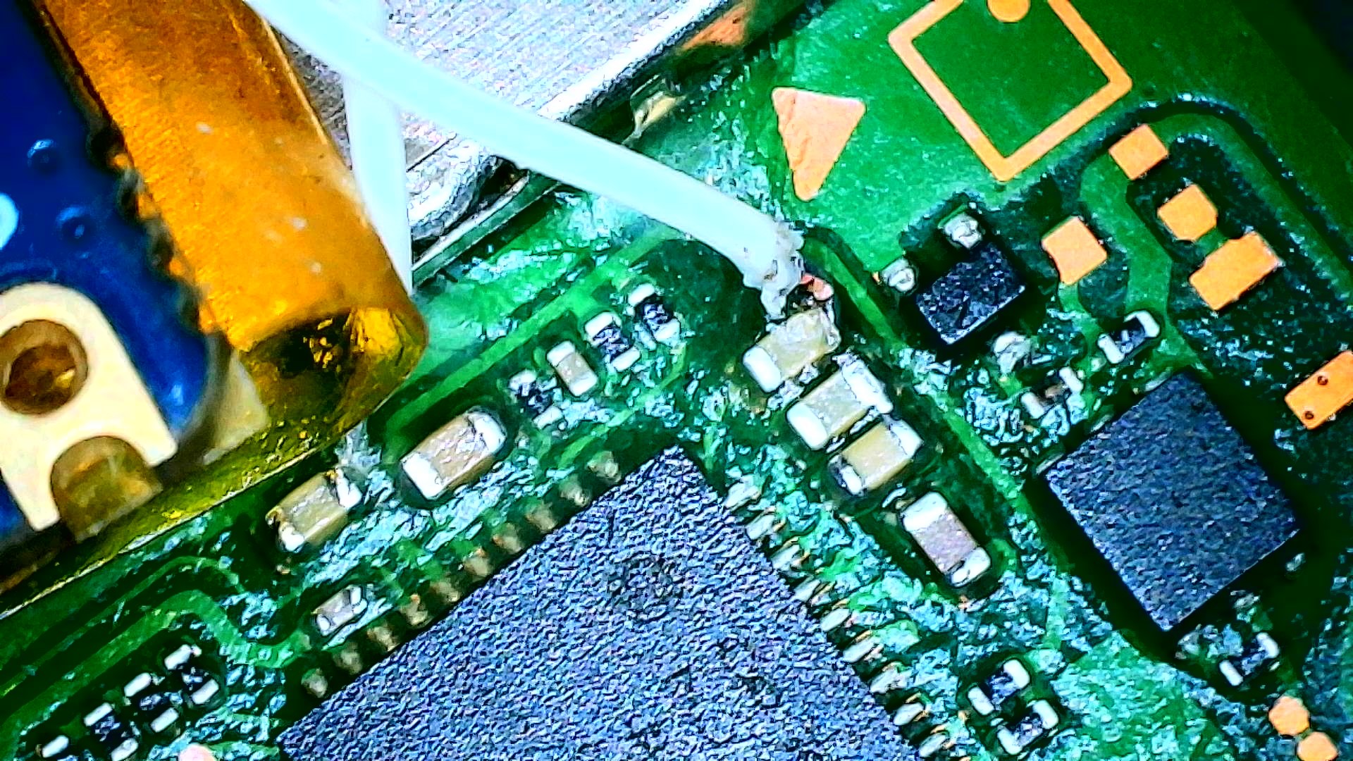

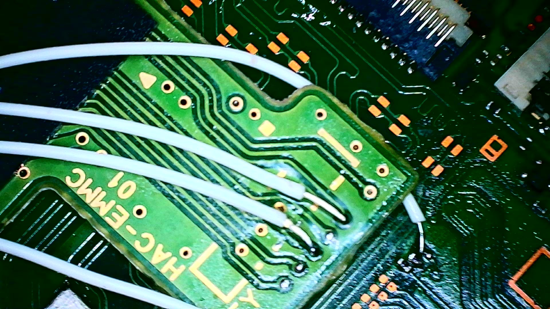

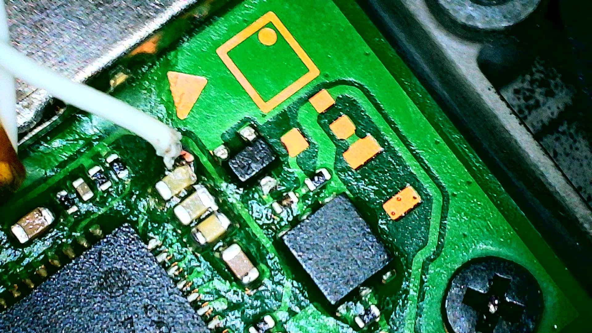

Hi guys, first time doing a picofly install.
I got a waveshare rp2040 running 2.73 firmware from here (https://github.com/Ansem-SoD/Picofly/tree/main/Firmwares). I'm installing on a patched V1 and during the process, unfortunately, I lost some pads but luckily there are alternative points for these. So I'm at the point in which I've connected the whole thing but when I turn it on I get blue led then it goes long yellow, then short yellow. Per the documentation here (https://gbatemp.net/download/a-definitive-picofly-install-guide.37968/) this means Dat0 is not connected but it is. I check continuity in other Dat0 points to see if it was connected, and I have continuity all the way to the board. Here are some screenshots of what I've work.
Alternate Dat0 and CLK. Also RST can be seen.
Here is a better view of RST.
Although it looks bridged there is only one pad there so it should be ok, this is CMD
Here is ground
Here is 3.3v althougt not very well focused. That one should be fine since it is turning on the chip.
Any suggestions? I did not include pics of the CPU flex since the error points to DAT0. I believe them not to be relevant but if needed, let me know.
Here is groundView attachment 410654
The dat0 connection between emmc and cpu travels through the pads you've ripped off. You need to restore the connection somehow.
