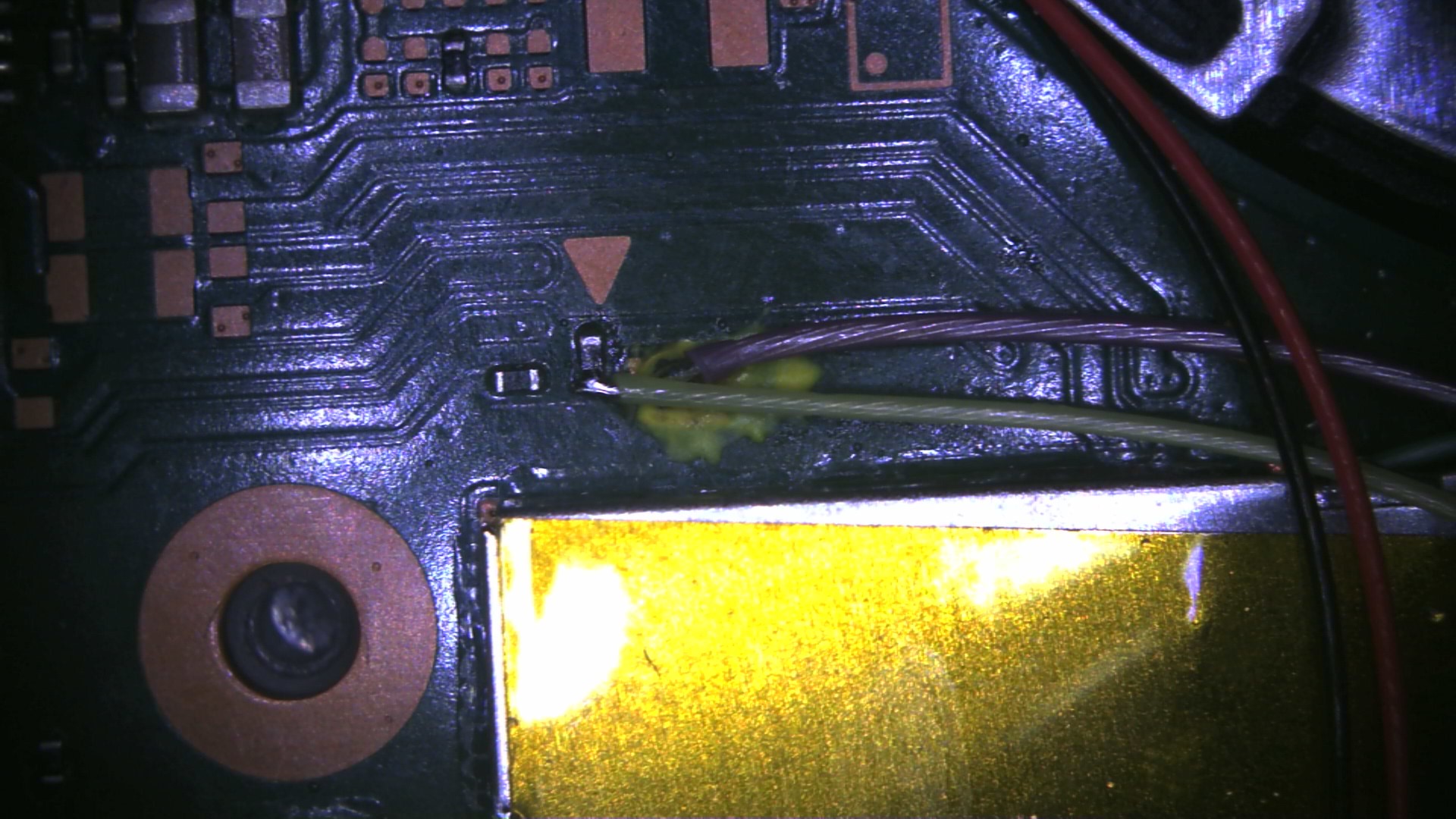

kamikaze time...i have spare time to tinker so i did what i can to do a OLED kamikaze mod ( DAT0 )....patiently diggin cleaning and hard work paid off....

I just tried kamikaze again. This time patiently doing the grinding. The 0.2mm tip was good at this method. My first attemp of kamikaze was I almost cut the CMD line. 😂 Now I am more confident to do all these on my future OLED modding. No more removal of the board.

How much time would you say it takes to do the dat0 point this way? from start to finish, so to speak
