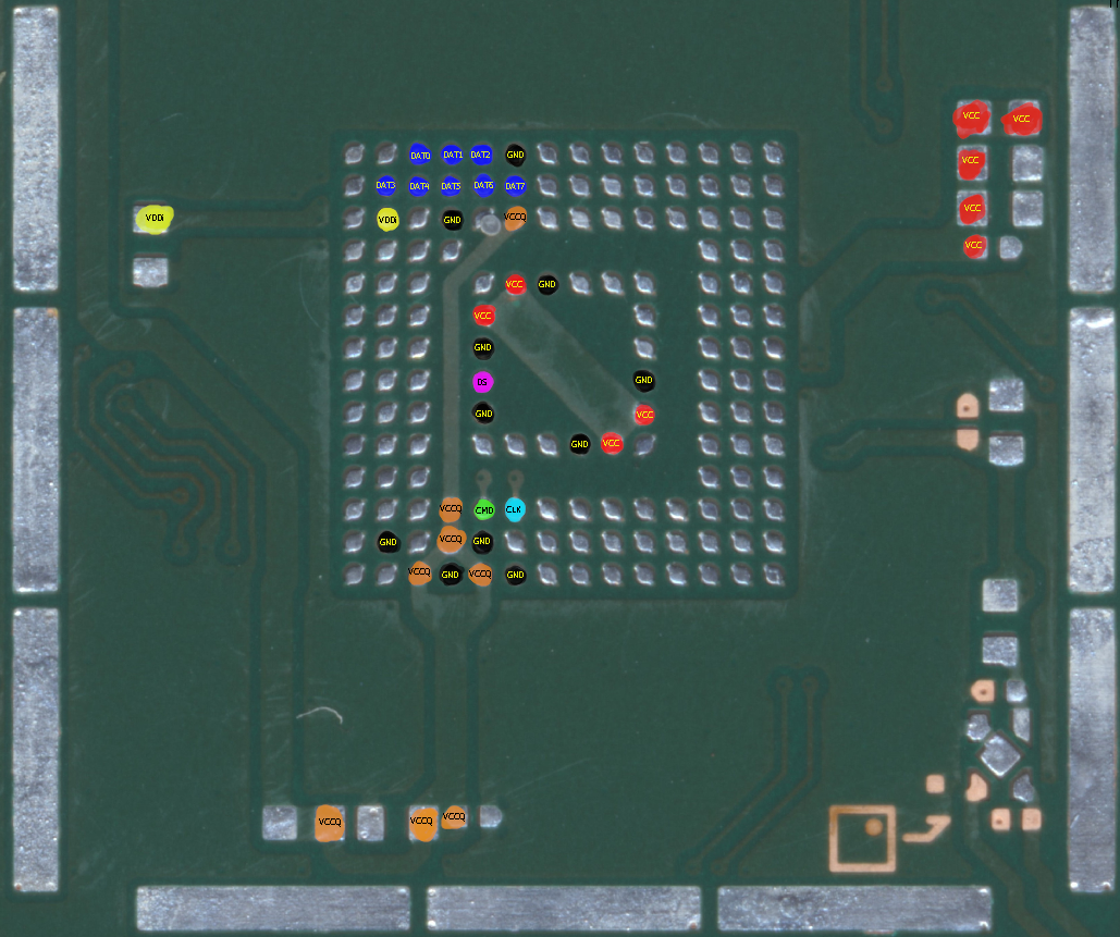

Also, for bonus points, which pin of the emmc does the adapter tap into? I still dont understand how it can go in there without reballing/soldering. Does it just put into the existing soldered point?
What makes it a bad dat0 adapter?
The bad adapters are either not well anchored or have a bad shape on the dat0 connector. The adapter slides under the emmc and is pressed against the dat0 point and then soldered with "anchors" around the emmc to stay in place.

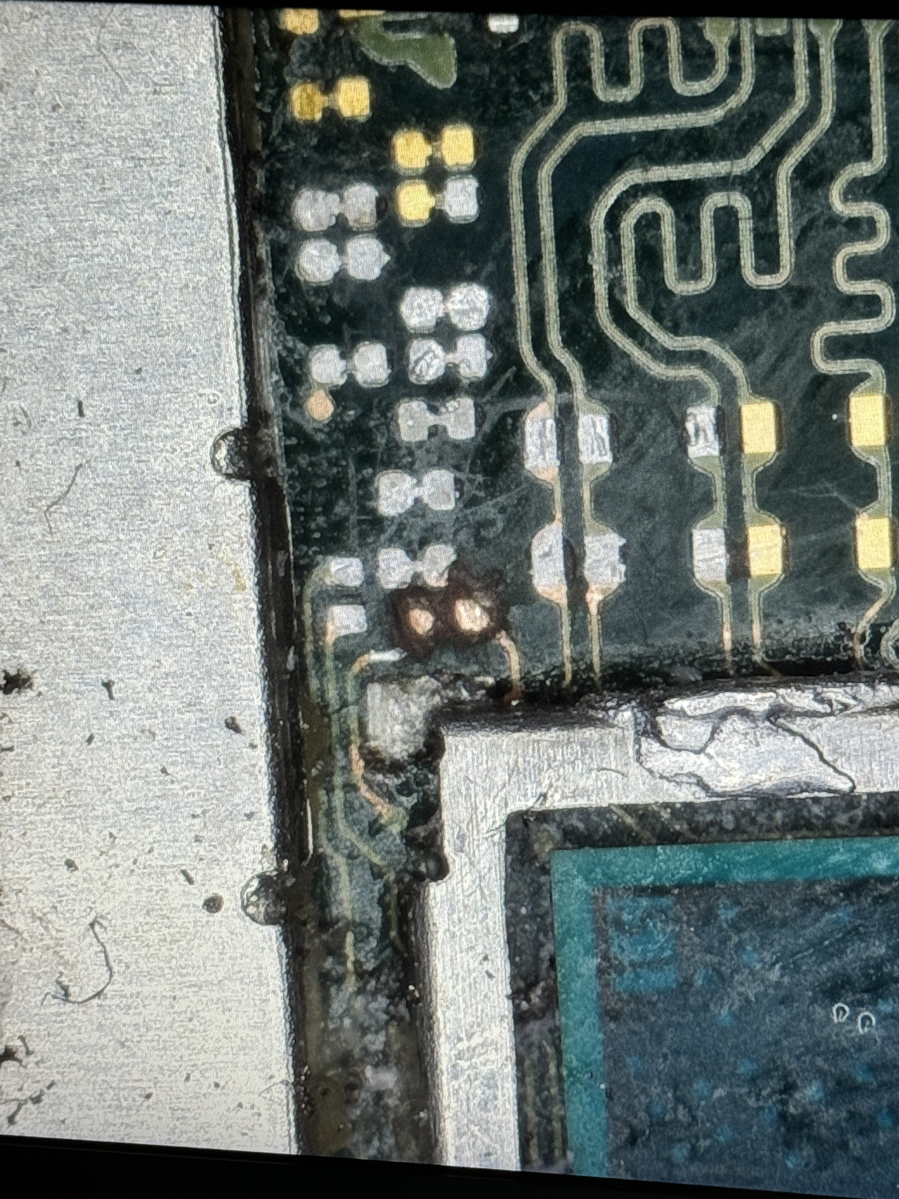

Hello!
Today came a Nintendo switch lite with a failed Picofly installation and the buttons don’t work, when I opened i see a disaster, but one thing caught my attention.
This 2 point are no more, so, I think this is the problem.
Anyone know where this 2 points go? The connections that there see just are ground.

Hello!
You can run a wire between the traces.
Mask the damage if it has been scraped to the ground plane on the layer below.
You are also missing what I think is a 100ohm resistor (size 0201). The position is indicated with blue cross.
using a $10 iron and an iPhone
Everyone sees it differently. But you should invest in some equipment, especially if you mod for others.
It won't do you any good if your soldering iron doesn't produce enough heat and you end up with cold soldering joints.
P.S. By the way, I think the cable is too thick. Solder pads can tear off very quickly.

Interesting.
According to your attached image the dat0 point (in blue) is near the top left, however, the dat0 adapter is slid in from the bottom. How does it connect to the correct point? According to the image not all the emmc pins are needed, does it mean they aren't all soldered which is why the dat0 connection can slide between the chip and the board?
Because we aren't reballing/resoldering my assumption would be the dat0 point sidles up against one of the emmc pins along the outside perimeter and just touches it to make a connection. Is that right?
Interesting.
The top of the picture is the side where the dat0 adapter slides in from. a lot of emmc pins are not used. they are still soldered, just not actually internally connected to anything on either the mainboard or emmc side.
the dat0 adapter simply has a small metal edge at the right spot which makes it press against the dat0 ball, so yes, just touch. not really a permanent solution, but it's the only "easy" way to make a modchip reach that point.
Got it! Thanks.
Makes sense why we need to make sure it's anchored properly.
