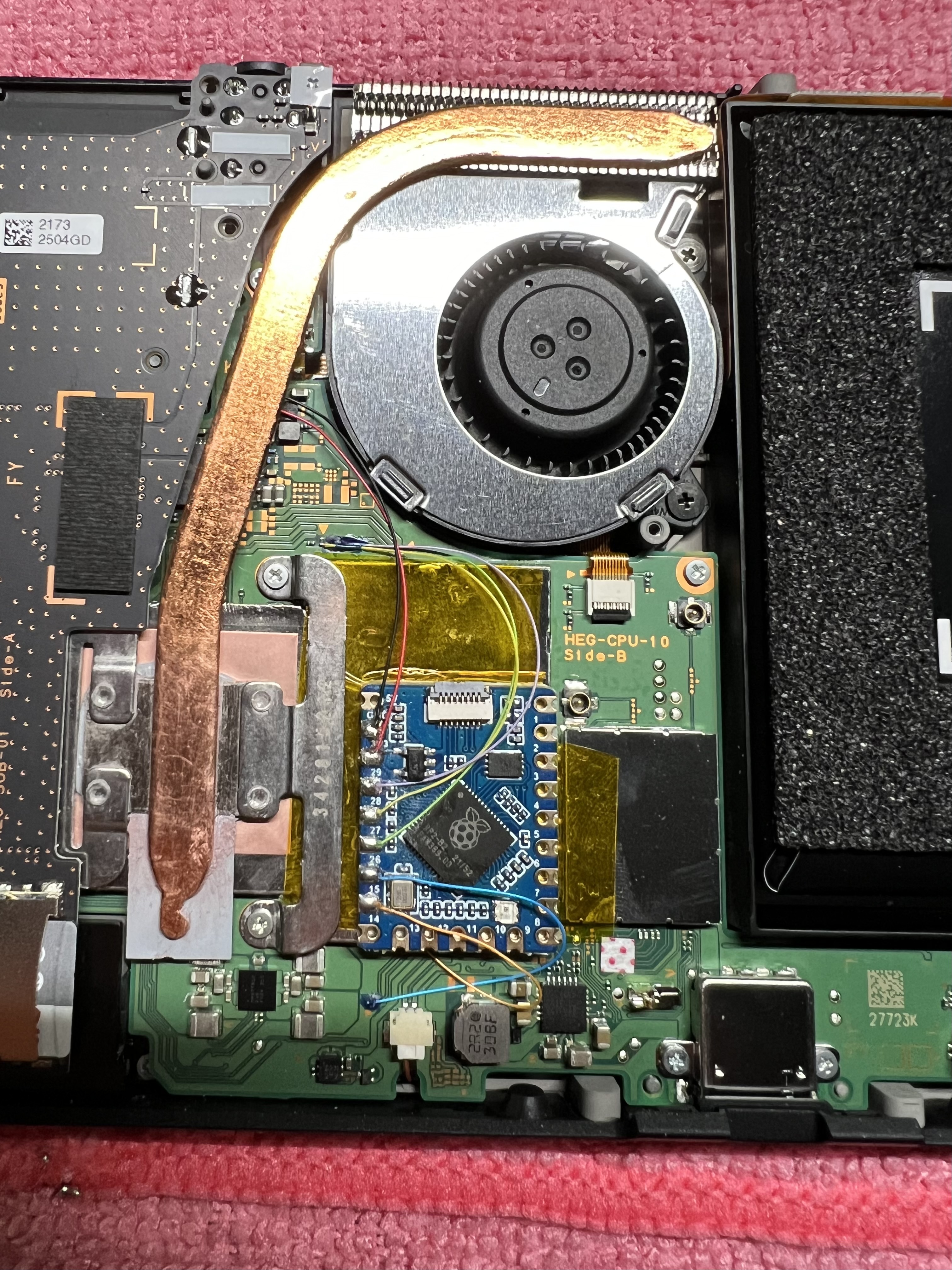

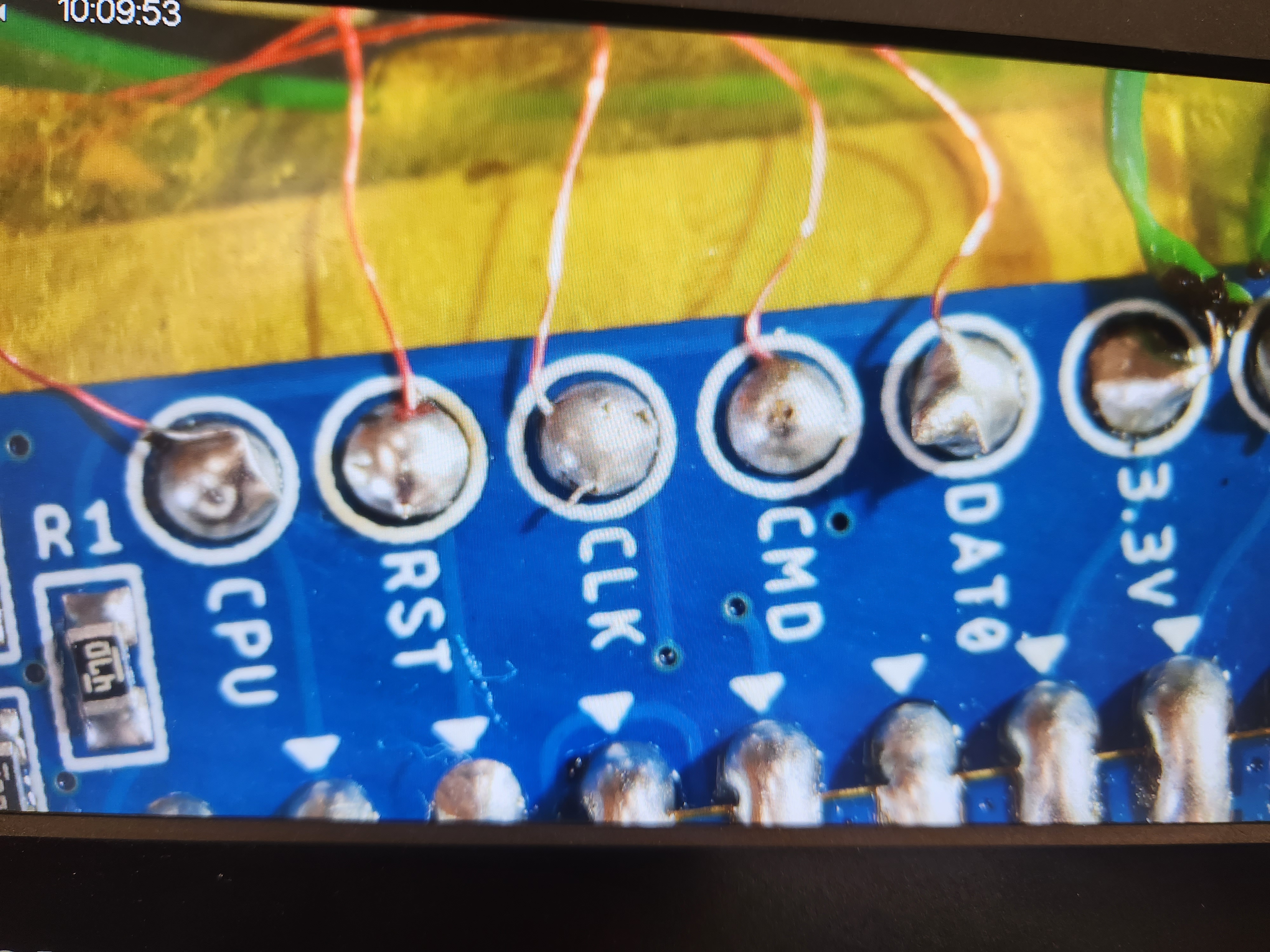

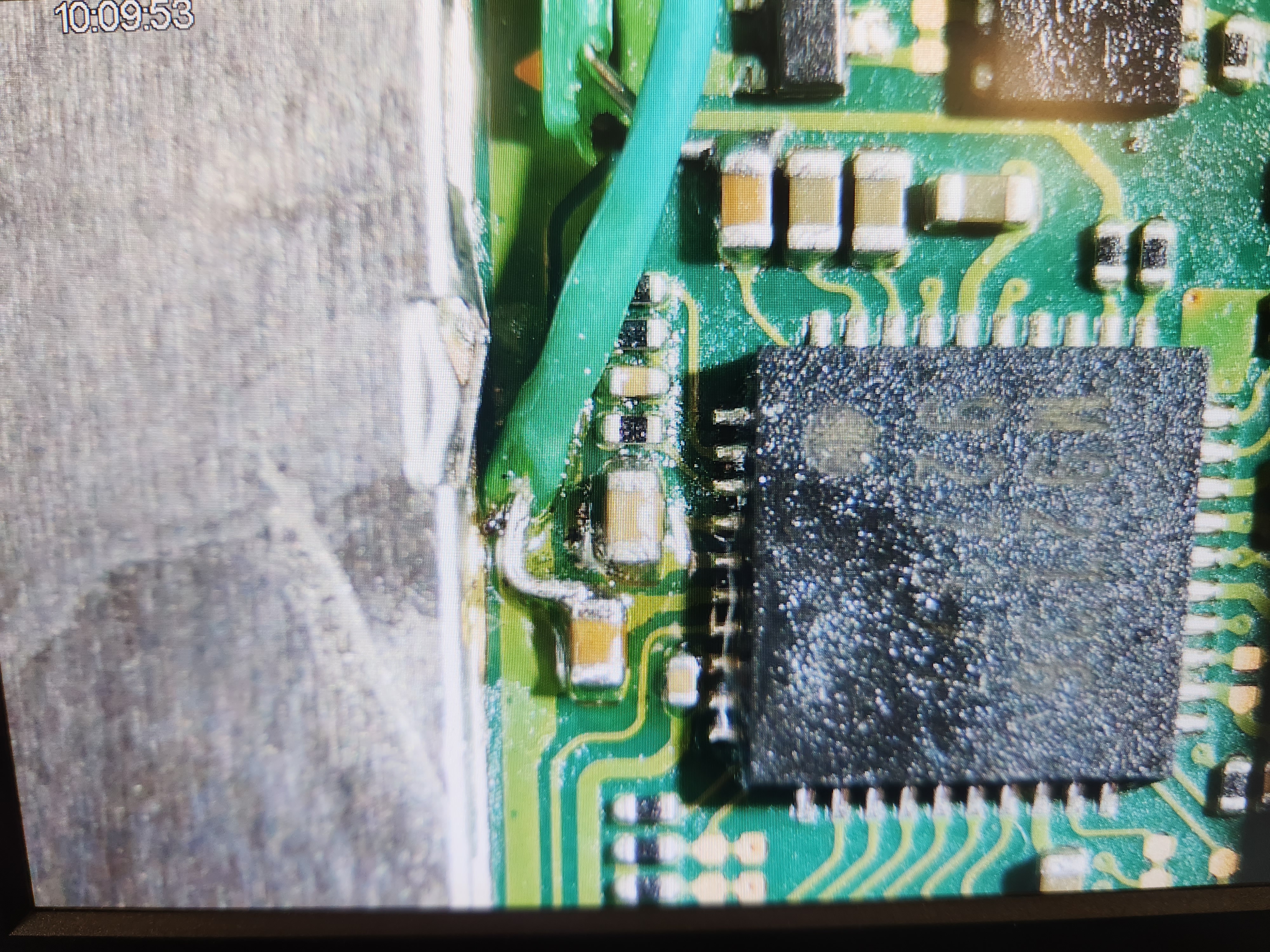

Could you photo the point you use for 3.3V?
3.3V is the cap on the APU side of the m92 chip. And yes, the soldering could be better, but after the 3rd or 4th attempt, I was going for quick and dirty.
The 3.3V point is correct in there.
But the quality of the soldering is concerning.
I am afraid that it might SC with the apu's grounding, with a slight shake.

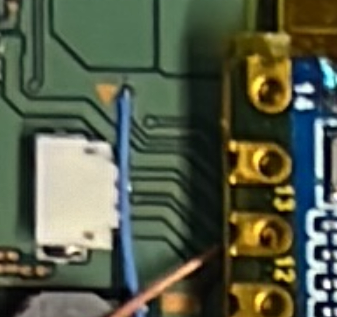

Is the blue alternative rst point??
