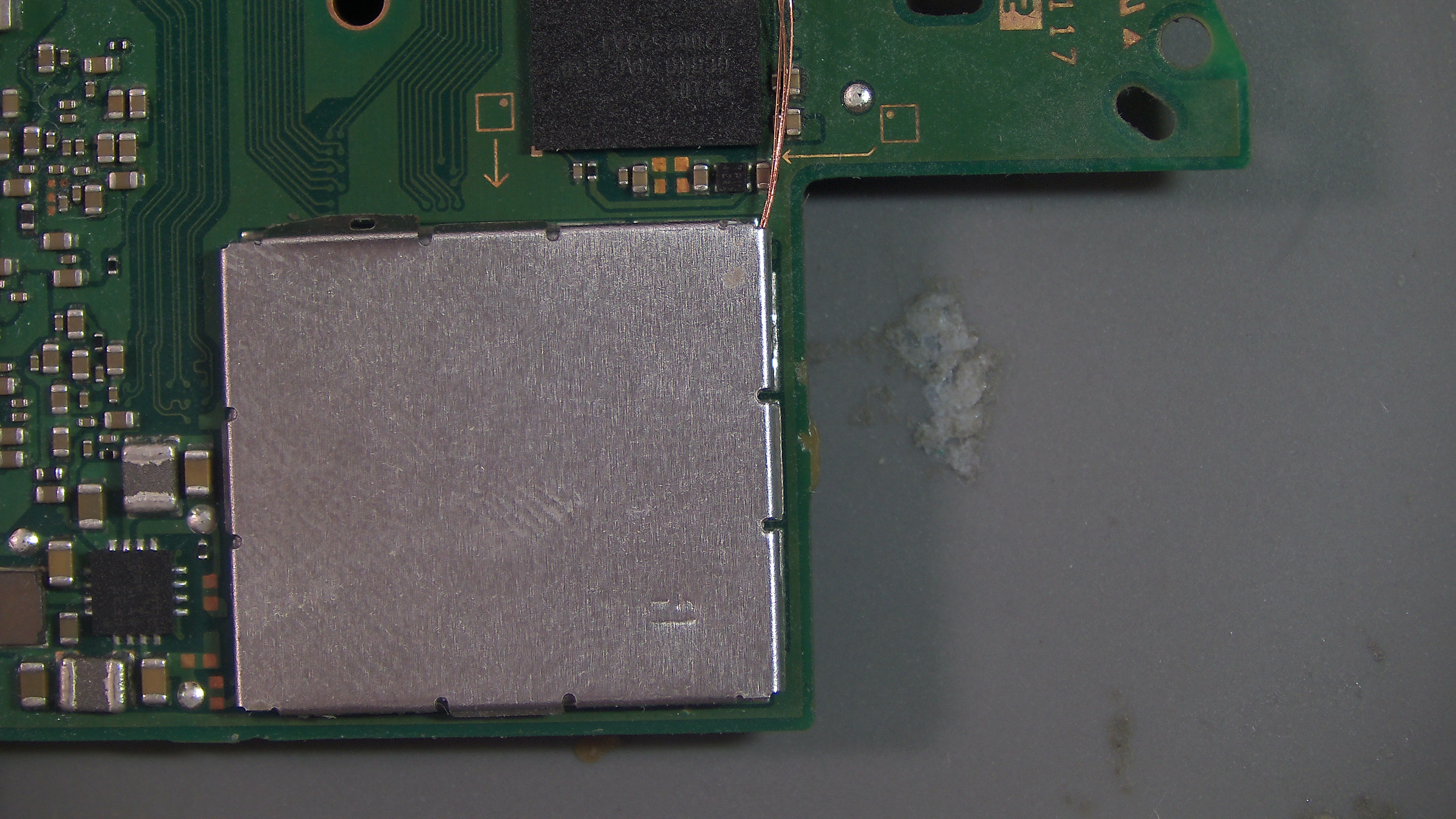

hey guys. having an issue. everytime I ground my pico chip, the rst value changes and the console insta boots. pico blinks saying rst not connected. when I remove grnd from chip the value for rst is correct
Are you using rp2040 board or the hwfly clones? Might as well put some photos about the rst solder point
I'm using a pico dev board. I've tried 3 different board.
the joint may look cold but it's just the lighting I promise. if I remove 3.3v also the rst value is correct. it's like it's all shorted somewhere?
oh my God I'm an idiot I had 3.3v soldered to the wrong cap. IDIOT

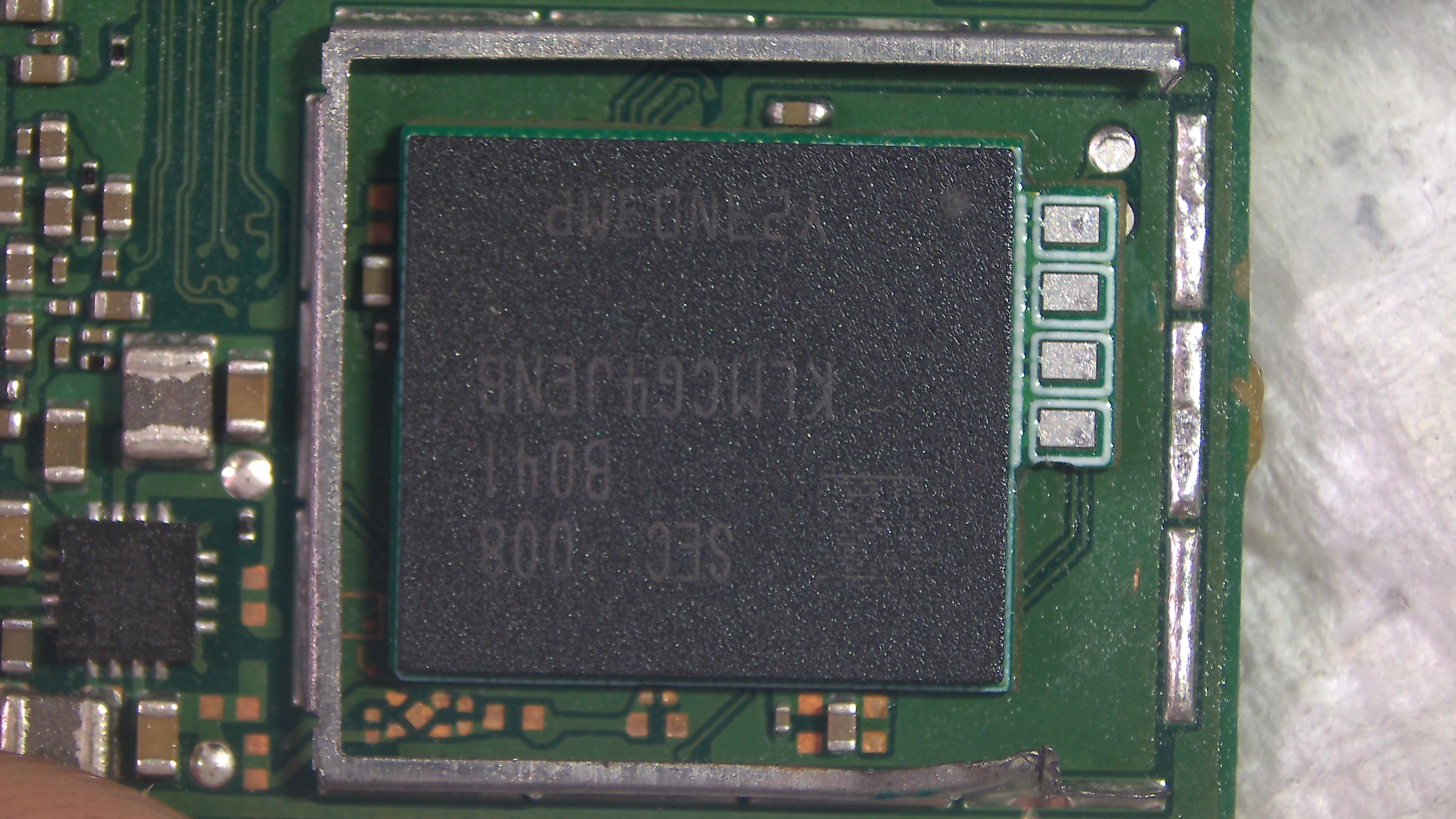

Hi, sorry for my English, but could someone help me, I installed the picofly chip in the OLED switch, but there are times when it causes the glitch, and there are times when it doesn't perform the glitch, so I try again, and it it works.
but when it doesn't work, it gives the sequence of yellow blinks as follows: *==.
a short one and then two long ones, and it enters the OFW.
Would anyone have any idea what it would be?
Note: EMMC value is correct
I've been having an odd issue, similar to this guy, over the last few months...
Successful / stable OLED install, boots payload super fast.
After a few weeks, I get =* d0 error, boots OFW.
Open console, remove battery, check values - okay, back to stable/fast payload boot.
After a few weeks same thing. Remove battery, check values, fixed again.
I have tried replacing d0 resistor, same behavior.
Thanks for any ideas!

dat0 adapter or reball with permeant wiring?
