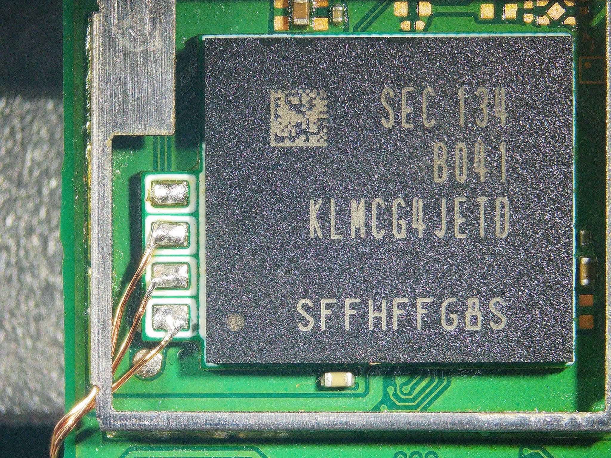

I timed myself today during an oled install from scratch, with checkpoints for important steps. I figured the numbers might be helpful to someone. Note that I am doing the emmc-mitm-adapter with reball which is a bit more time consuming than most installs.
00:00 start. virgin oled, rp2040-zero, resistors and mosfet on the table. starting chip preparation
11:42 rp2040-zero flashed, buttons/usb/ldo removed, resistors soldered. starting mosfet preparation
21:25 wires of appropriate length and curvature soldered onto mosfet. starting switch disassembly
31:07 switch disassembled, mainboard in pcb holder. starting removal of emmc
46:51 emmc removed, emmc and mainboard solder wicked and cleaned. starting reballing
1:00:25 emmc-mitm-adapter and emmc reballed. starting emmc reattachment
1:14:45 emmc-mitm-adapter reattached and important points measured, emmc reattached. starting mosfet soldering
1:29:28 mosfet soldered, apu shield cover reattached. starting chip wiring/soldering
2:00:20 chip and all wires soldered and measured. starting reassembly
2:17:54 reassembly complete, hekate running. done!

Hello, both my oled came back with installed picofly, modder seems to have done a good job.
I'll send later all the pictures he sent me during the installation.
He is in france, if you need someone to do it for you (he ask for 130€ for oled) I can send you his informations.
Here are all the pictures he sent me during the installation, what do you think about these?
Nice clean soldering but....
1. He is using a dat0 adapter :/
2. There is no need to cut the shield in Oled.
3. Why the f*ck would he drill a hole in back cover?!?! The led is perfectly visible (from bottom) if you place the Tiny in the right position.
That being said, for the work he has done (the way he did it) 130€ is to expensive in my opinion.
But it should work OK so no worries there :)
Looks good, except that he cut the shield which isn't needed on oled - just put the chip a bit further down and it'll fit nicely under the shield. Interesting idea to make a hole in the plastic to see the chip led - but ultimately pointless, since you can see the led anyway if you just look at the switch from the bottom
I think the only ones who don't use the dat0 adapters are us elitist nerds in this thread
I understand doing your own switch with adapter since it's waste of time and money to get the equipment and learn to reball (for most people at least), but if you are doing this as a business there is no excuse.
As someone said way back on this thread (I think it was Dee87) "If you are going to take money from people you should do a proper job".
There is also that satisfaction in being able to do that first reball where you don't screw anything up (which is worth a hell of a lot more) but I guess thats just for us "elitist nerds" as you said :D
I agree with you (and Dee87), but I haven't heard of any installer who isn't active here doing anything other than dat0 adapters :)
