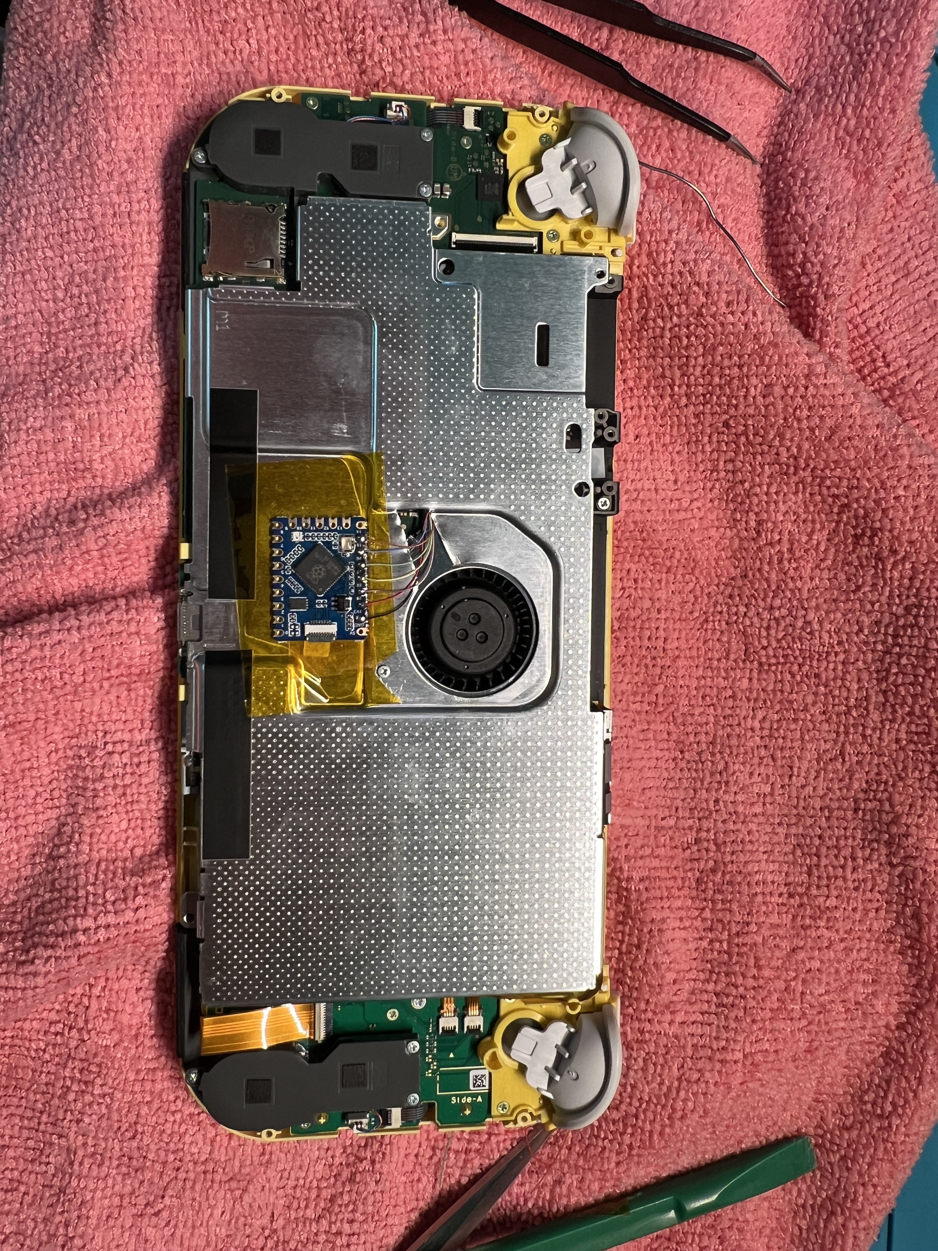

Hello All, My switch lite is not starting hekate. The picofly show an error "**= No eMMC block 1 read (should not happen)" And i am not able to find information about what is happening.
Hello all, I have a switch lite and i recently installed picofly, it was working perfectly but yersterday i found my switch with the screen off but i could still here sound when moving on the menus. Then held the power button for 20 s to restart it and it never started again.
I am not seeing hekate or anything. The picofly led signaling is fast fast slow (**= No eMMC block 1 read (should not happen))
anyone knows what could be happening?

I had the same issue twice, first time because the pico was wrapped with kapton tape and the second time because the wires were too long, I solved the second issue with sda and scl points
Why kapton was causing problems? I dont have long wires at all but some kapton on some solders to keep them in place better
Probably bad glue, which conducts a lil bit, tbh I have no idea. I know that I buy cheap stuffs from Ali, so it's better not to trust any seller
