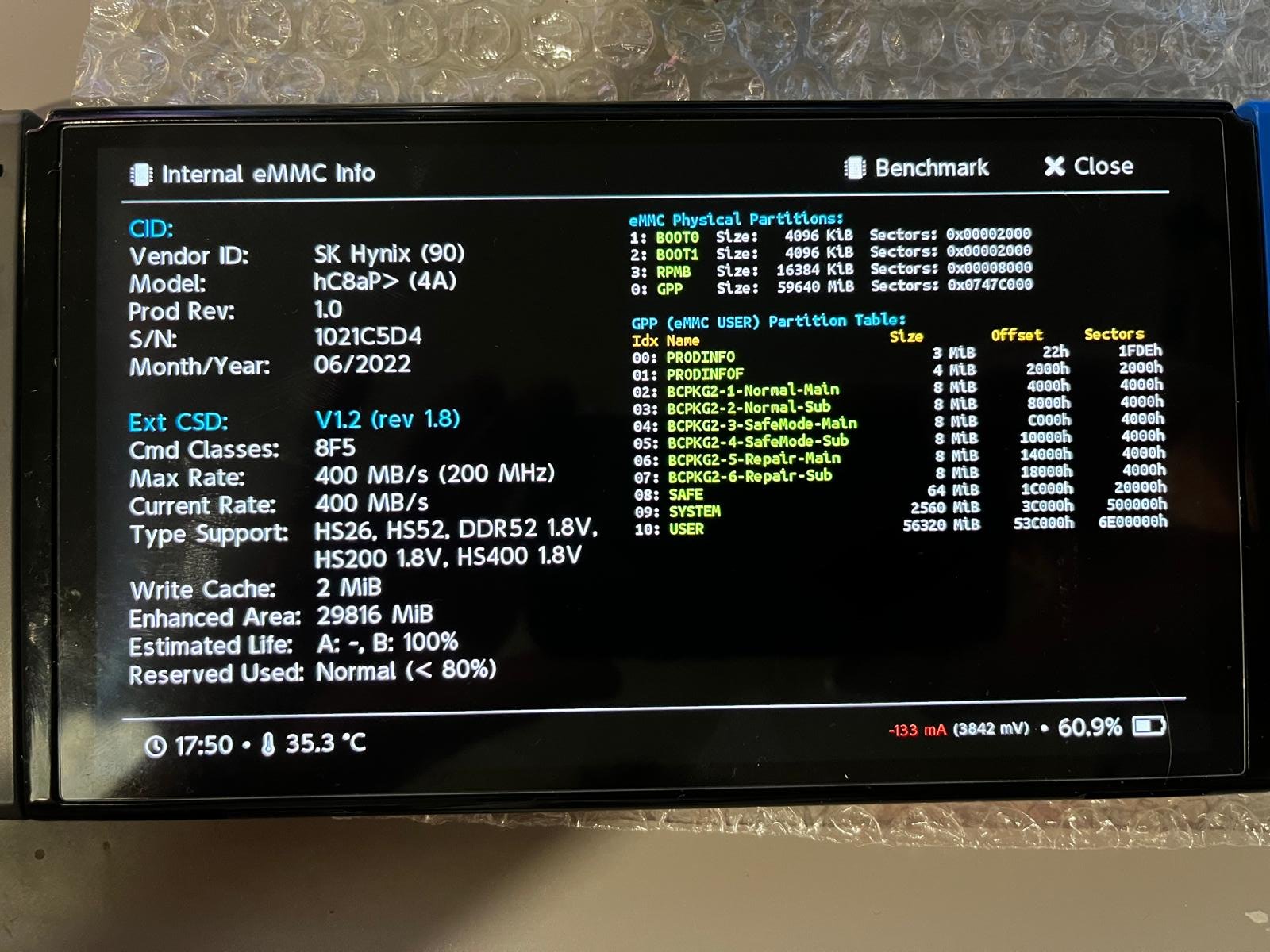

Have anyone seen the partition table like this?
Context:
- Oled using hwfly rp2040 aliexpress
- First boot hekate couldnt do backup nand, had "Partition table is empty" - purple screen ofw - creating emummc bis keys error
Did:
- Changed cmd resistors
- tried different combos of adding more resistors to dat0 / cmd
- tried and Instict Hwfly with arm cpu
Still same problem...So emummc was screwed
- NxNandManager couldn't get GPP to extract PRODINFO so I could remake nand "Input file/drive is not a valid NX Storage" error
- Fortunetly got the prodinfo with program "HacDiskMount1055" and made sthetix new level2 and fixed purple screen
- Got back to hwfly rp2040 and "Partition table is empty" happened again, had to restore again, and got stable when I put more resistance on dat0 and no more slow emmc errors
Symptoms now:
- Can get to ofw and cfw but the partition table is like I never seen before (see image).
- sometimes glitch fail "**= No eMMC block 1 read (should not happen)"
Any idea? ;)
dat0 kamikaze adapter reball?
Your photo is perfectly normal since version 6.2.0 of Hekare is shown like this

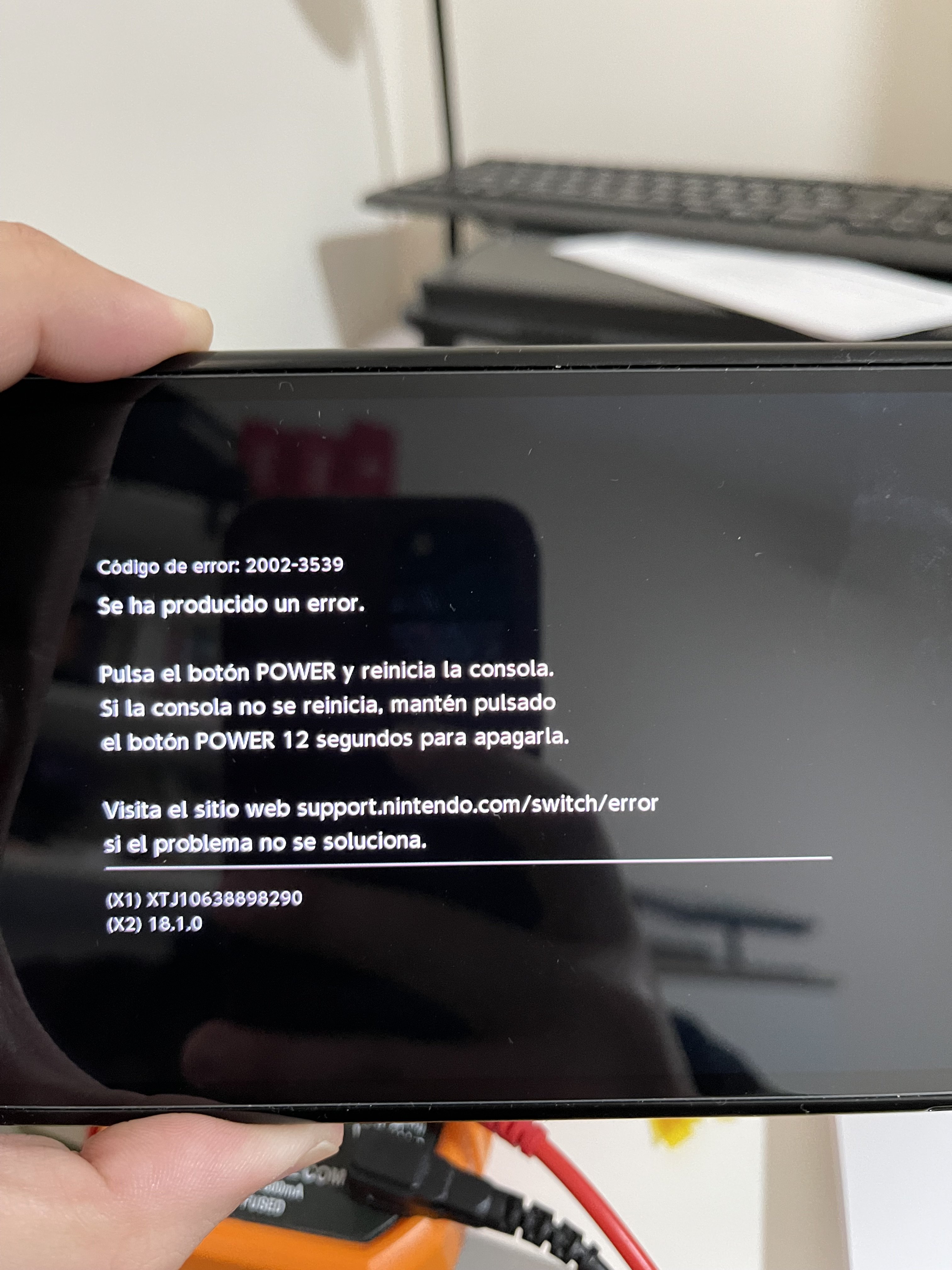

I just installed Instinct v6s on an OLED. Everything seemed to go well. I tested that the chip would turn on and do the glitch. I closed the video console, created emuNAND, installed games, and played them. Everything was working fine until I tried to access OFW. The Nintendo logo appears, and then the screen goes black. Sometimes, the error shown in the image appears if it manages to turn on.
I have changed the CMD resistor, replaced the DAT0 adapter three times, and still nothing, the issue remains. Any ideas? Everything works perfectly in CFW; the problem is with OFW.
This post from a year ago showed the same 2002-3539 error and it turned out to be the DAT0 adapter.
https://gbatemp.net/threads/oled-switch-error-2002-3539-after-hwfly-oled-v3-install.611057/

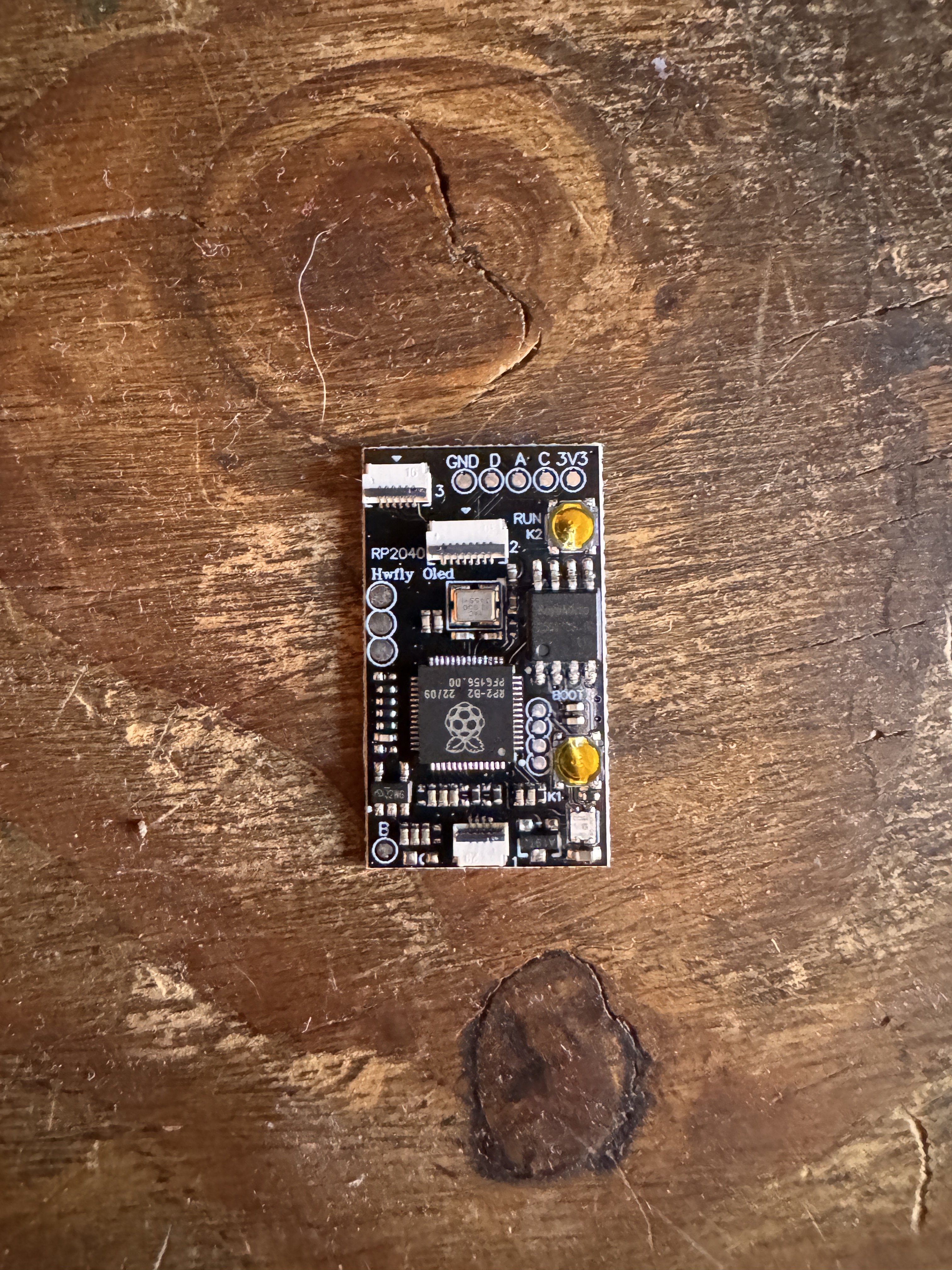

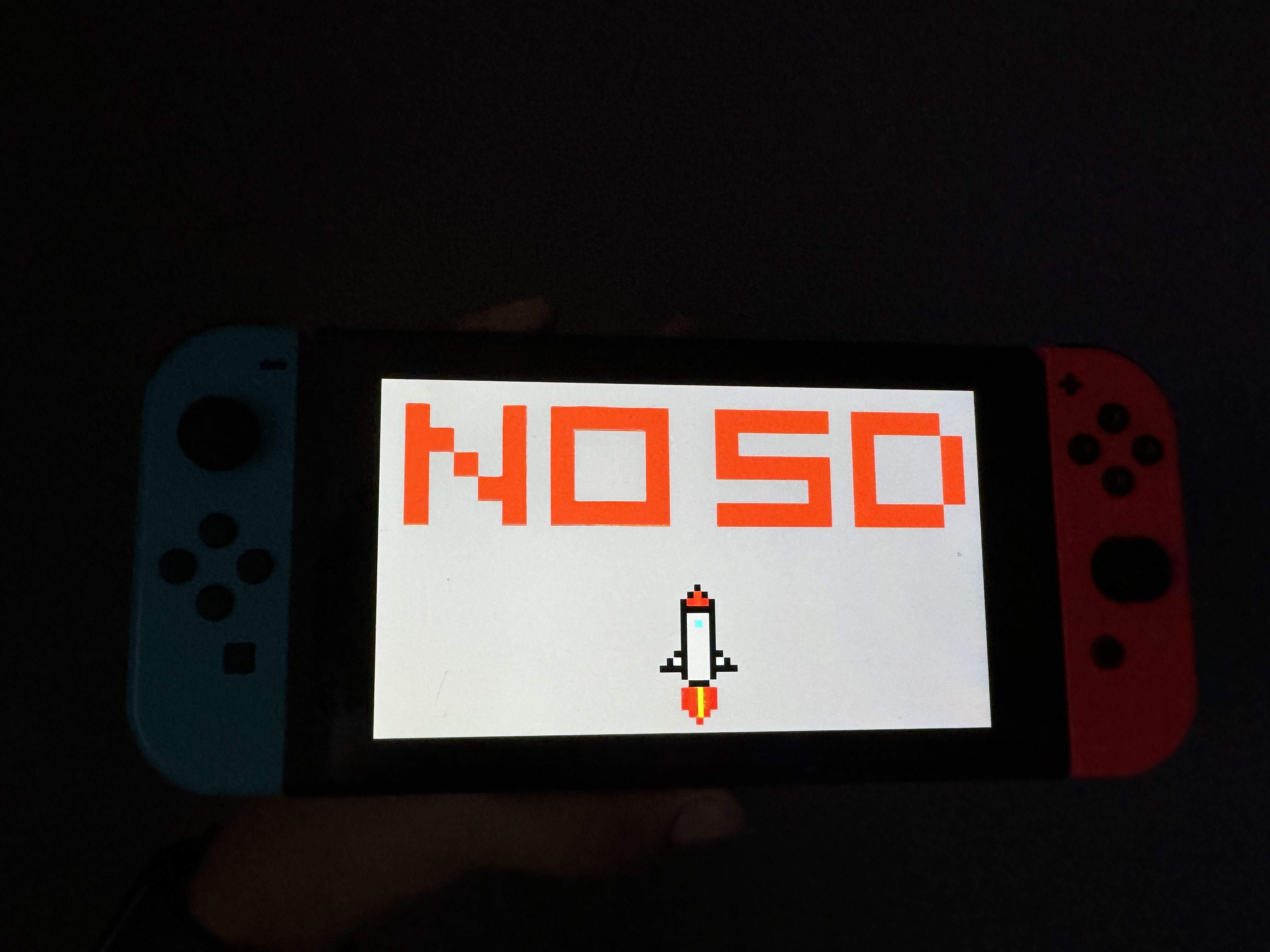

Hello friends.
Some days ago y bought this model of picofly in aliexpress. I installed some modchips but I notice that some modchips don’t work properly it fails sometimes and don’t go to OFW only black screen.
I notice that the modchip has a big strange flash memory and this only happen when I flash the modchip with any picofly firmware that don’t come with the modchip.
The chip comes with a rare combination between Spacecraft and Picofly firmware, don’t boot OFW if one point of the chip it’s not correctly connected, you cannot go to OFW in the “NO SD” screen pressing vol + and Vol -, the error code are not accurate and that I said previously the modchip don’t work properly with another picofly FW.
So mi question is: anyone know what is this? And anyone know how can a i extract the firmware from the modchip or something like that? anyone have this firmware? I flashed 2 chips but don’t work properly and I want make work the modchips again.

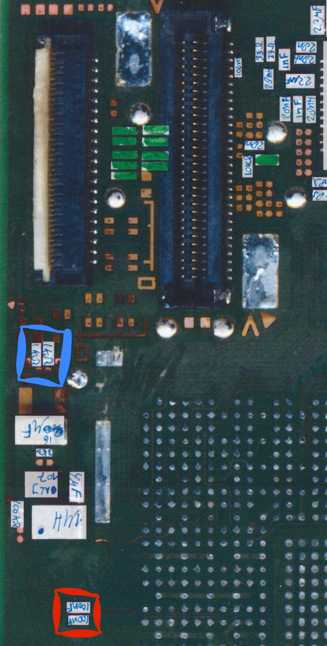

Hi!!! I have installed an Instinct v6s in a Nintendo Switch OLED using the kamikaze method. I verified that everything was working and closed the console. I configured the WiFi and started installing games. After installing more than ten games, the screen froze. I turned it off by holding down the power button for 20 seconds and then turned it back on. Upon restarting, I noticed that I had no touchscreen and network connectivity (error 2110-1118).
I opened the console and found a resistor near the display flex that was out of specs (blue group in photo). I replaced it with a new one and restored the touchscreen functionality, but I still can't get the WiFi to work. What could have caused both functions to fail simultaneously? What should I check? The two capacitors to the left of the CPU shield have correct values (red group in photo).
Thank you very much in advance!!
Yes, if those 2 caps are damaged/missing/broken then Wifi will not be working.
https://gbatemp.net/threads/no-wifi-after-hwfly.625830/
A long time ago someone mentioned that he messed up Wifi because he damaged some traces when removing the shielding.
In his case the caps were still present/working.
