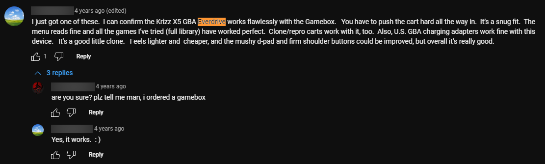

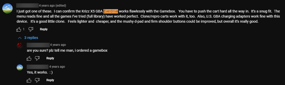

I've been using my EXEQ Gamebox SP for quite some time already and I'm already hooked since it's compatible with other flash carts.
However, what struck me as odd here is this flash cartridge does not boot on clone consoles.
There are reports of the Everdrive X5 mini and the SuperCard CF/SD working on this clone handheld console.
