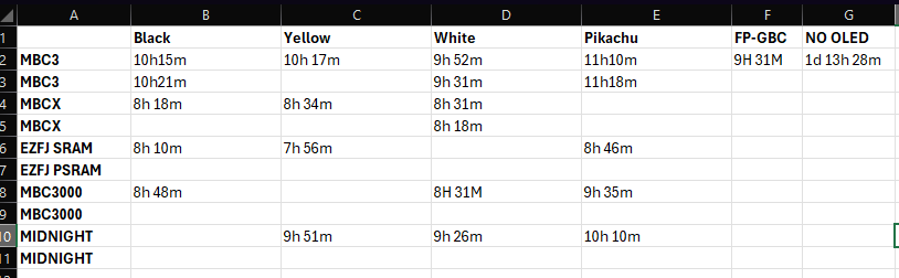

almost the same battery drain as a standard DIY MBC3 cartridge and is much cheaper
About 20% more drain, apparently. A DIY MBC3 (or MBC30) doesn't have an Altera to power, but it's not as cheap because you need to source donor carts and compatible flash ROM ICs (getting harder to find).

yeah, you are right I did testing of it myself some time ago.
made my own rom to test it also https://dgc1980.itch.io/gb-battery
lol that is actually my github reply :)

The sram is the official version, and the psram is the modified power sucking version, right? So the parameters only goes down in terms of battery life? I want to be sure of what I’m reading when it comes to the Ezfj. I need an rtc cart. That was the best one?
