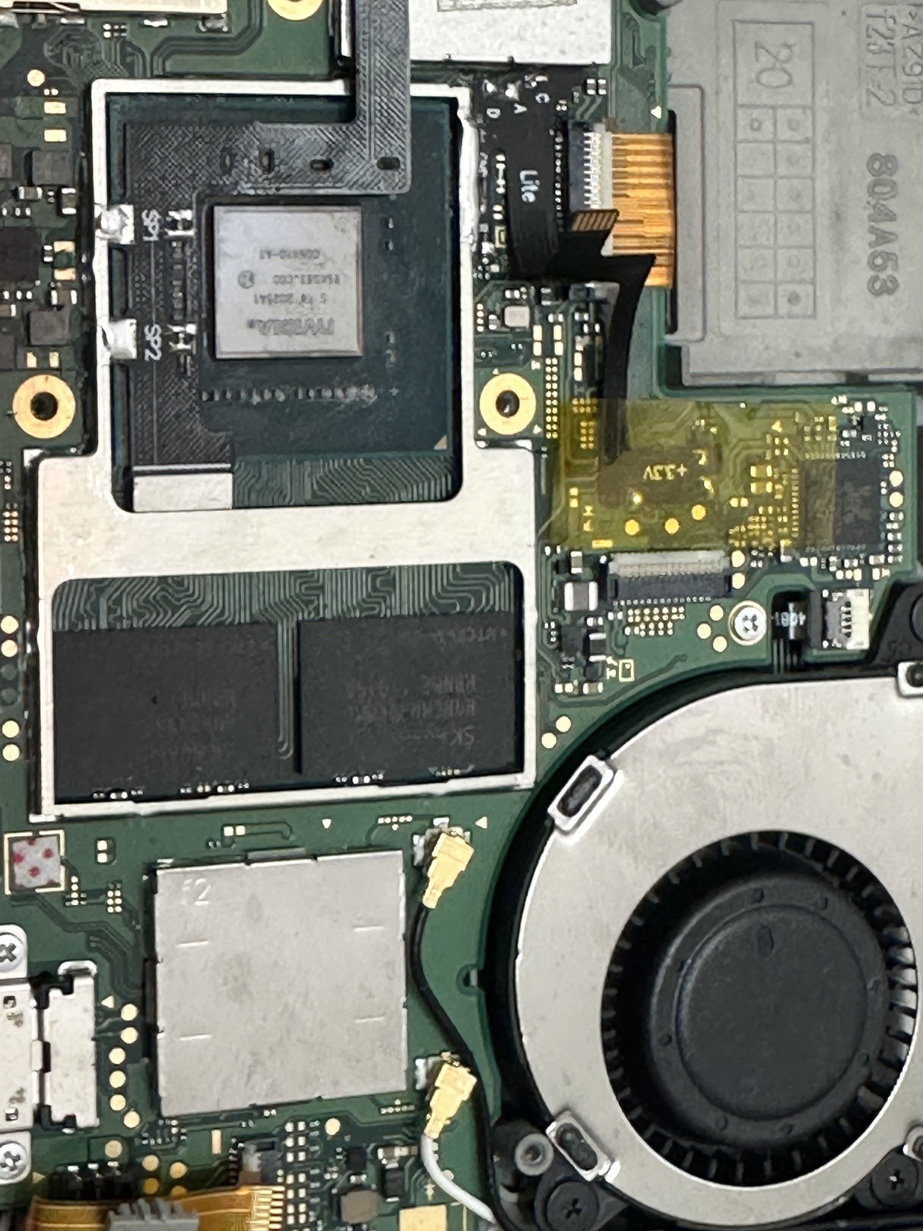

I will buy a new board for the switch. Should I also buy a new Chip? I’m afraid of soldering the one in that I have…
This was my install btw. on the now defective unit
Thats up to u what u do new or old chip, If it was me I would install a tiny/zero
If ums works u most likely have a issue with the ram since ums loader runs on iram
Okay thank you I will look up into it. Maybe I’m buying a HWFLY because I’m a bit scared of Picofly now

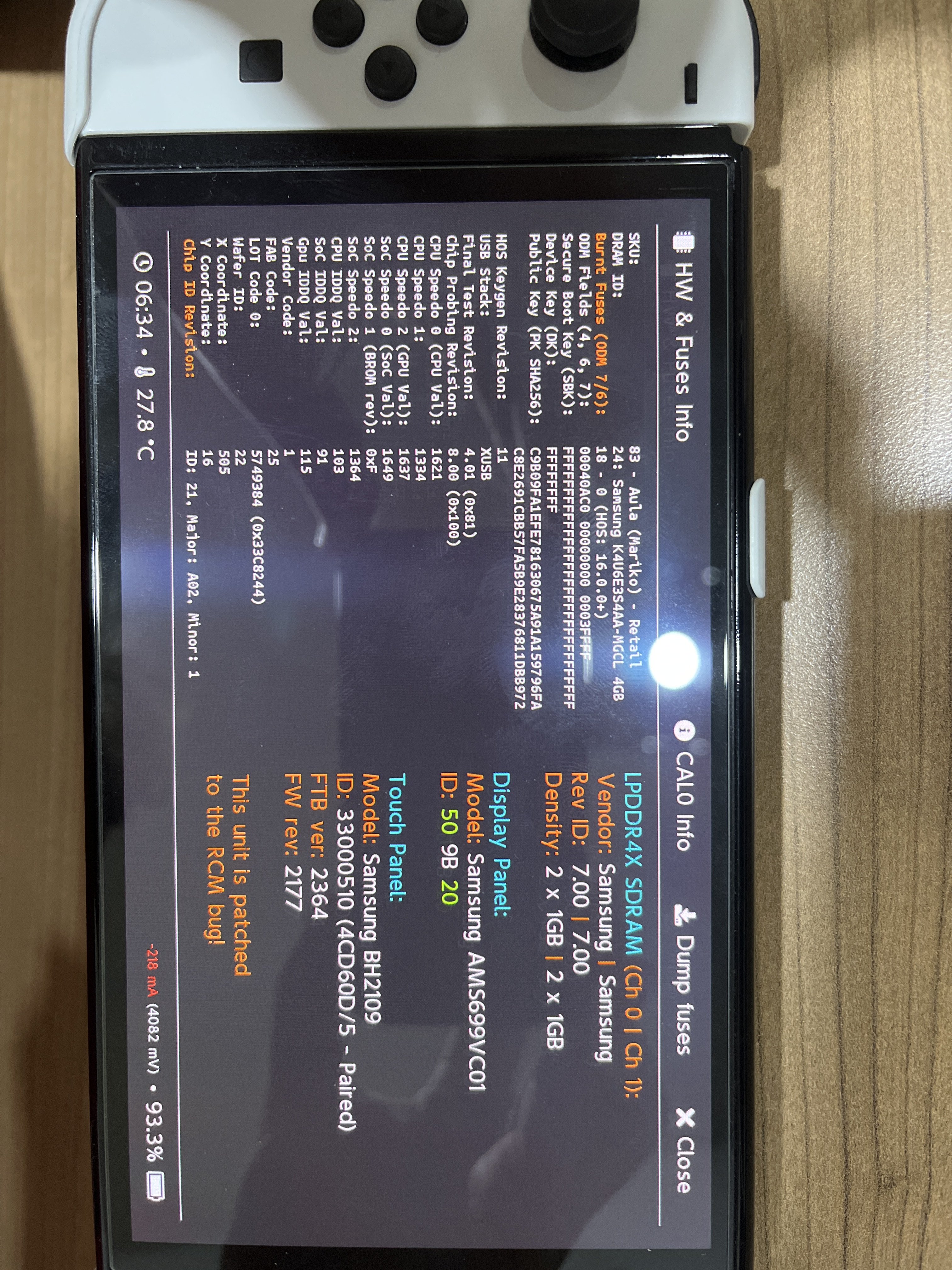

Hello dears,
i just modded the switch oled, first thing is i created backups of the eMMC GPP and BOOT0 & BOOT1 from Hekate, then i partioned the SD and made an emuMMc.
i did not try launching CFW from EMUMMC or SYSMMC or even run the OFW
then i used lockpick and dumped SysNand and amiibo keys, and mariko partials, then rebooted.
i got Pkg1 decryption failed! Is BEK missing while launching, then i powered off and powered on
then i tried launching the CFW from emuMMC and it launches fine and i can get to home screen
but entering CFW from SysMMC results in an error page 2002-3539
and restarting Normally into OFW will Stuck on just the LOGO with Joycons.
i am not sure as why this is happening, i read that systemwipe will fix the issue, other places saying Dat0 issue, sthetix mentioned that use better wires as he got the same error because of bad wire from dat0 (although my EMMC info page looks fine)
UPDATE: Okay, i just had some luck, so i found a twitter post of sthetix saying that using FPCB causes interferences from D point, and is better to use fly wires instead, i soldered a fly cable above the D point to the picofly board, and low and behold i can enter CFW sysnand from hekate just fine, but still OFW is not working, i am still stuck on The logo with joycons.
TL,DR: I cant enter OFW, stuck at logo with joycons. sysnand works fine after resoldering a fly wire to D point, emunand is fine from beginning.
Any advise on why this is happening and what to do?

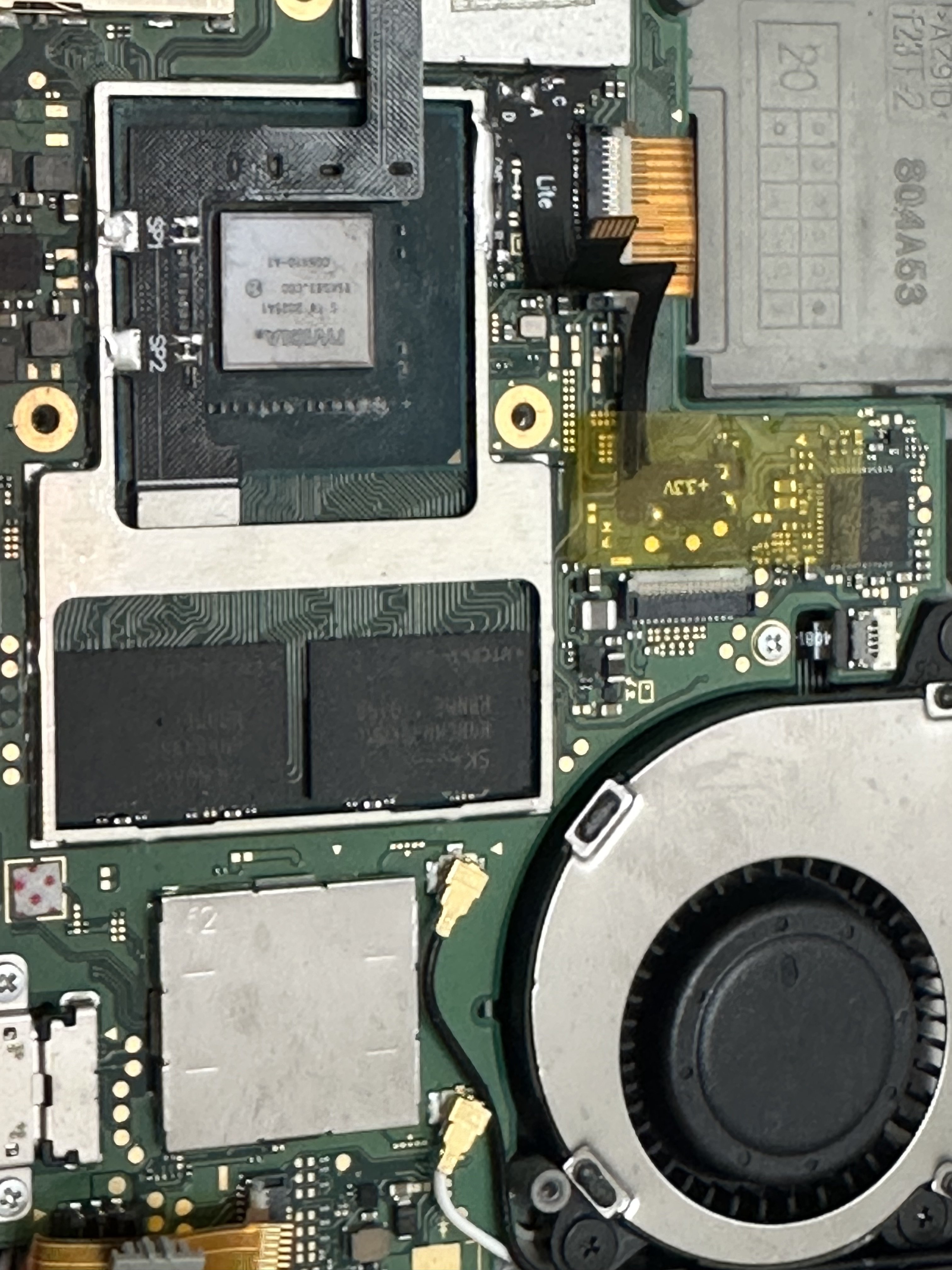

Hi !!!
I make a pico on my Oled and i have this error "** RST is not connected"
the point is connected but when i plug the bateri, my console starts automatically :(
I dont know why... I unsoldered all the wires but I still get the same error
I change the 3.3v and it work !!!

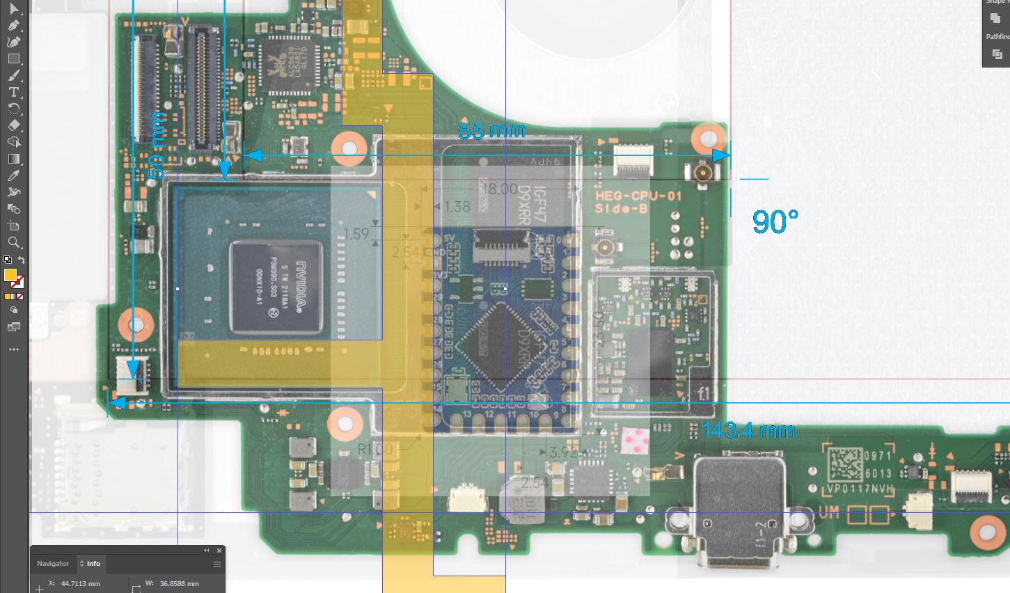

Teaser of my next project, I call it Project McFlex eliminating the need of jump wires.
Why not connect the flex cable to the capacitors on the back of the motherboard?
Those caps are so big that even with my dollar-shop soldering iron I could safely connect a flex cable to them.

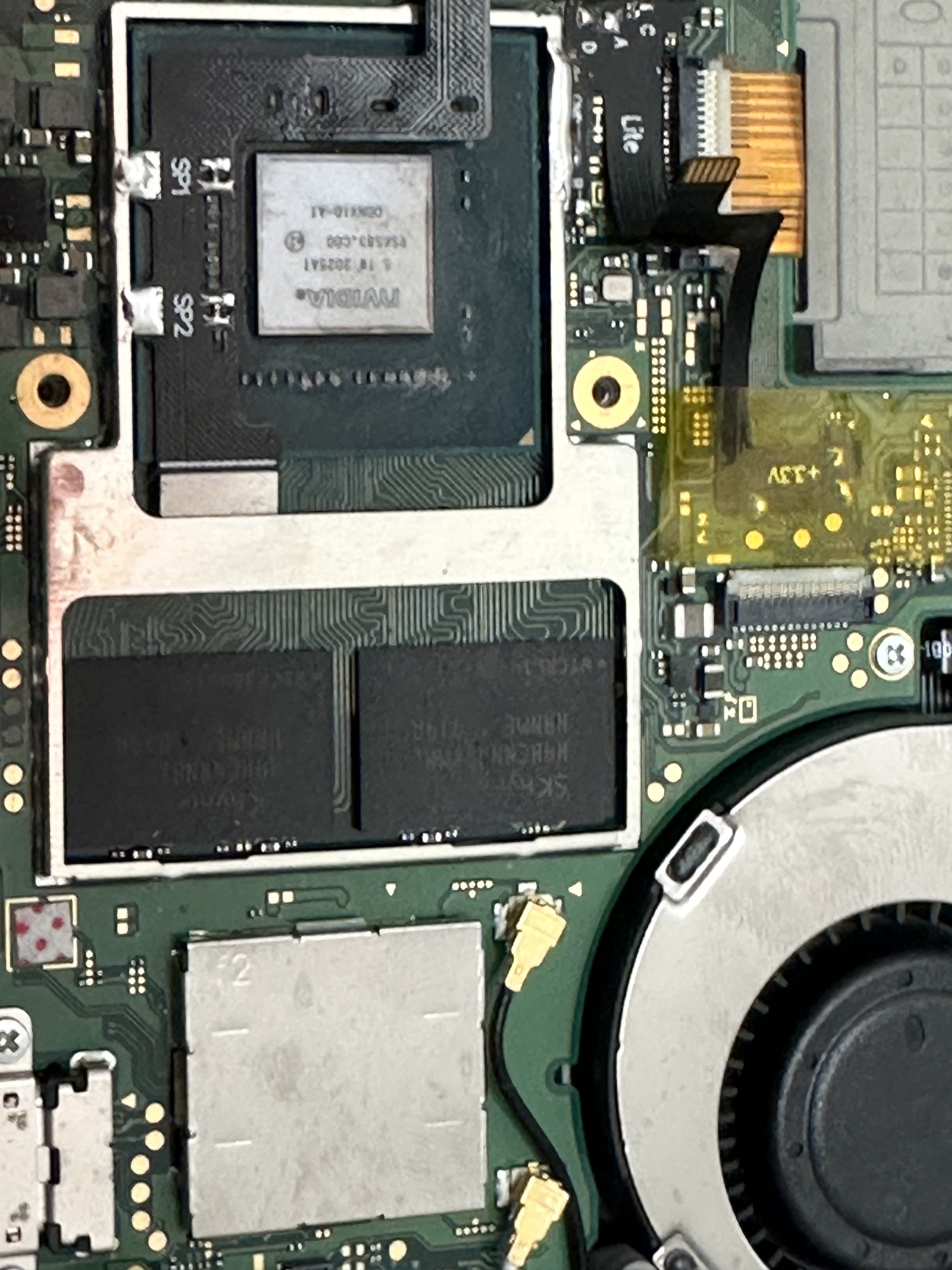

So I think mine is gone if I have no backups of anything. Could it also be the Picofly firmware that f upd the mainboard?
I got a new switch lite should I use the same HWFLY Lite RP2040 again? It glitched fine to the Picofly screen. I’m a bit scared of using it again… but I don’t want to buy a new one because it takes so long to arrive. Also is the new Picofly firmware good 2.75? Or should I use the 2.73?
