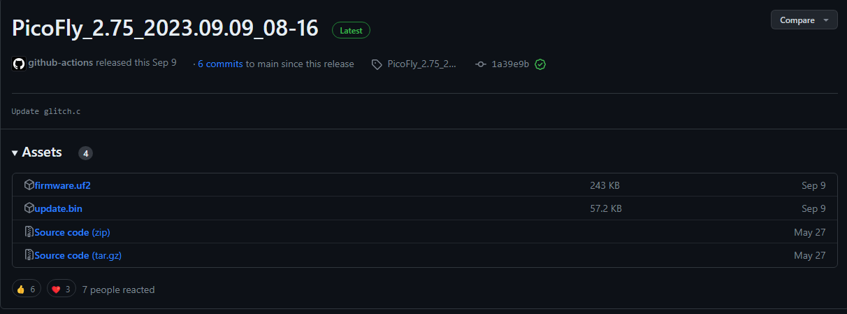

If its easy for you to update the firmware, try the latest firmware available (2.75)
Theres issue on powering down the picofly, that has been fixed.
Or you could try my custom firmware, i have different opinion on the picofly sram power down mechanism. Might be correct, might be not. Risk on your own.
what is the risk? software or hardware? Where can i find 2.75? On rehius github? Will 2.75 also work on rp 2040 board zero since its the same chip?
