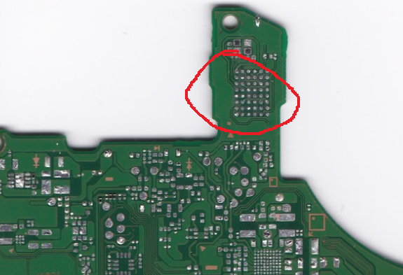

Hello friend, I know this question don’t have see too much with RP2040 but i want to ask
Why I need move to do a correct motherboard swap?
I have a good OLED motherboard but not working NAND (I bought with that problem already) and I have a good OLED nand, CPU and Ram but faulty motherboard. So I want to do a mb swap, I know that it can do but I don’t know what ICs I need move to the other MB and make it work

you need 1 more chip ,the chip that reads cartridges for digital signatures?. From what i remember this one is also tied to emmc cpu. you can find it here. if im wrong please correct me

hello, you only need to move the cpu and the nand, the ram is not linked.
This chip is tied to the second SDMMC port of the Tegra cpu but not to the emmc port to which the NAND flash chip is connected. Likely they use the same power rails.
Afaik, in the initial boot process, nothing checks the existance of this chip so you should be able to boot into Hekate or something.
When the Switch boots then it uploads an encrypted firmware to this chip in order to be able to access cartridges.
It does this every time it boots, even when no cartridge is installed.
So I don't know what will happen if it's physically not there.
This chip does not have any console specific signatures but it does hold some version number.
Each firmware has a minimum required cartridge reader version number and if they don't math you just can't read cartridges.
For fixing that you either use a newer firmware (if the cart reader firmware is too new) or allow Hekate with a certain setting to update the version of this chip. But that is just something minor that can be fixed.

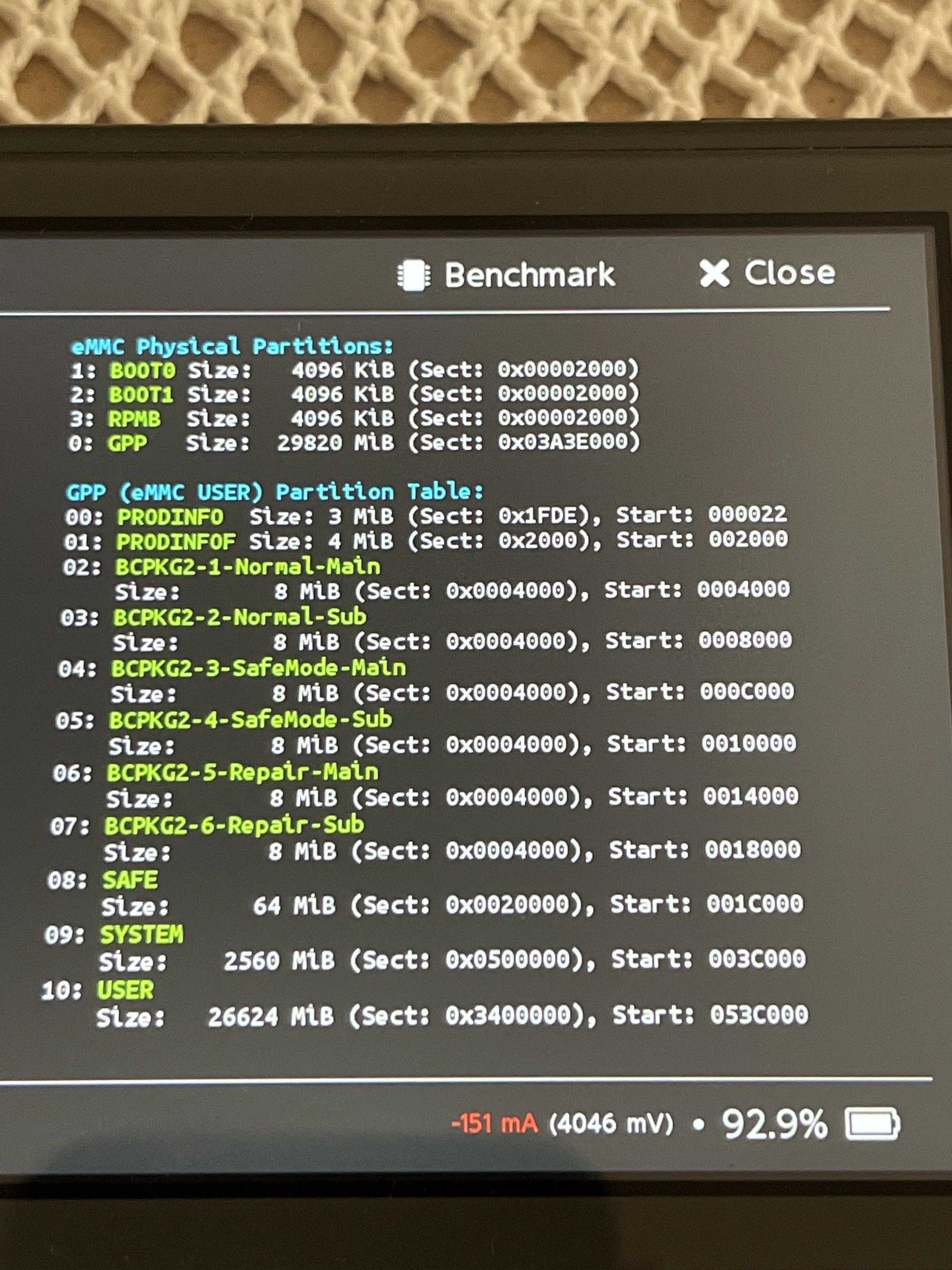

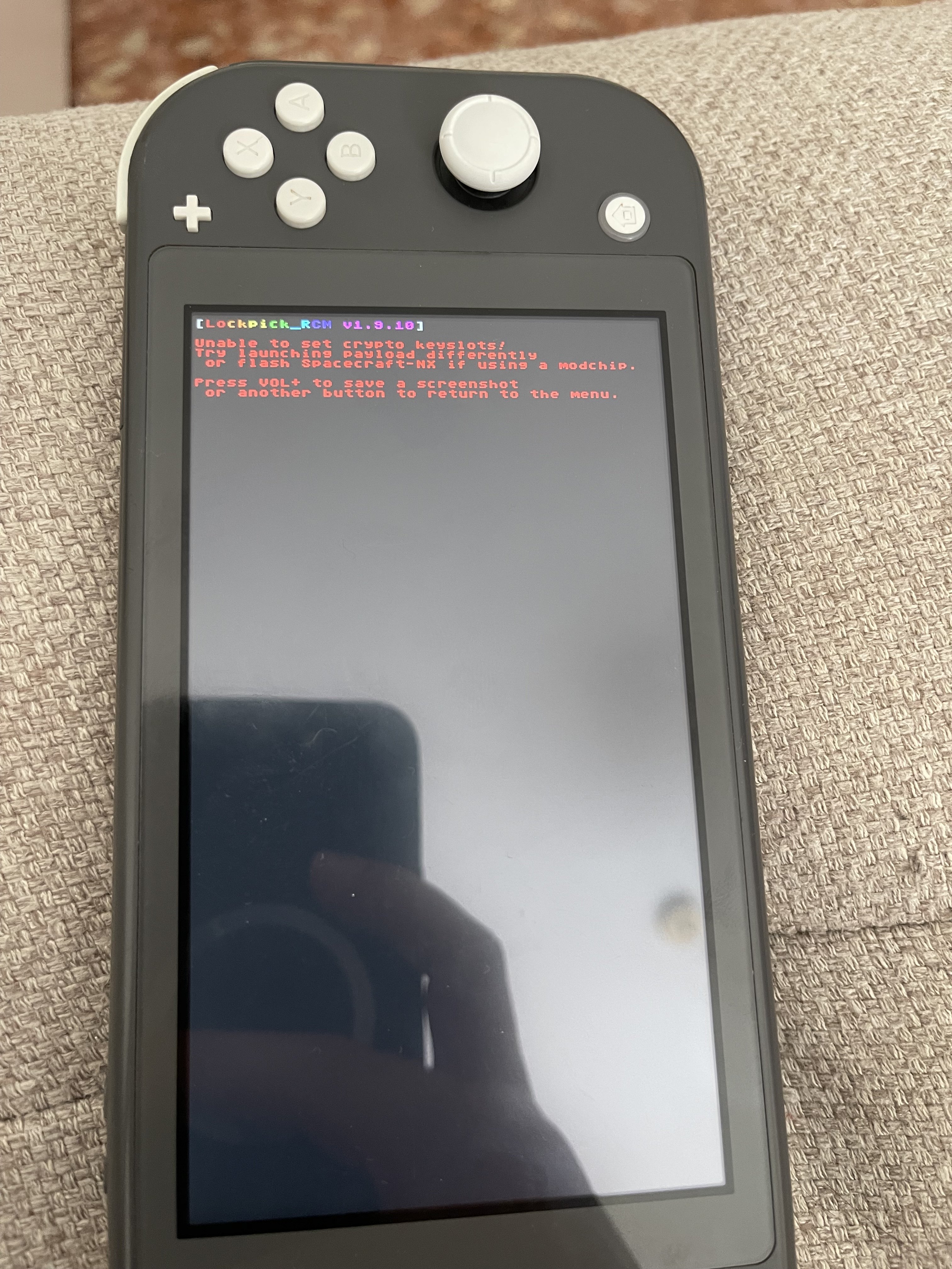

Hi! I have bought a Nintendo switch lite with rp2040-lite modchip installed (using the flex cables). It start in hekate but I can’t start emummc or ofw, I get a “pkg1 decryption failed. bek is missing” error. Any idea of how could I get the console back? I haven’t backup. I have tried a tutorial of unbrick a console but I get this attached error when I try it.
Thanks!
Thanks!

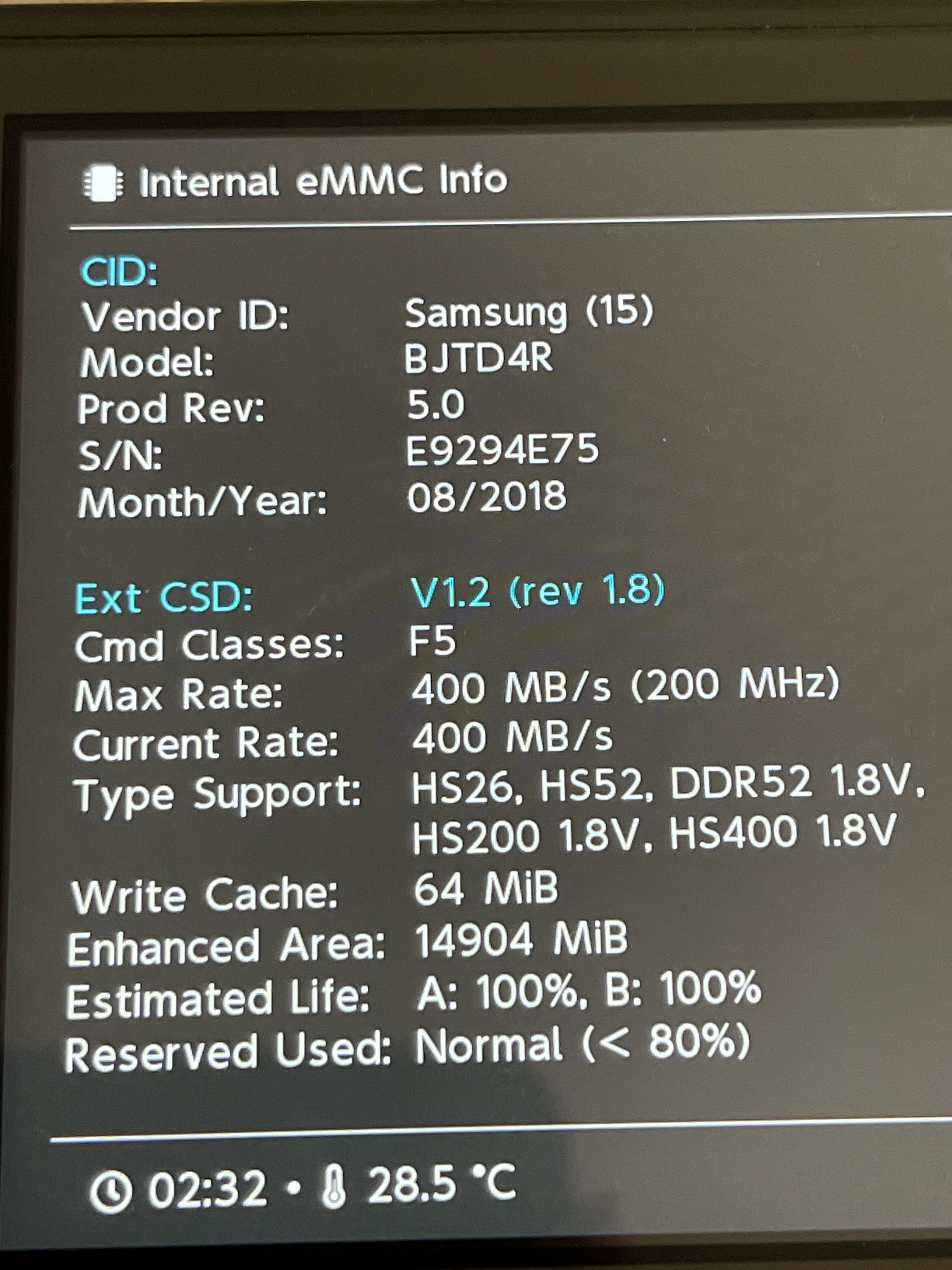

if you go to the console info section --> eMMC send us screen?
Thanks!
That looks like the error from the first version of rp2040 firmware when it only supported linux/android. That means keys are missing or being cleared. I dont know if your lite is a true rp2040 which you can update, or a hwfly clone which you should contact the seller and see if it can be updated.
