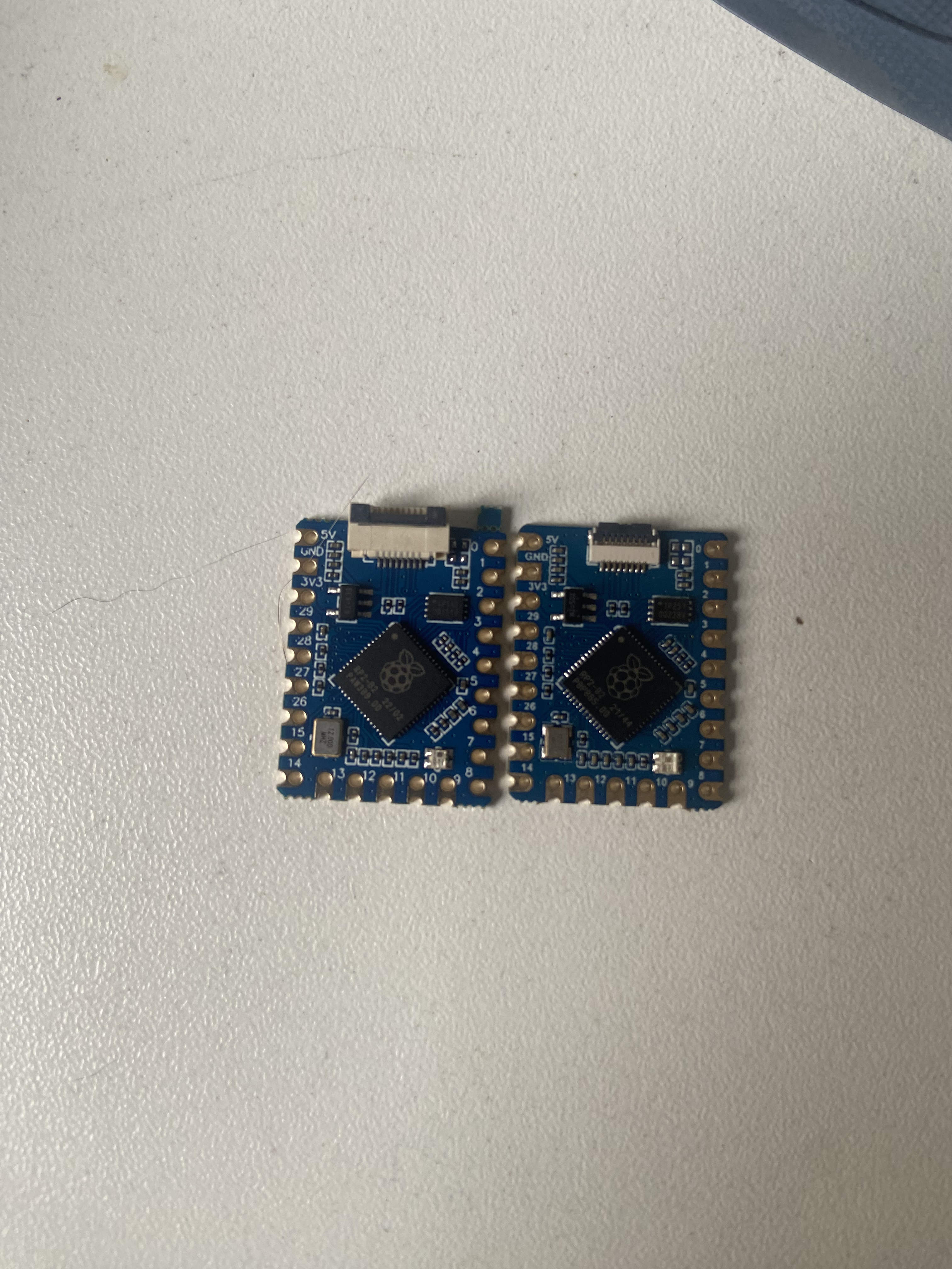

Anyone can help me with this fake/clone rp2040 tiny? the LED do not work. firm 2.3
Clone boards are almost never checked when they are shipped out in order to save money so you're likely get a faulty or burned component. The QC is passed on to you.
If you want to avoid such predicament only use authentic boards from the source.
These clones of the rp2040 tiny are everywhere, I bought several like this without knowing, in different purchases.
Apparently they only got the pins wrong to activate the LEDS. I don't know how to fix this somehow because lids are very important to help find errors in unlocking.
This code was sent by one of the sellers to show that the LED works (he changed the LED pins), were we able to make a correction for this? I suggest using the jumpers present on pins 24 and 25 on the board to signal that it is a fake board and you should use another LED pin if these points are soldered:

well if u know what pin the led is connected to atm and wich on it needs to be then disconnect it from wrong pin and solder a wire to the correct pin.
if u buy from a proper selling then u wont get fake chips.
if u buy because its a few cents cheaper and get a fake chip thats up to you.
u can order from waveshare direkt and then u will get the correct zero.

What I've been doing is initially flashing to v2.67 to get the led back. Then once confirmed the install is good, update via pico toolbox to v2.75.

você pode fazer o pedido diretamente no Waveshark e obterá o zero correto.
do you have the direct link of Waveshark? i cant find
i want to recompile to solve it. but i dont know how i can do it, im trying to clone the repository in the PIO
