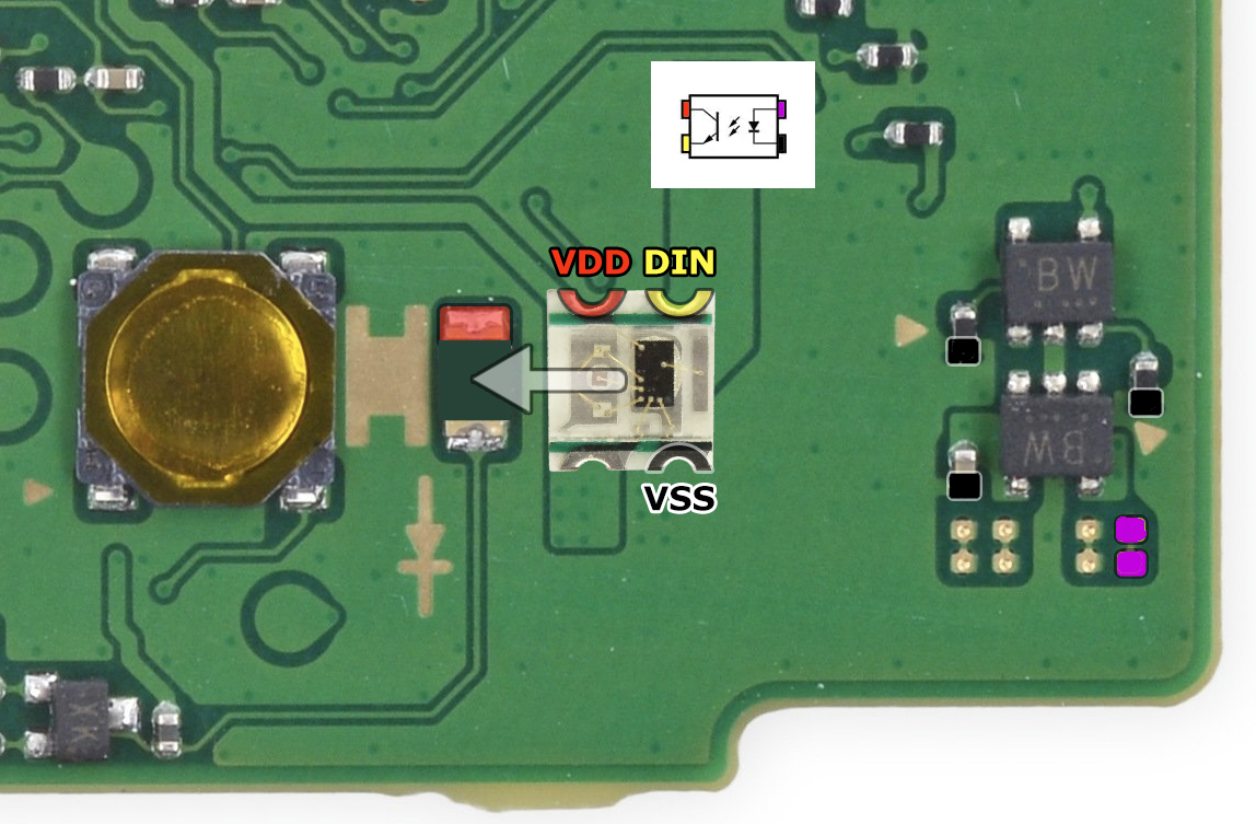

@QuiTim @jkyoho thank you for your patience; here is the diagram for how I attached the status LED to the joy-con PCB. I removed the original home button LED in my installation, though it may be possible to mount the status LED directly next to the original, as the LED used on the RP2040 zero is smaller than the one on my seeed xiao RP2040. I also cut a hole in the rubber membrane between the button and the motherboard, to accommodate the LED and make certain the button could depress properly.
DIN point on the RP2040-Zero:
points to connect the LED DIN line from the RP2040 to the joy-con rail ribbon connector (first is v1/v2, second is oled):
View attachment 380939View attachment 380936
edit: while I have the photoshop file open, here is a diagram for how I wired my lite install as well. this one is far more practical and I have seen a couple other people do it since my first post, so it would be fun to see more home button lights moving forward
optocoupler??
VDD comes from the Joycon battery and DIN comes from the CORE/OLED battery, maybe the conflict comes from there

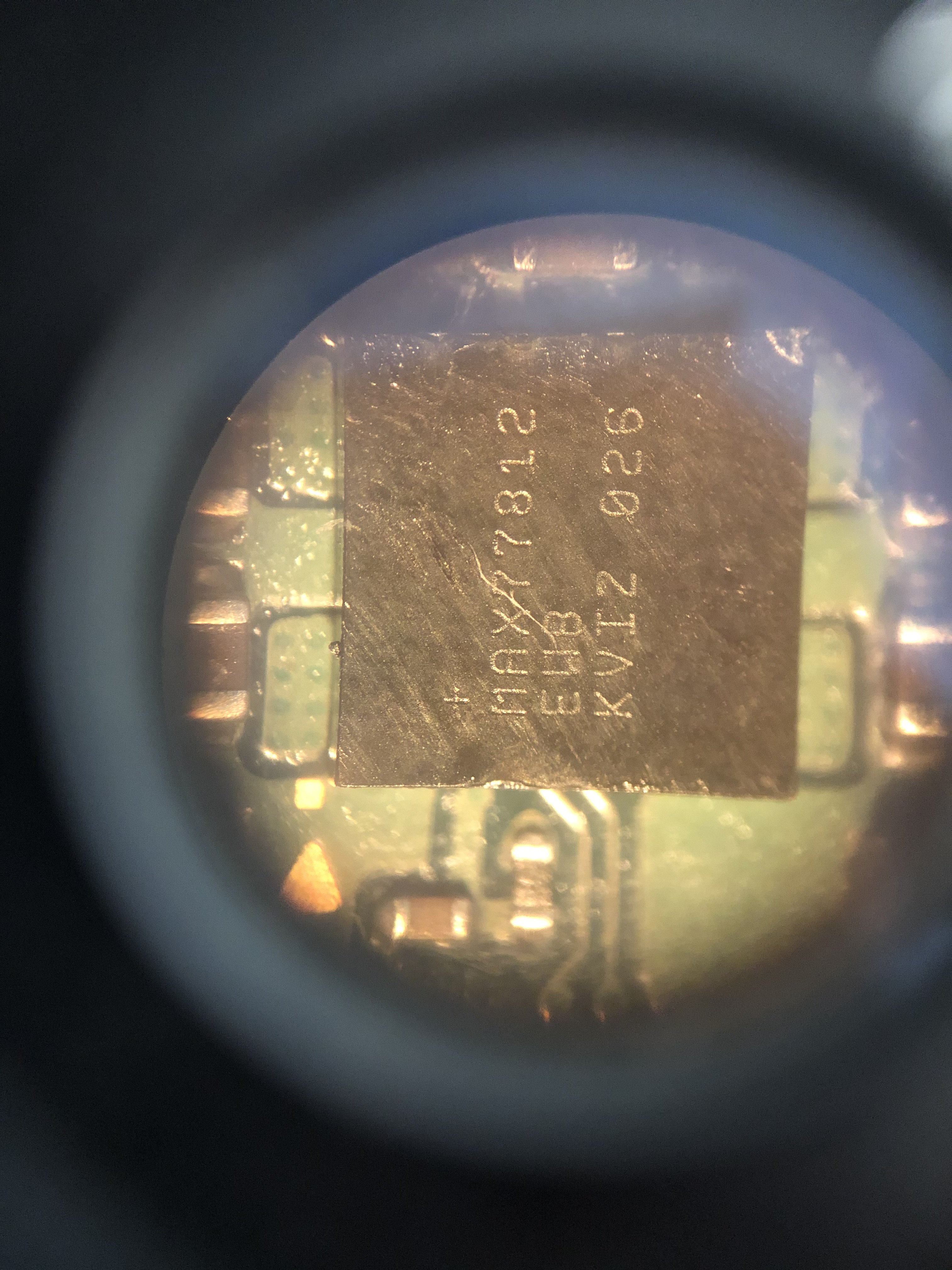

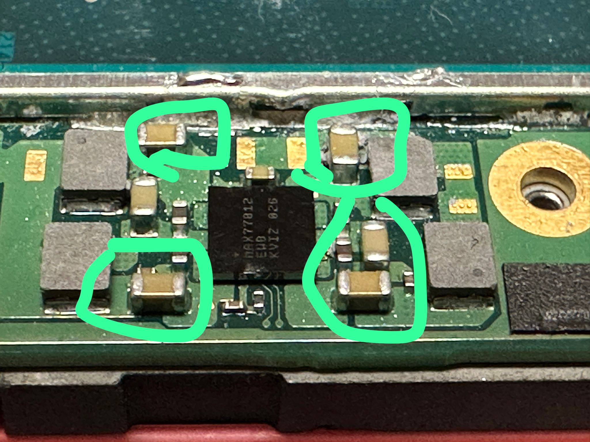

Today i soldered my PicoFly Lite RP2040 from Aliexpress (its shaped like the SX lite or HWFly lite)
I double checked all the values with the multimeter and all seemed good i tested it and it booted to NO SD Picofly Splash.
Then i putted a Micro SD with Hekate into the switch but nothing just Blackscreen. But still without the SD Card i got the Picofly NO SD. I unplugged the Modchip and got a Blue Screen... Then i unsoldered all the Flexcables and now im still having the Bluescreen. Ive read it could be a corrupt Boot1/Boot0. The Switch worked fine before the install attempt. I dont know what i can do now.
I checked the Caps around the MAX77812
and they are all shorted I took a photo of it
Is the MAX77812 chip fried?
But this chip is from my understanding for power regulation and shouldn’t give a Blue Screen. I think the Blue screen has something to do with nand, because the console outputs the PicoFly no Sd screen without problems. I’m not the only one with exact the same issue has no one an idea or ever fixed such a console I sent so much money….
Before diving into anything share measurements with us. Those capacitors are connected to low resistance path, make diode measurement around it and share. Blue screen means lots of things share detailed photos of your install.

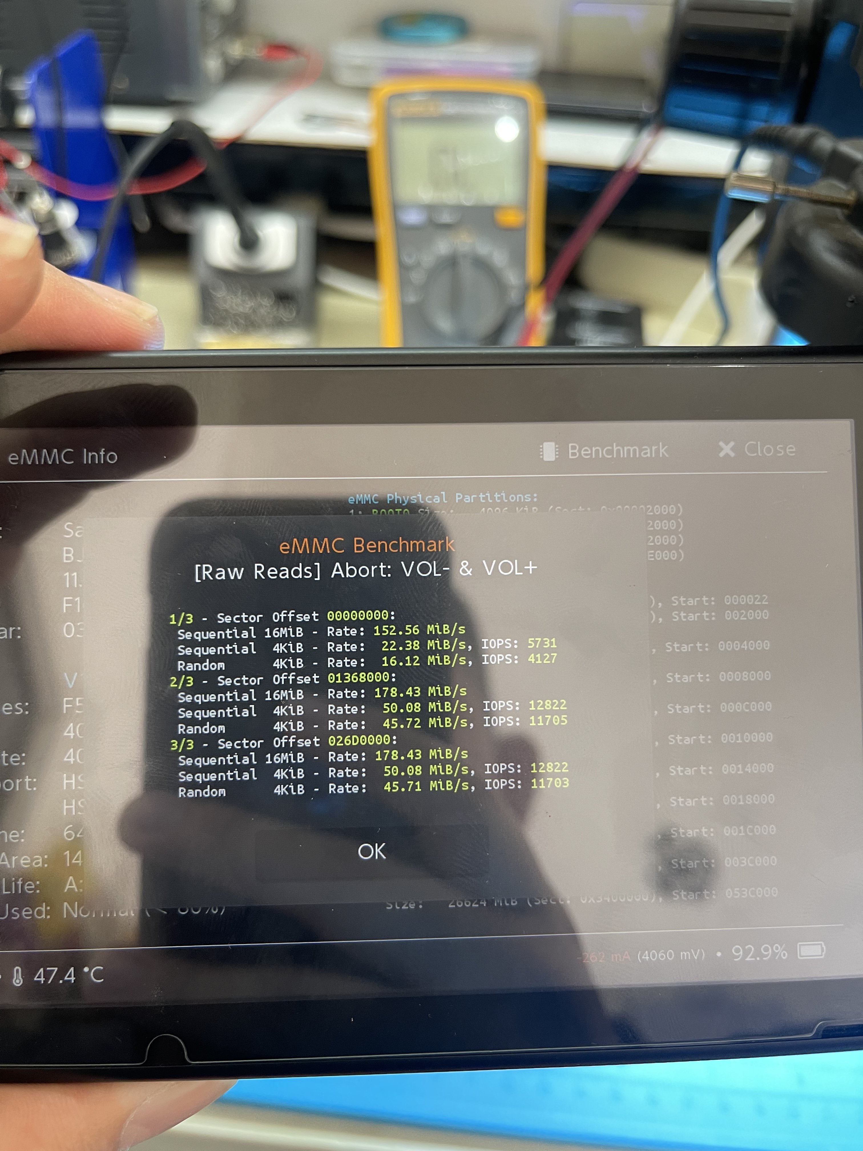

I got emmc running slow on v1 unpatch erista
I double check all my solder
Its all okay
Do i need add more 47ohm resistor di cmd, clk, dat0?

well ur fucked , that switch can go to the donor selection.
the max is not fried,replace it and u will see
the issue with no sd screen working but if u insert sdcard u get a black screen.
i bet with u if u put the Ums Loader on the Sdcard and rename it as payload.bin ur gonna be able to boot the ums loader.
ClickMeForUmsLoader
Now this is the fourth or fifth time i heard this happen and all have installed some kind of Hwfly chip or ali board .(im not saying Hwfly is Bad Just putting it out there)
Ive had a Oled with the same issue (no BlueScreen) the guy who sent it to me tried to install a Hwfly Chip and had that issue.
ive tried everything to get that thing runing but it was a wast of time and so have the others with the issue all ended up as a donoar board.
so Lucky u now have a free Donor Board Xd

Nice to hear …. 12 Dollar cheap shit chip… my soldering was pretty good all the connections were tested and still got this error…. Nice
Couldn’t it be the cheap i used a screwdriver to lift the cpu heat shield and maybe I damaged the chip with the screwdriver
install ums loader on the sd card an load it , u will see its gonna boot.
its hard to tell about the max chip but i dont think its the problem .
when i went on issue searching someone told me its the max i changed it , still didnt work .
like i said use the ums loader an u will see its gonna boot .
if not give the chip a try but im gonna say its gone .
if its ur fault or the chips i cant tell.
i installed over 150 Og picoflys and never had a issue

So we can’t determine if it is an hardware or software issue? Can the nand still be dumped? I uninstalled the chip so I can’t use the ums loader
its gonna be a hardwar issue most likley ram issue.
like i said i tried everythign even swapped the emmc with a known good one and nothing helped.
well reinstall the chip shouldnt take that long atleast u know if the ums work or not.
Reactions: Marax
You mean the Rp2040 Aliexpress Clone Fried the Ram?
I will install the Chip if i have the time
well its hard to say if it was the hwfly/rp2040 or ur install , like i said i heard from a few people who have installed a hwfly/rp2040 and it did something to the ram (thats how far i found my issue).
now if it was the installer or the firmware thats on the chip who Knows , a way to find that out is to take that excakt same chip and give it to a installer if he wants to test the chip and see if it fries his.
then u know if it was u or the chip Firmware
