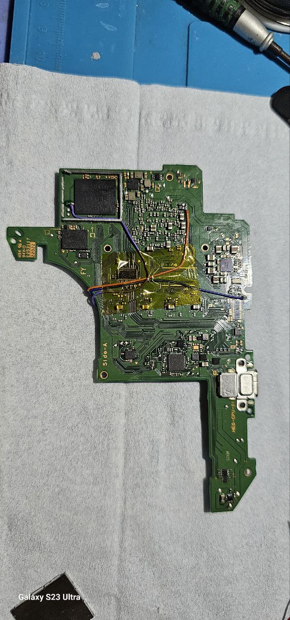

Edit: Tried again using alternate solder points, same error. I must be making some stupid mistake. (2nd photo is mirrored. The gate is soldered correctly)

Here you've connected Gate wire to Source of the MOSFET, it should be the opposite pin.
EDIT: nevermind.
Personally I got working the single MOSFET setup only once in 3 times that I tried it on different consoles. I'm sticking to the double SoC cap MOSFET nowadays. I suggest you to try that next time.

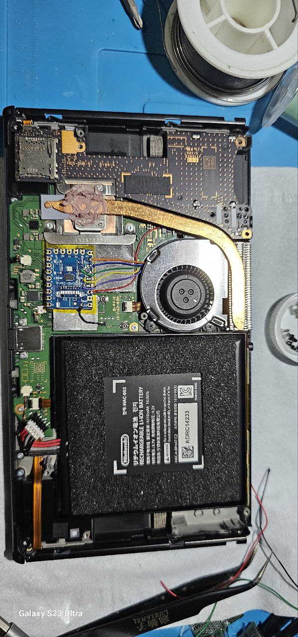

I fix nintendo switch v1 that was not boot and add pic fly chip install. When try go to hekate press power it upper msg pico fly say.. Field to init sd card. How can boot ofw.??? Need more resistor?
EDIT: nevermind.
It really is weird that many report a failure to glitch in a one-MOSFET setup. I've stopped using two MOSFETs since 20ish OLEDS ago. It's particularly strange because your last pic shows meticulous work and a great solder amount. I can only think of Solder wire conductivity as the reason for this (according to @abal1000x theory). What solder wire are you using?

Once the modchip is installed, everything goes under the management of the same, even the original firmware. You definitely have a problem on the microSD socket. At this point I think either solve the problem on the socked or disassemble the modchip to restart the original console.
My friend, I don't have any installation problem. I don't have an SD card at the moment. I bought 5 units, but they haven't arrived yet. I entered OFW without an SD card just to test the components, joycons, wifi, bluetooth and see if everything was working.

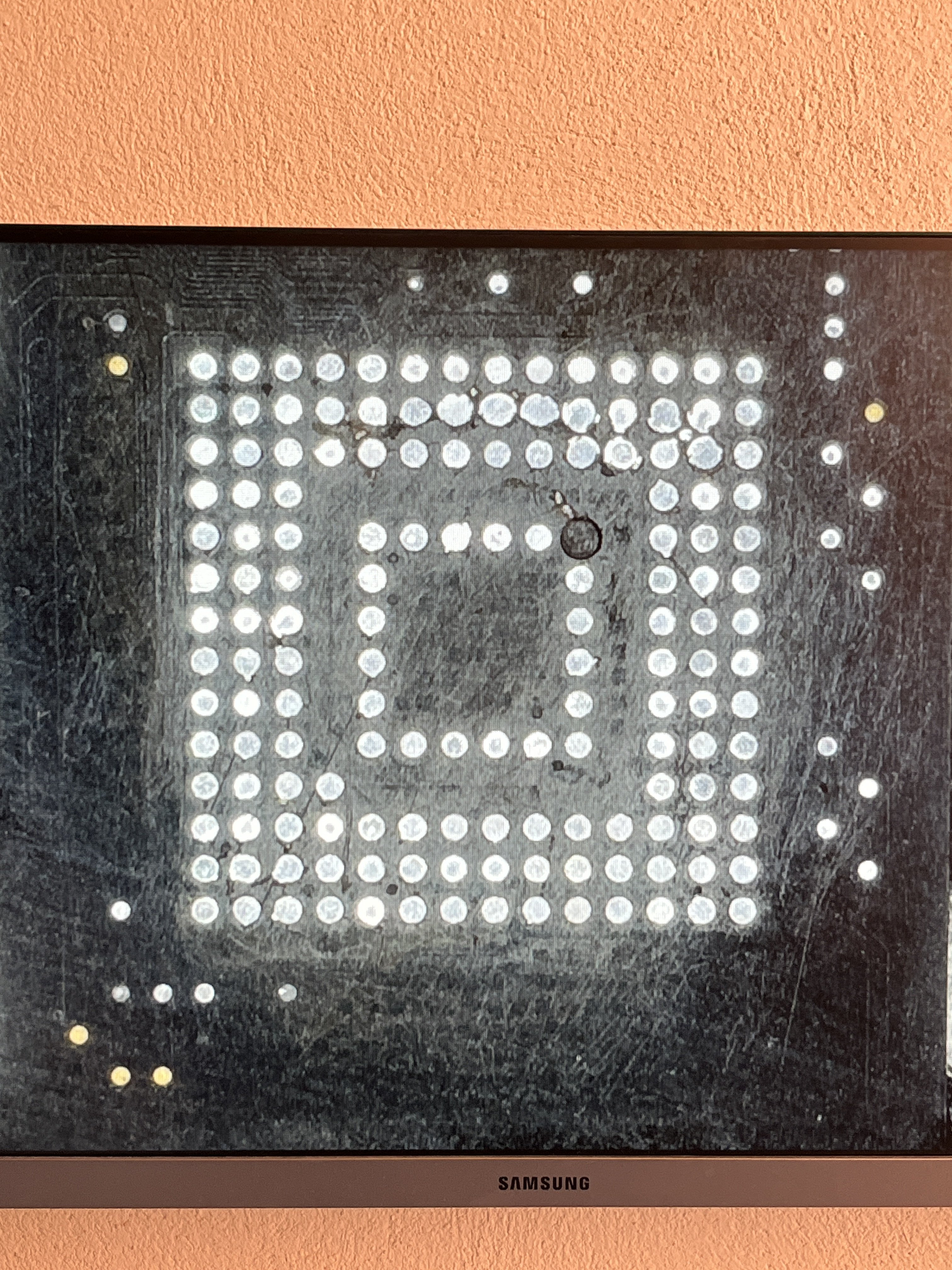

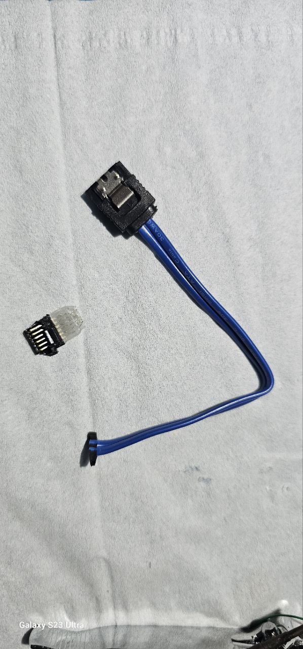

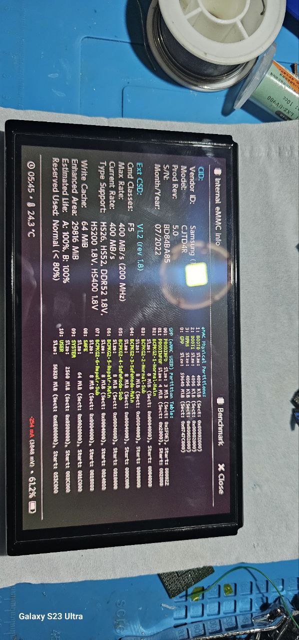

for someone who wants to jailbreak switch oled without a DAT0 adapter or rebelling emmc, this Method is good for me I just take the pin from the SATA cable and put it under the emmc and reflow it with hot air station. I usually set the temperature to 350c 50% for 1 minute. Never had any issue with emmc
