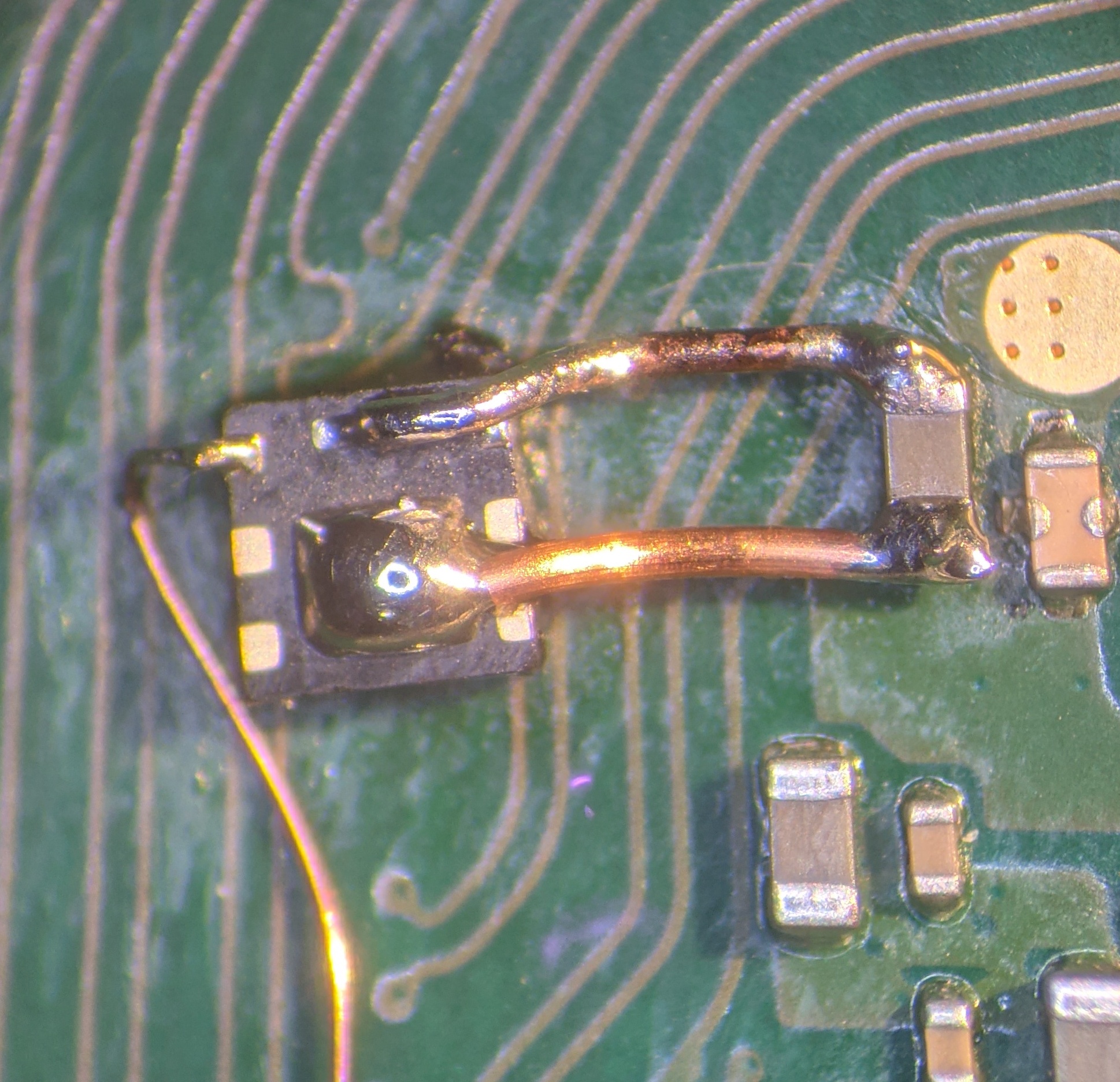

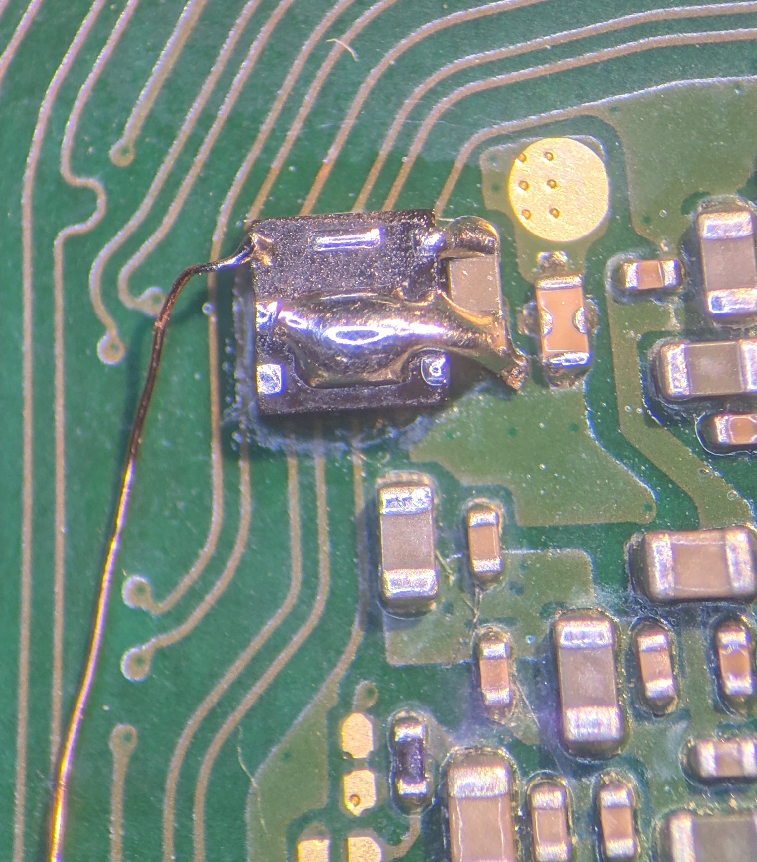

Well, probably it's just me, but in 3 different consoles that I tried, I never got them to work with a single MOSFET (IRFHS8342 from Digikey, 0.31mm wires on S&D, 100/100/47 and 47/47/47 config, RP2040-zero FW2.73):
- OLED soldered to CPU cap --> ==* (CPU always reach BCT check (no glitch reaction, check mosfet)
- OLED soldered in the back (deeps and Abal points) --> ==*
- Erista unpatched soldered in the back (Abal's points) --> glitched few times and than ==*
Some thoughts that came into my mind:
  • should I add another MOSFET so the current will be higher?
  • since the back points are more distant to the SoC than the "original" caps, is the distance enough to affect the glitch?
  • should I stick to double MOSFET on SoC caps as usual? Probably I will.
  • what am I missing here?
Would like to hear your thoughts on this :)
I've been doing a single mosfet on the back ever since it came out. Works great. I like to think the issue is almost always not enough solder. I'm always generous with the amounts on D and S. Maybe some pics? Here's a fast-glitching install:

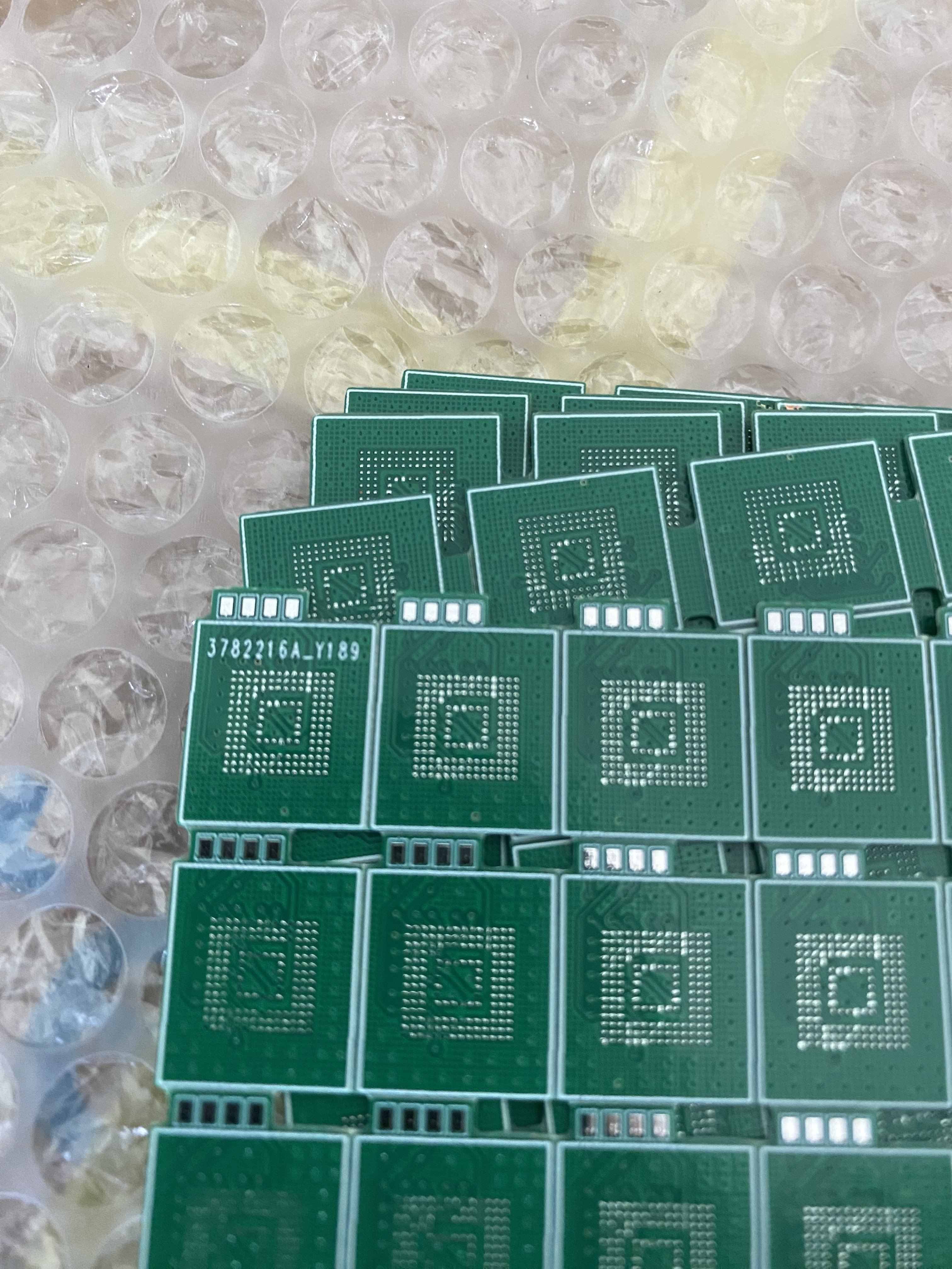

Hello, friends.
For those who do EMMC reball, which material do u use for the reball?
Solder paste or welding spheres? And what mm du u use?
Search in this thread, @lightninjay told some recomendation. And i had confirmed its works in seconds (between 15-50s) under transparent uv resin.

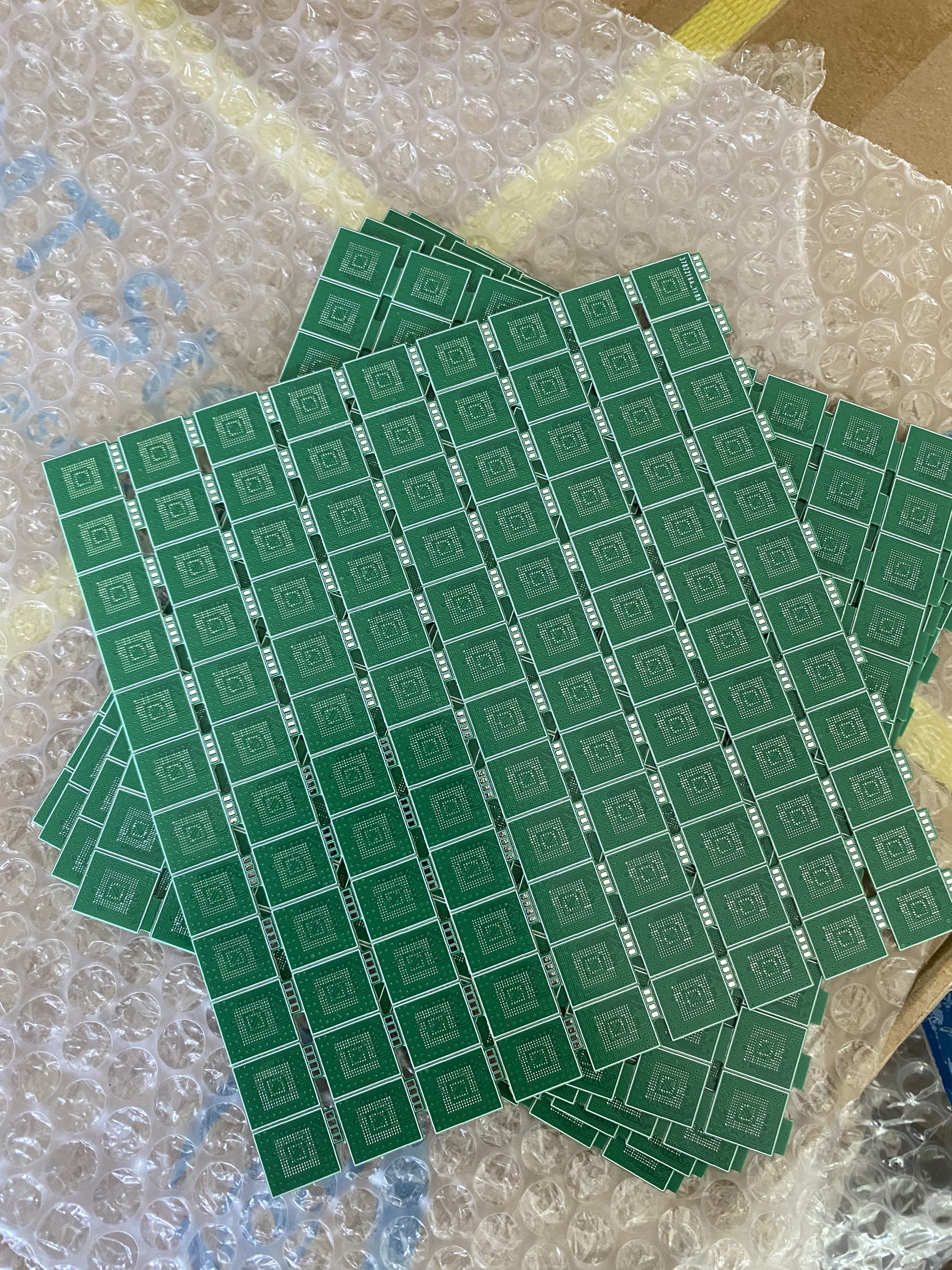

I see that many are asking for info on reball.
I made a video with the microscope camera, if it helps, I'll put it on YouTube with the various tips that my humble experience has allowed me to learn.
So I moved it from before to after (Erista install) and it glitches fast, same MOSFET. Looks like it was a connection issue, so thanks for your help.
Still I'm a bit perplexed, since the wires were short and large enough to handle the current (0.31mm). The important thing is that it works fine now :)
