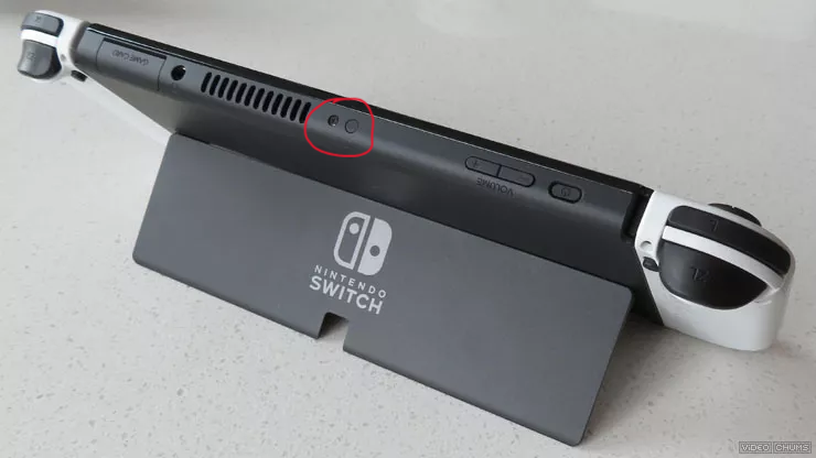

Hello Guys,
Someone tried to replace the IR led on the top of the console by another one to have directly the chip led indications at this place ? Like the mod for the Lite one.
This IR led is usefull in which case ? Maybe possible to find an RGB LED combined with an IR to do this mod and preserve the IR function.

That's the brightness sensor, not an IR led. You need it if you want automatic screen brightness to keep working.
