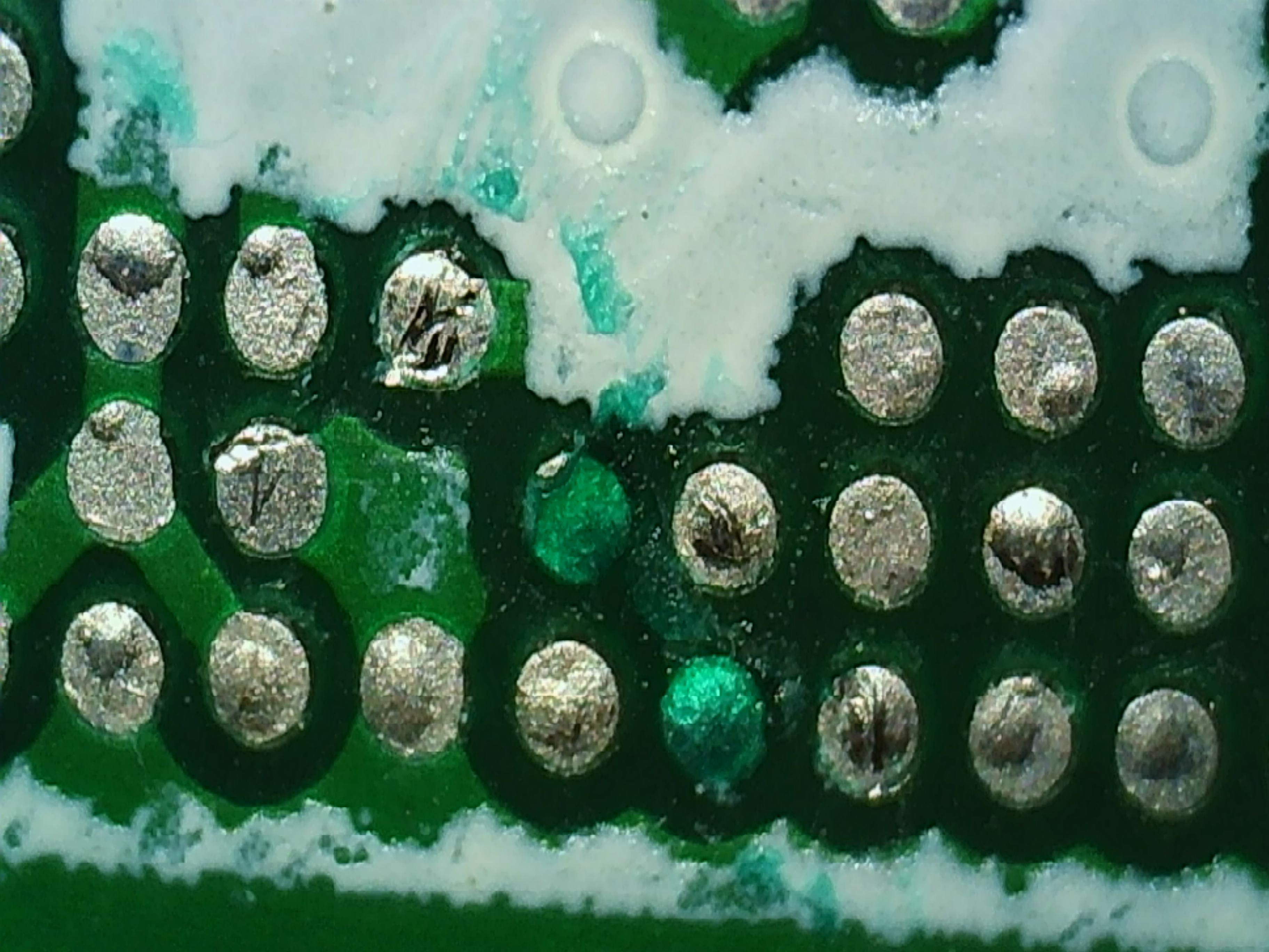

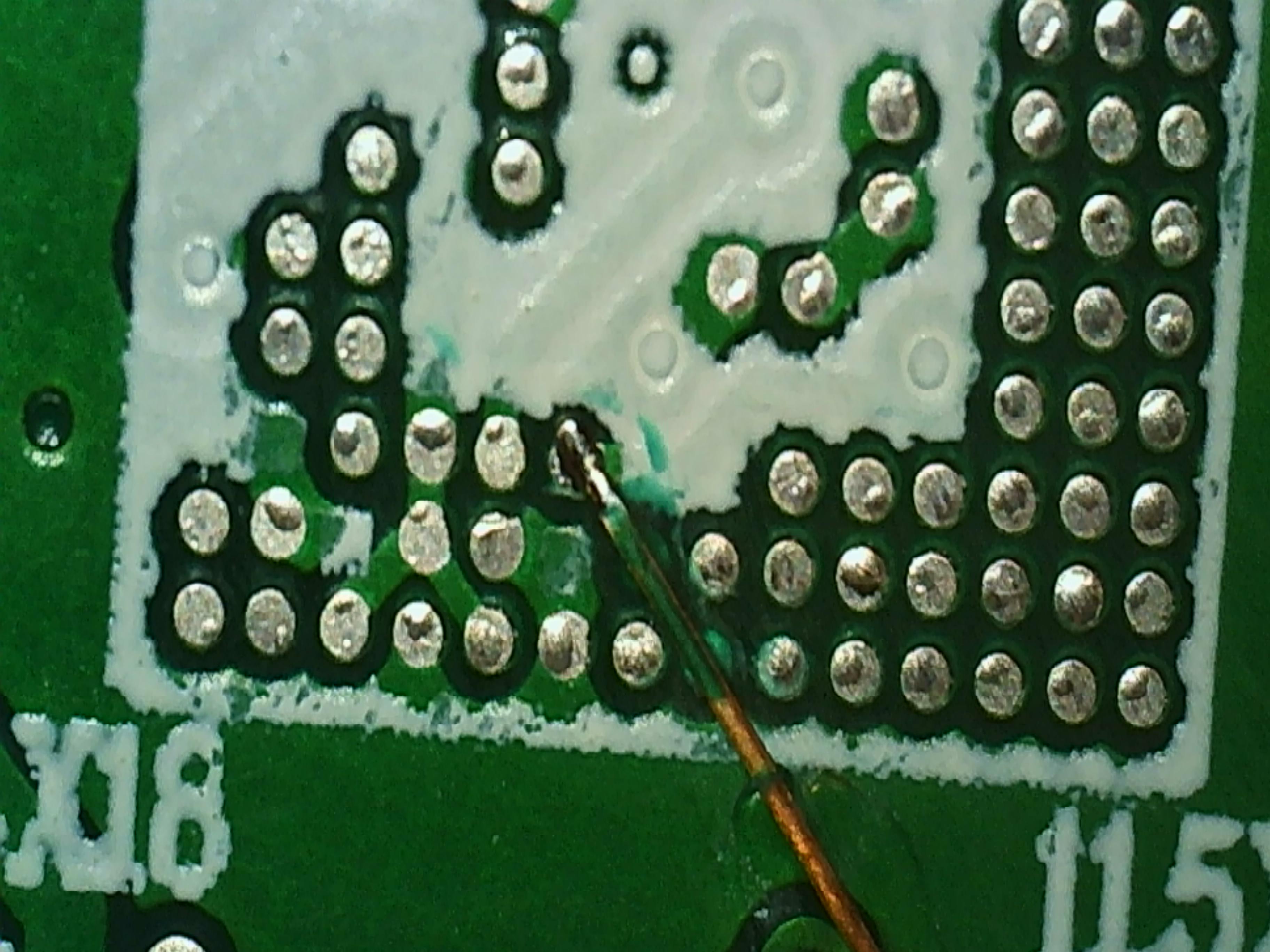

So, I was thinking, would this approach work for CLK?
I used a USB board with emmc (which I bought for practice) and covered the contacts which are NC anyways.
One could also reball the emmc with solder balls and just exclude those 2 balls as well.
What do you think?
What do you think?
why not just make this clk jumer from bottom side of pcb adapter? eMMC would have less risk
Sorry but I don't get it.
What I was thinking was that once we remove the emmc off the board (to do the dat0 jumper) we could maybe do the clk as well so we don't have to scratch the tiny via close to the apu.
Edit: the board used here (USB/emmc) is just an example where emmc connection can be seen since I didn't have a disassembeld switch board at hand)
I thought you gonna use green pcb adapter in between the eMMC and mainboard.
In your case you just remove 2balls along the way of the clk jumper and good to go.
Reactions: QuiTim
Oh no, I think the pcb adapter already has all the jumper points set. I was thinking of just doing the clk "manualy" same as dat0.
