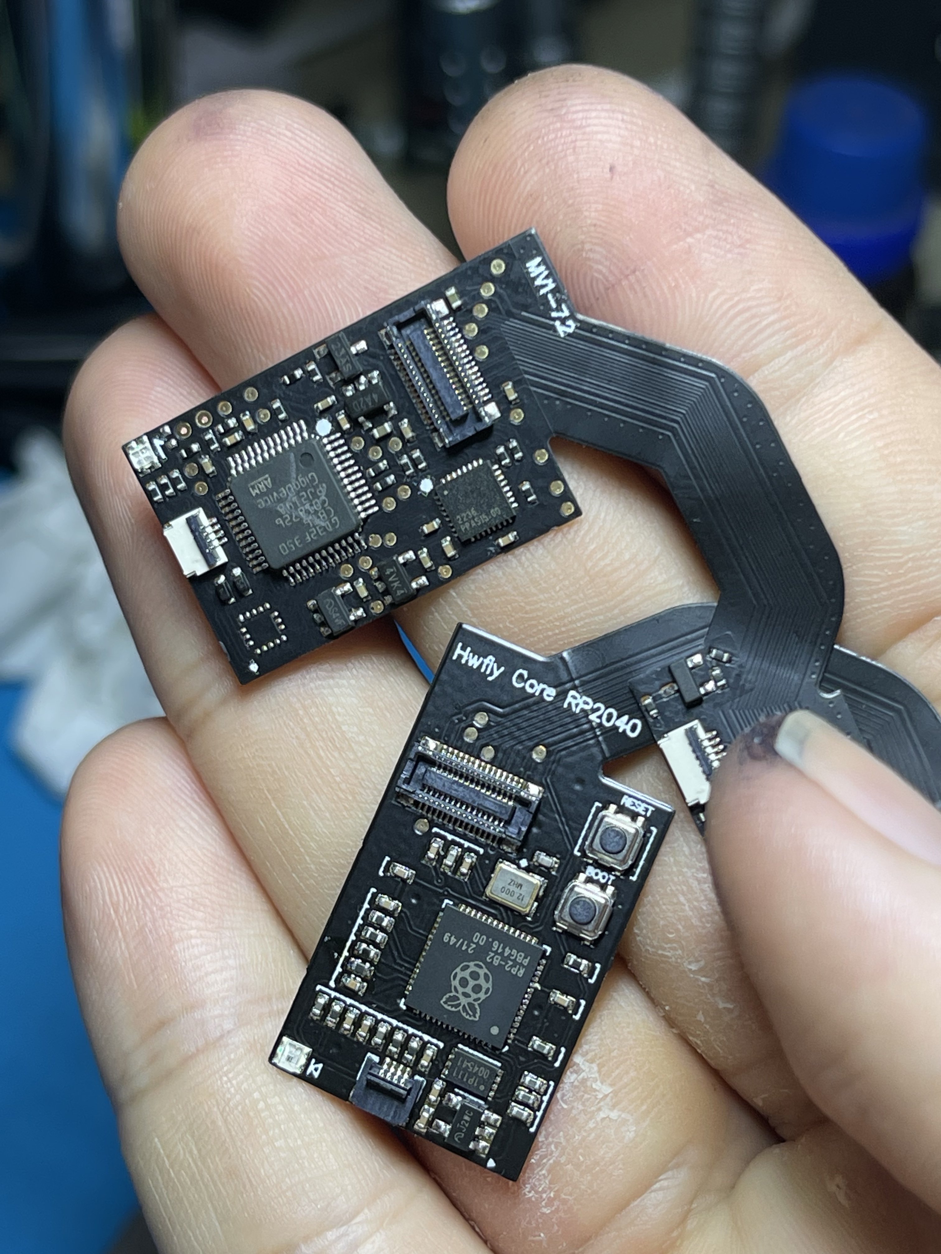

I accidentally instaling picofly firmware to hwfly chip
LOL
And its works well
Thats a pricey hwfly lol
That two emmc socket is not cheap.
hwfly just cut the margin so big, and its still pricey.

that's the hwfly core with a rp2040 chip. that's why it works, those are designed to use the picofly firmware.
No, thats hwfly chip for sure
First i instal hwfly, and change to hwflycore rp2040
And when i change back to hwfly
No sd screen still picofly logo
So i flash hwfly chip with the newst fw
And the no sd screen back to normal
Picofly stored the payload to the emmc, the nosd picofly ones.
When you change to hwfly, the hwfly just run those stored payload, hence the picofly nosd.
When you flash the hwfly firmware, and run it, the firmware will store their payload to the emmc, overwriting the existing, and run it, hence the spacecraft-nx.
Those 2 socket price alone is at $3-$4.
The rp2040 and the supplement is around $4
The pcb and flex around $2-4.
So totals its around $9-$12.
Thats without the electricity and equipment invetation to solder the component to the board.
So if you got that hwfly core at around $15 they have cut the margin so small lol :D
