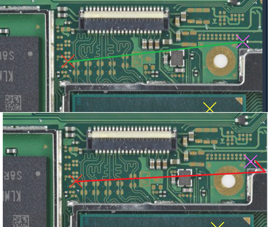

how do you check it?
If you couldn't even know how to measure resistance. Then i am reluctant to give further advise. It could be dangerous for a noob to do this. You might broke your device more then what it should be. At least you should know the basics about electronic.
Jika Anda bahkan tidak tahu cara mengukur resistansi. Kemudian saya enggan memberikan saran lebih lanjut. Bisa berbahaya bagi seorang noob untuk melakukan ini. Anda mungkin merusak perangkat Anda lebih dari yang seharusnya. Setidaknya Anda harus mengetahui dasar-dasar tentang elektronik.
i know how to measure resistance but which resistance should i measure?
Ukur 2 kali, yg hijau harus 0 ohm.. yang merah harus 4.7Kohm.

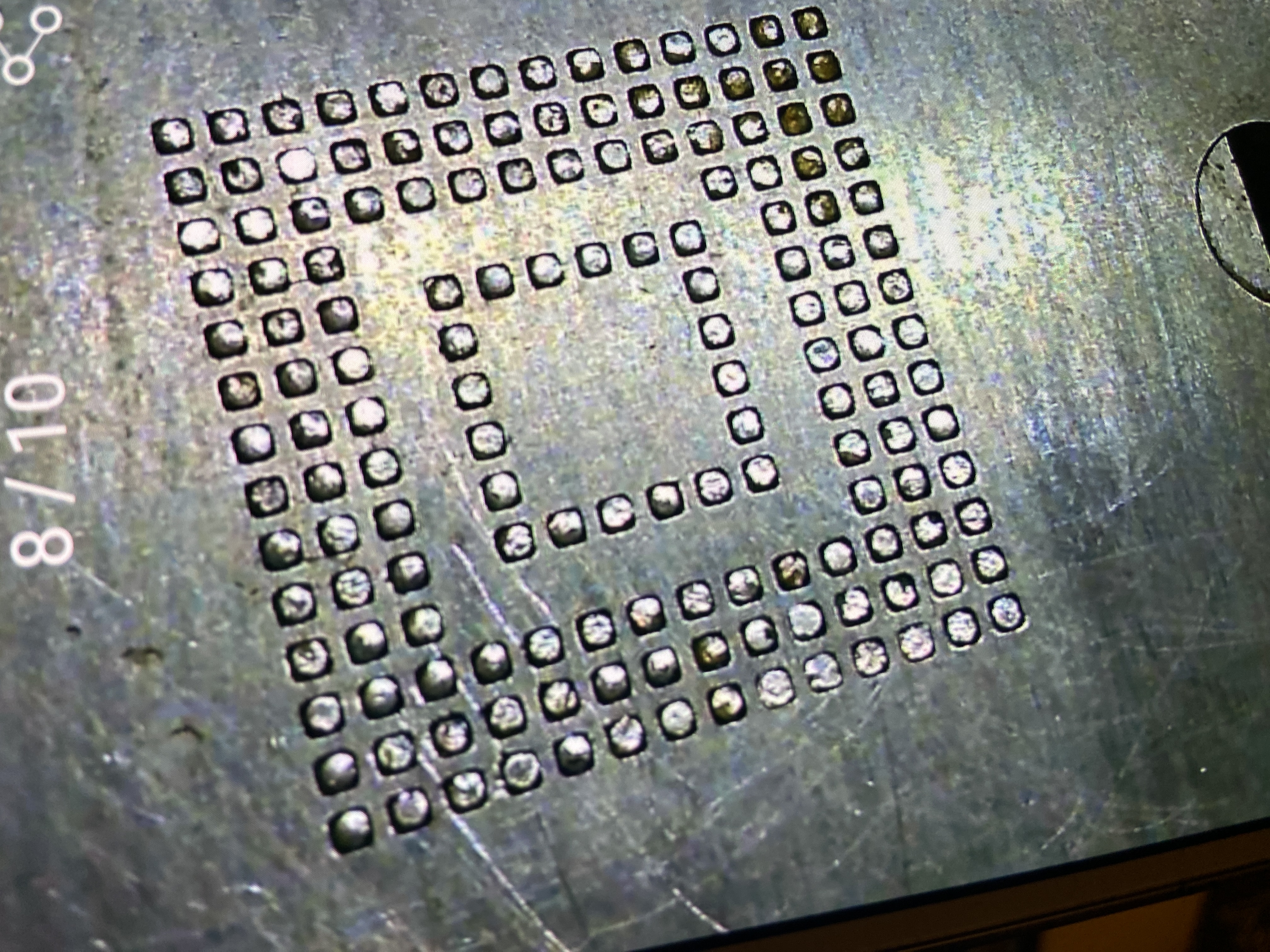

Nice looking good :-)
What was ur issue with the stencil?
U have to put magnet or something around the emmc so the rest of the stencil is laying on something so it doesn't have that much chance of bending.
Then add ur solder paste , if u have enough set ur tweezers in the middle of the stencil and push it on the emmc.
Then set ur hot air at 180 a bit more then ur pastes melting point and slowly best ur stencil up don't go straight to the stencil so its not a heat schock otherwise it Gonna bend really fast due to the heat.
Wait till everything is melted but always keep pressure on the middle of the stencil.
After that I usually add a bit flux heat it up one more time and then take the stencil off
Well I did pretty much everything like you described but I think my problem was that the temperature of the air was too high and it experienced the heat shock that you describe. I guess this was just me being impatient and trying to do this in the middle of the night after a bussy day at work but I'm sticking with it and eventually I will find the sweet spot and develop some consistency. Thank you for everything.

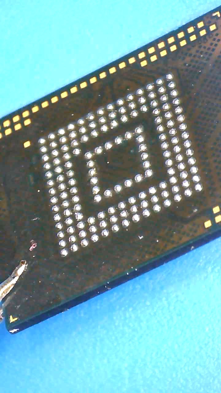

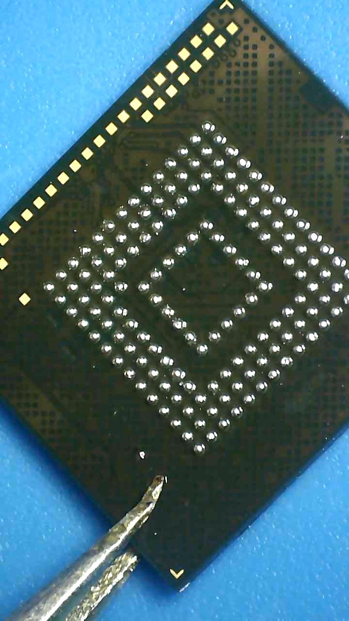

I finally got my hands on the Zelda Oled that I ordered 3 months ago and I decided to try and set a proper dat0 by removing the emmc.
A couple of things to point out:
- It was easier than I thought but I've been preparing/practicing for this for quite some time so for anyone reading this I would suggest you do your homework before diving in.
- The amount of beating these chips can handle is quite impressive.
- Same as Takezo-San wrote a couple of post above, I had no luck with stencil and paste (maybe I was stressed and tired because I started doing this at 11pm) so after trying a couple of times and failed I just did it manually one by one with 0.3 balls.
Everything went smoothly afterwards and since the board was already off I also decided to try the abal's mosfet placement on the back of the apu.
I just want to say that this is an amazing thread with some amazing people and the list of people to say thank you is way too long but I have to point out @Dee87 and @Takezo-San without whom I probably would have not had the courage/will to go through with this process and a special thanks to @abal1000x who’s dedication and contribution to this whole mod is priceless.
Below you can see some pictures, I should have done more but I got carried away in the heat of the moment :D
Edit: It goes without saying that without Rehius none of this would even be possible so... :bow: :bow: :bow:
Looks amazing. I'm currently practicing reballing on a lite. I recommend this AMAOE reballing kit. It really does the work for you. No holding the stencil with forceps or anything like that. I'm too lazy that I also got a heat gun holder (powerful combination)
With my setup, these balls get created while I'm preparing the wicks and tinning my iron.
