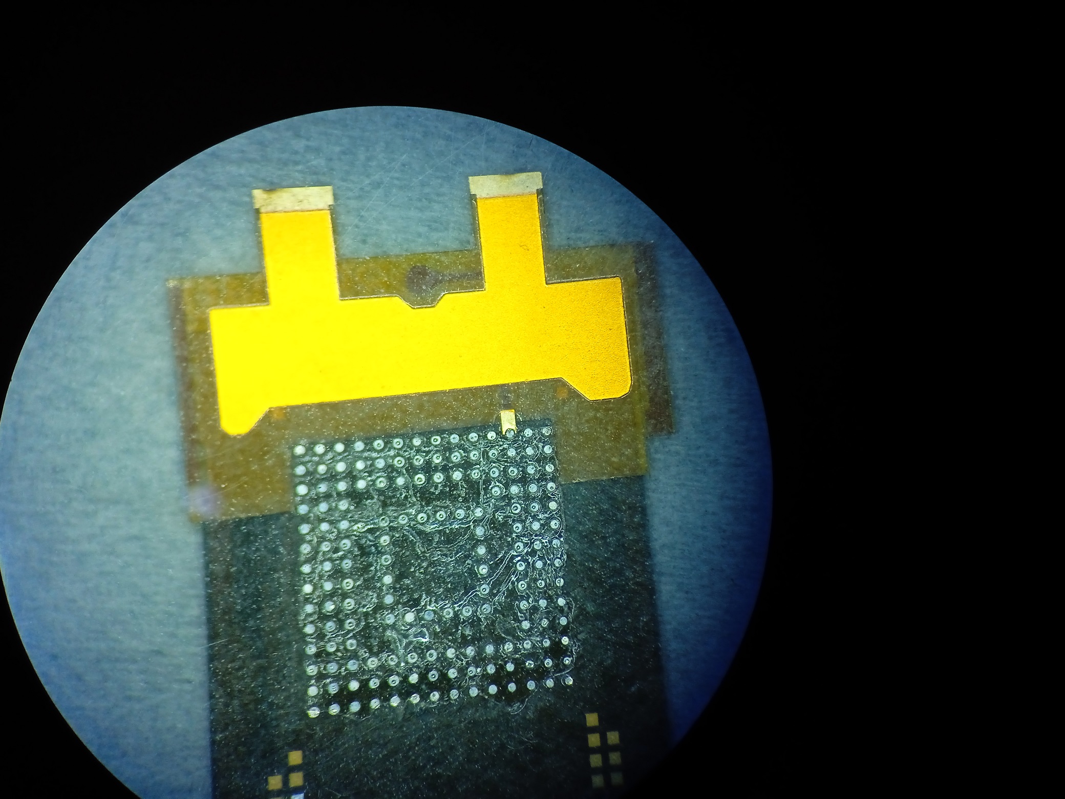

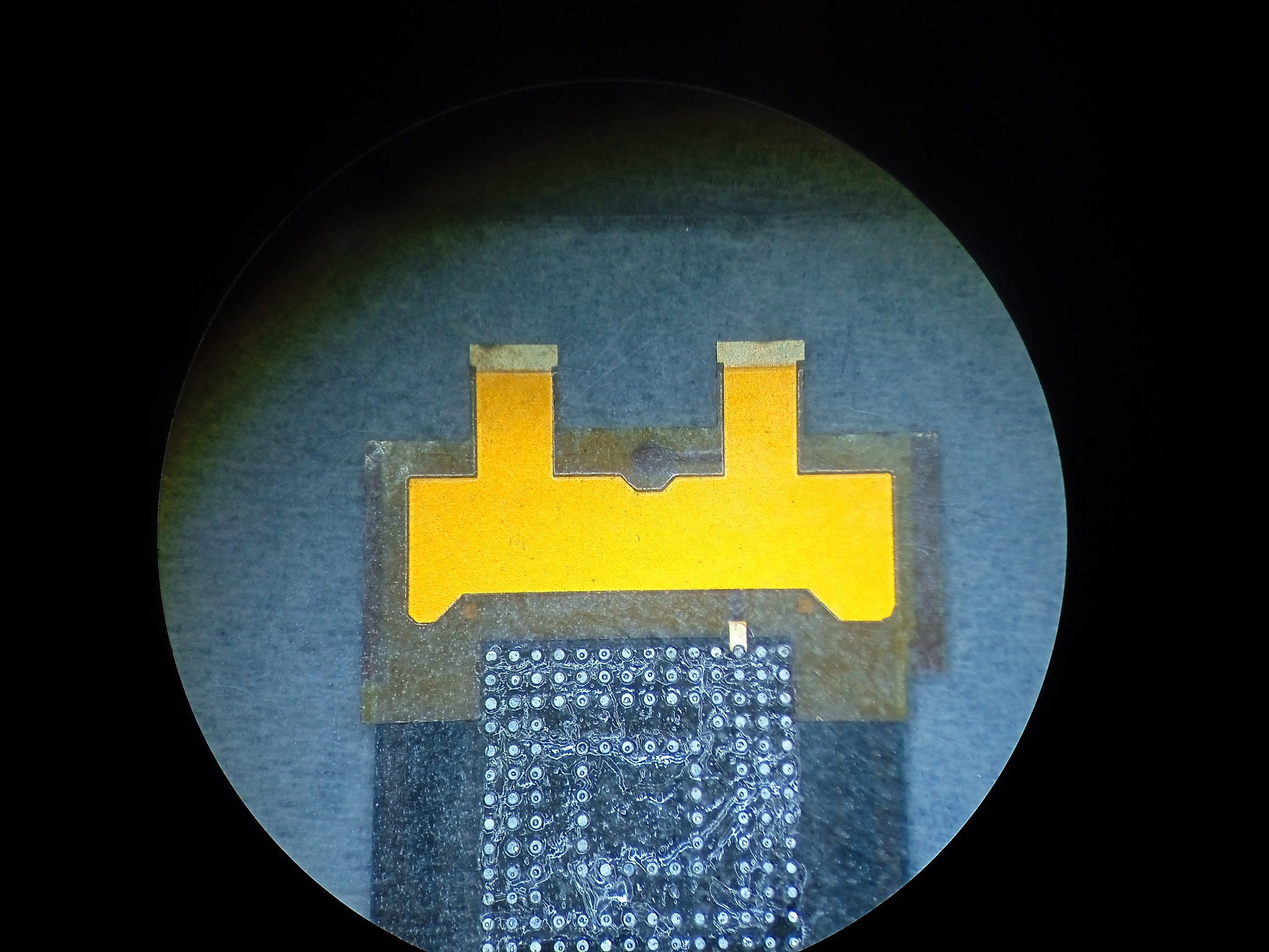

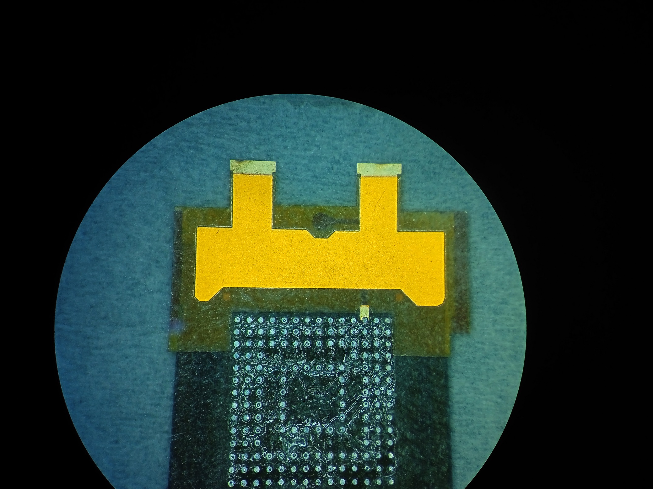

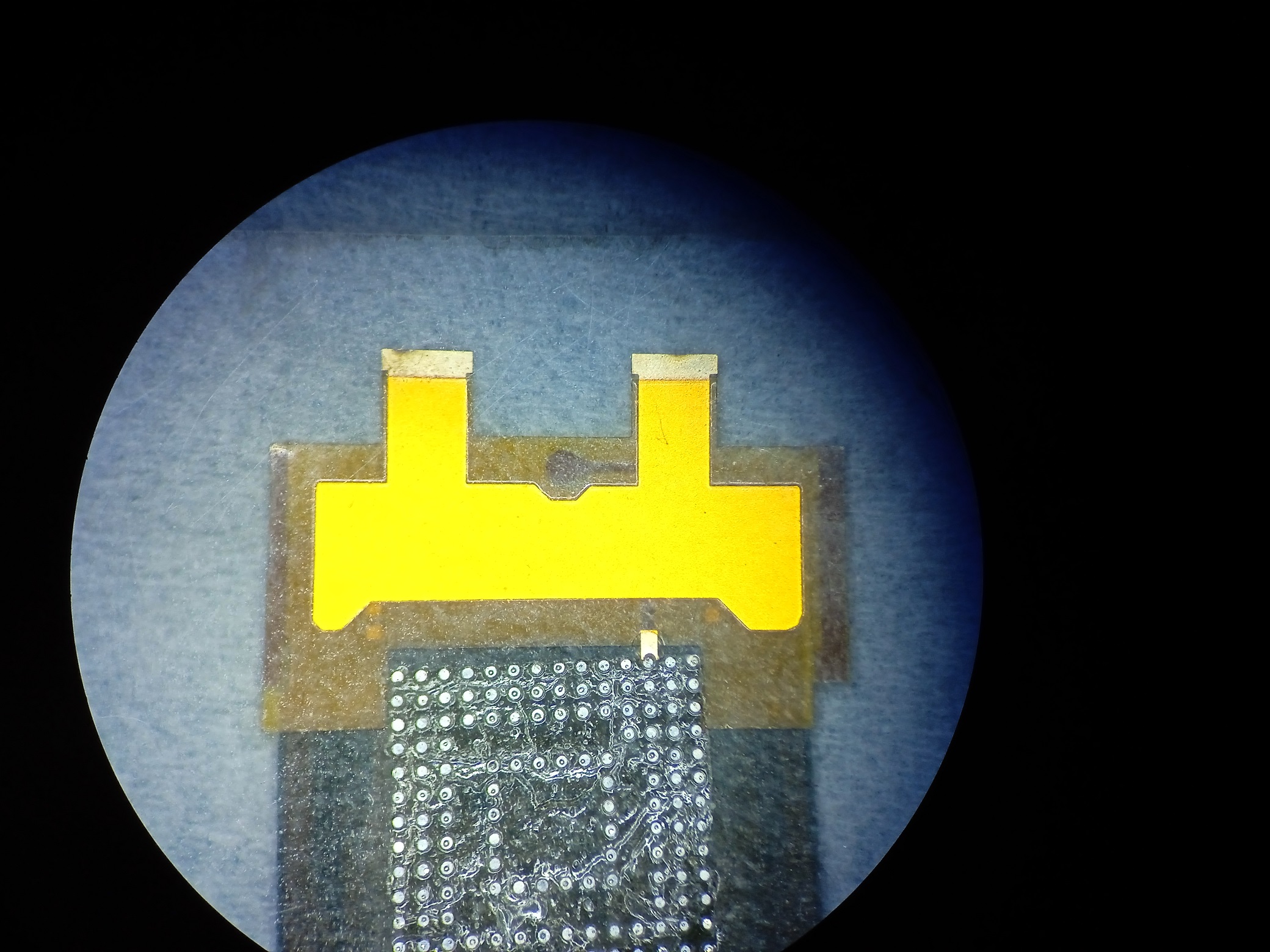

To put an end to these claims that these adapters are the main cause of bridges I took a piece of transparent acrylic then reballed and seated the chip on top with a thin layer of adhesive film to hold it in place. And lo and behold, not once did I touch D1 even when doing it blinded. There is a case though when I pushed in aggressively it wrapped.
View attachment 388508View attachment 388509View attachment 388510View attachment 388511
This is a good prove if we ignore the cohesion of the tin to the pcb.
Doesn't look rebelled to me. Just looks like bare pads with maybe a tiny bit of solder on some of them. Despite that you can clearly see the tab can bridge between any of the pads even without solder balls so not sure what you're trying to show here.
The chip is in fact reballed. It only looks like that because I heated the chip under its weight so balls looks flatten.
Despite undisputable proof you still insist you can bridge these points. Be my guest, if you can with this adapter I'll give you a million dollar granted you never force the adapter in.
Solder balls are larger in diameter than the pads on their own. This isn't something that needs proving. Everyone knows you can bridge dat1 and dat0 with the adapters. It's the cause of 90% of these purple screens you see in this thread. You should do some reading of the older pages and catch up on knowledge.
I never said the use of these adapters never caused problems. Read what I said earlier.
My verdict is, if you use the right adapter you're fine.
If you get fucked from this adapter then the adapter isn't at fault, its likely something else. And since you said nothing wrong with eMMC factory reballed, the burden of proof is on you to show that factory balls come perfect since I made my point about bridging using this adapter is impossible.

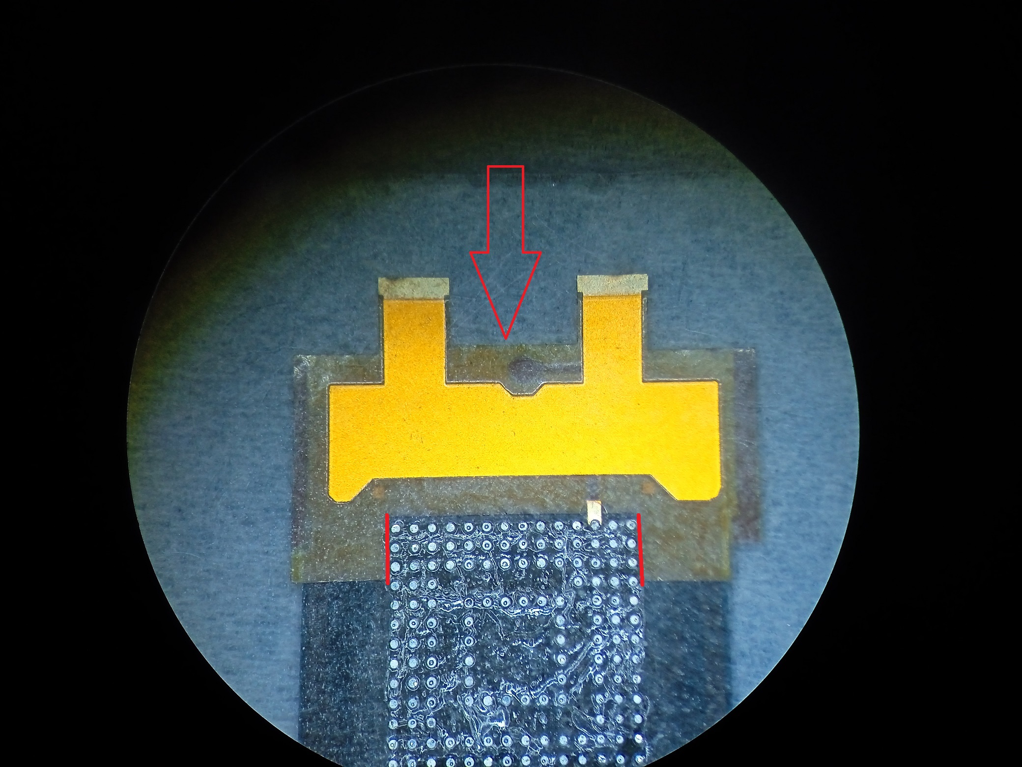

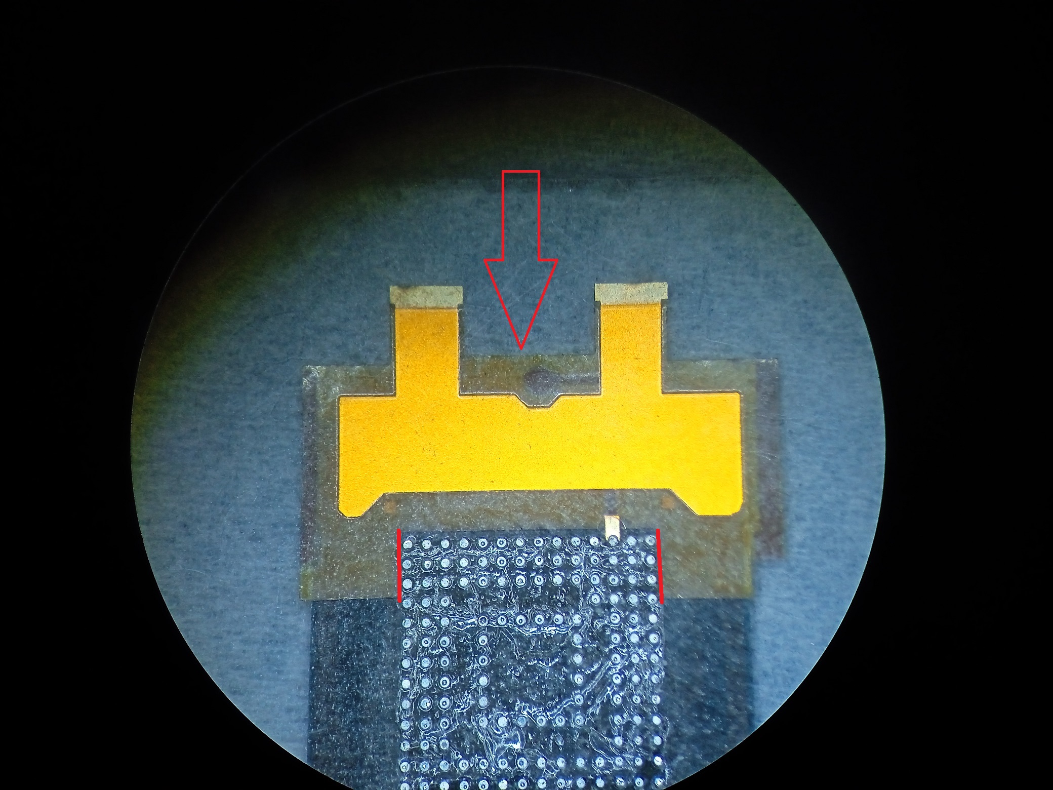

The adapter can only be inserted one way. If you try to force it any other way you will end up mangling the adapter. So I don't know how that person is going to bridge a point he cannot even reach.
Ignoring the cohesion between the tin and the pcb this is true.
Using the bad adapter circulating in the market you would.
Because the contacting pad is wider, and the locking size is not precise.
So the problem lay on the quality.
