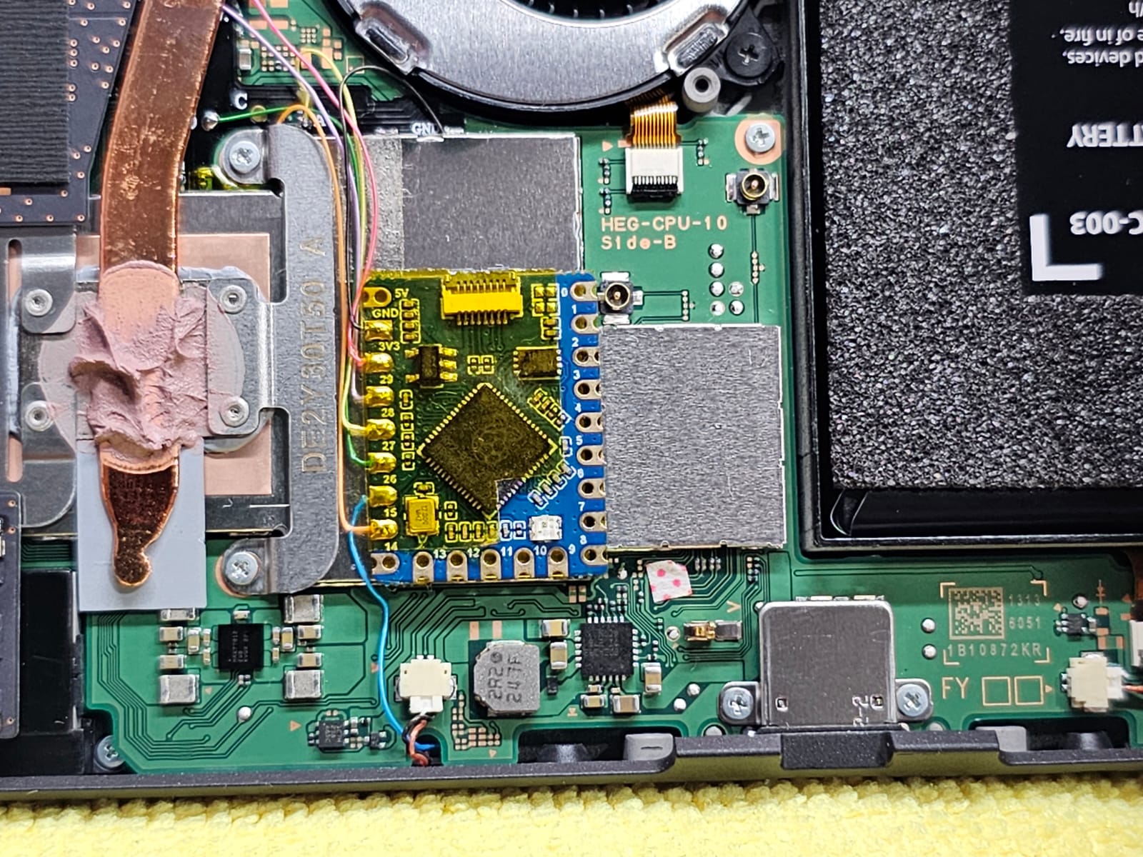

So, I was thinking, would this approach work for CLK?
I used a USB board with emmc (which I bought for practice) and covered the contacts which are NC anyways.
One could also reball the emmc with solder balls and just exclude those 2 balls as well.
What do you think?
Yes, should work if you can get the wire to stay in place while attaching emmc. I've been thinking of doing the same, with cmd as well. Note that the RFU balls ("Reserved for Future Use") are unconnected on the switch and can be used/skipped/whatever just like the NC balls
Well thats even better (the RFU), the whole line is surrounded by the contacts not in use.
And the copper pad/wire is secured with transparent uv glue so it should stay put (I just used the green uv mask on pads so it's better visible in photos).
I guess I will give it a go on the next oled that I get my hands on.
CMD seems too risky for me right now, I don't know, maybe like this (photo) would be ok...
Cheers
Trick for small smd: Tin both pads with solder and heat up both pads with blade type iron(or whatever suite you best) then move the resistor/cap in pace. Component would go in pace by surface tension if both pad hot enough.
What do you think?
Sorry, unlreated, but what's the USB board that you're practicing on? I'm buying Andriod boxes for practice but they have 221 BGA, not 153. Would love to know what you're using.
Oh no, I think the pcb adapter already has all the jumper points set. I was thinking of just doing the clk "manualy" same as dat0.
(Pictures of what I was using as demo)
What do you think?
