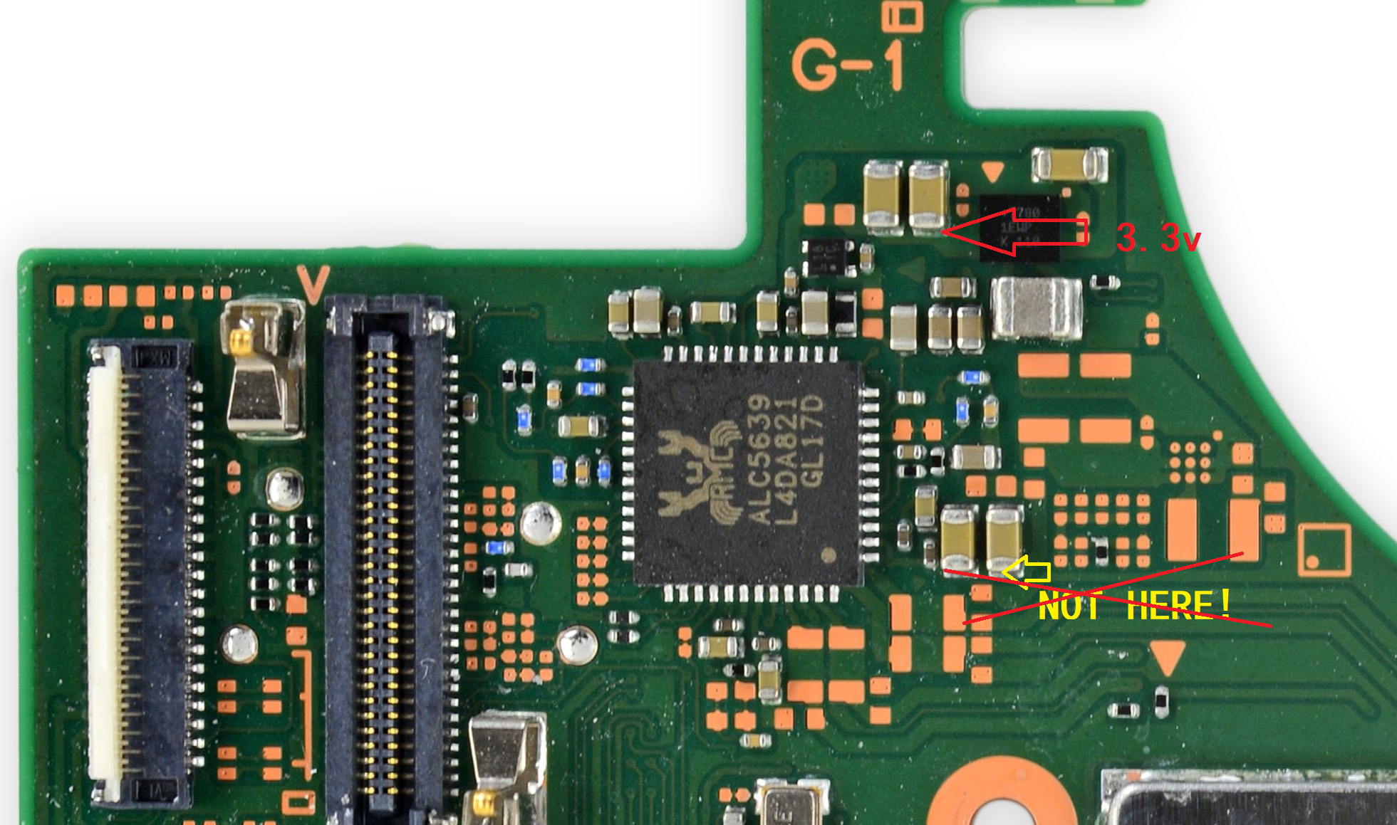

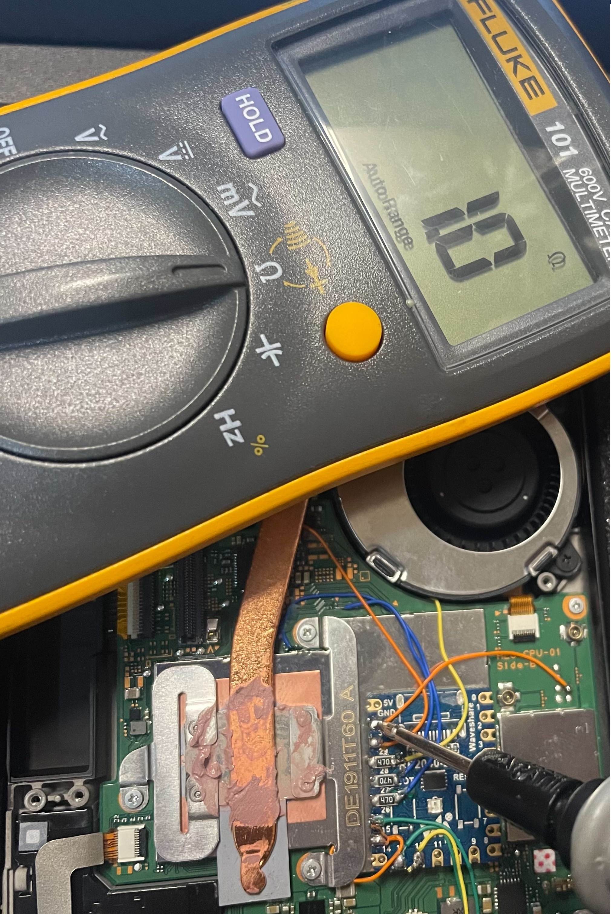

Just asking, from what point you got the 3.3v?
What version of firmware are you used?
Editted:
That is ** RST not connected.
i got the 3.3v from just above the sd card slot.
im using the Latest version of the firmware.
I re sodderd and recevked rst point and its connected.

The 3.3v point is wrong

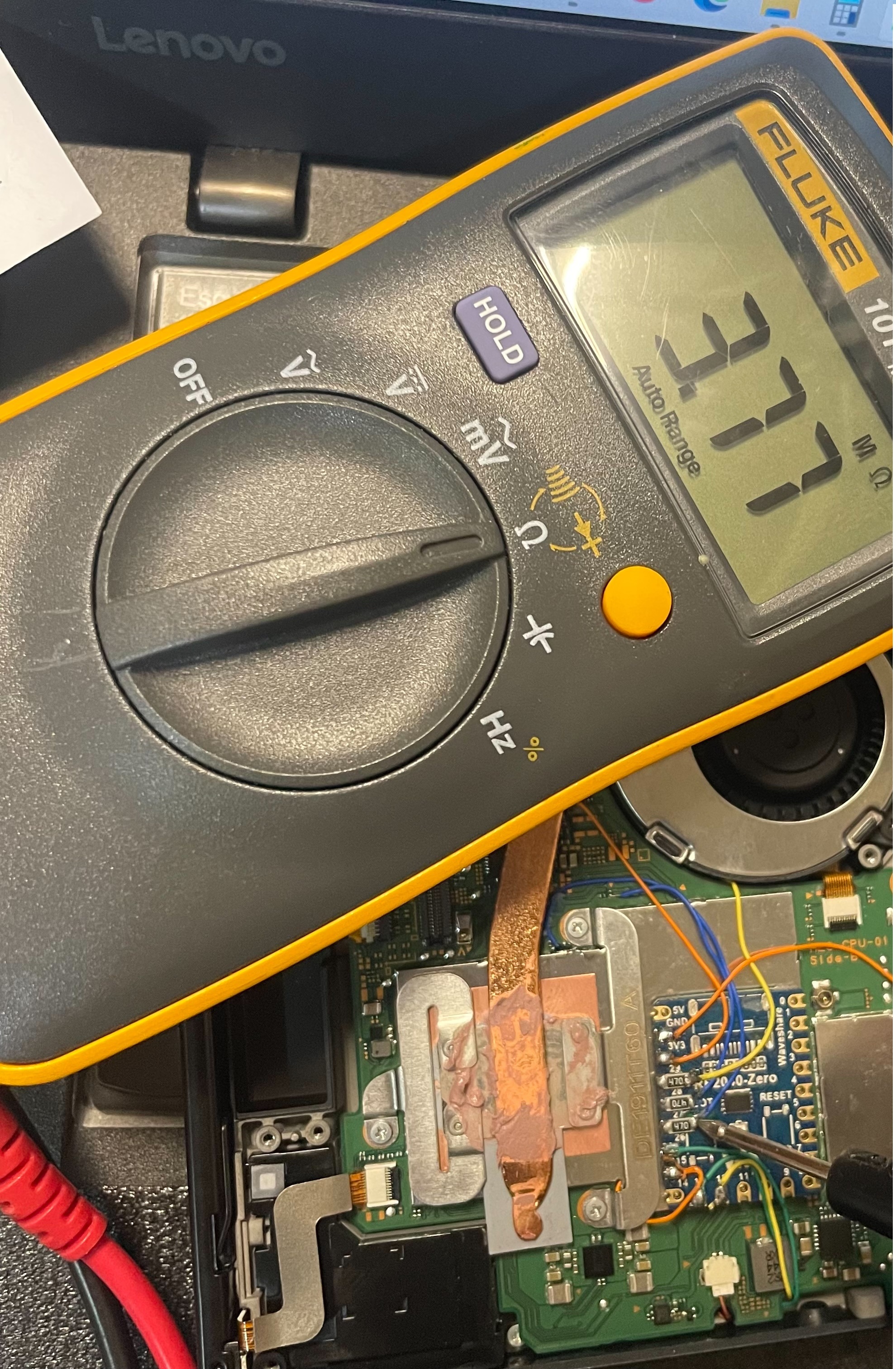

Thats 4.2V right?
I think i know why its throws RST error code.
Because the VCC goes to rp2040 4.2V then the first check:
Which is checking the RST lines voltage,
The read from the adc is not in the scale of 3.3v anymore. So the formula in there is becomes wrong.
If the voltage 1.8V using 3.3V Vcc the adc will be read as 93.
When the voltage 4.2V then maybe the adc read as 72 (which is 1.8V in 4.2v).
But because we calculate as 3.3 its become 72 * 3.3 / 170 = 1.39V, which is under the lower tolerance 1.6V. So its decided to throws the error RST disconnected.
Maybe we could revise the code. If the voltage between 0-0.8V considered disconnected. If the voltage between 0.8V-1.6V considered problematic - line, and 1.6V-2.0V good, and >2.0V problematic + line
thats SPKVDDL from datasheet, voltage range from 3.0~5.0v not sure it from battery directly or not

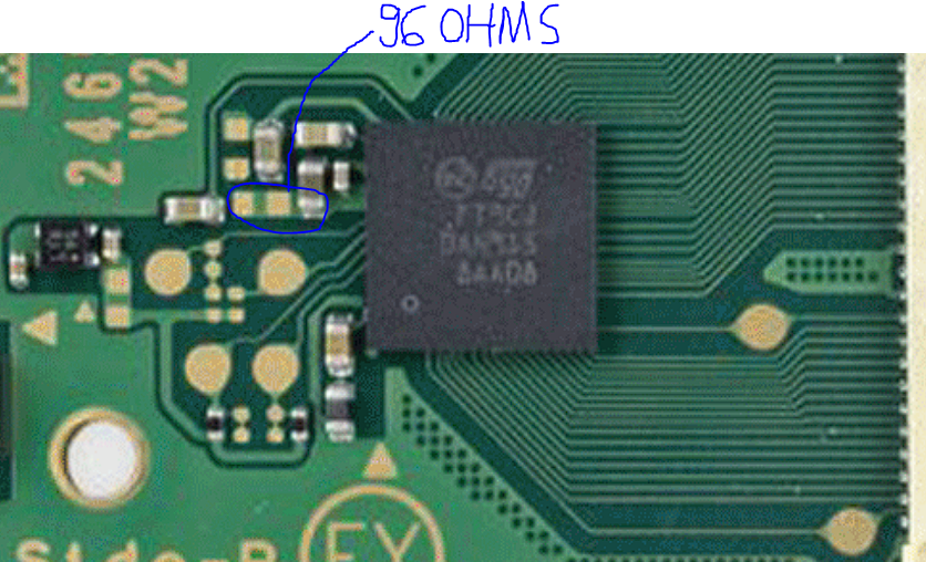

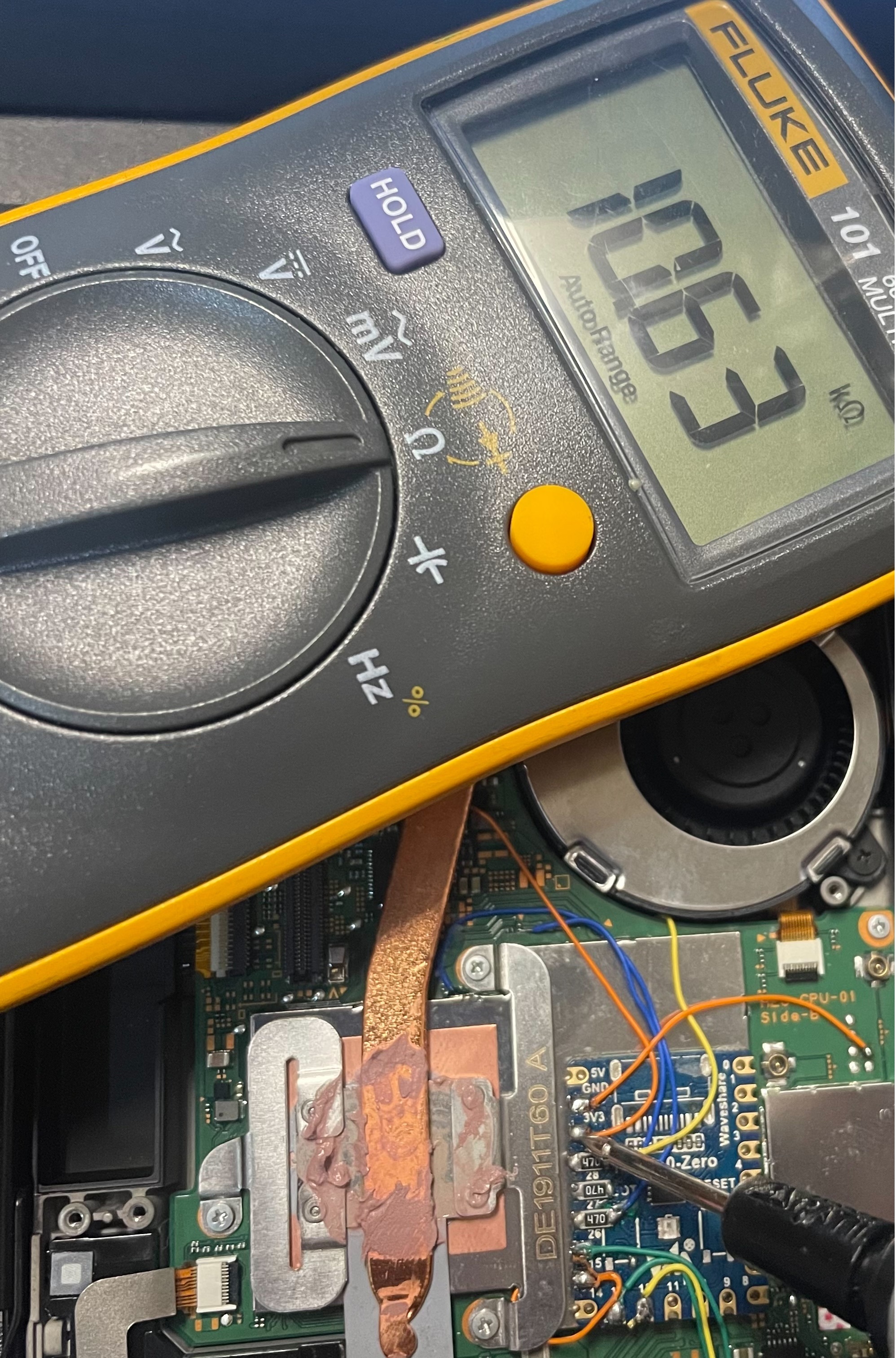

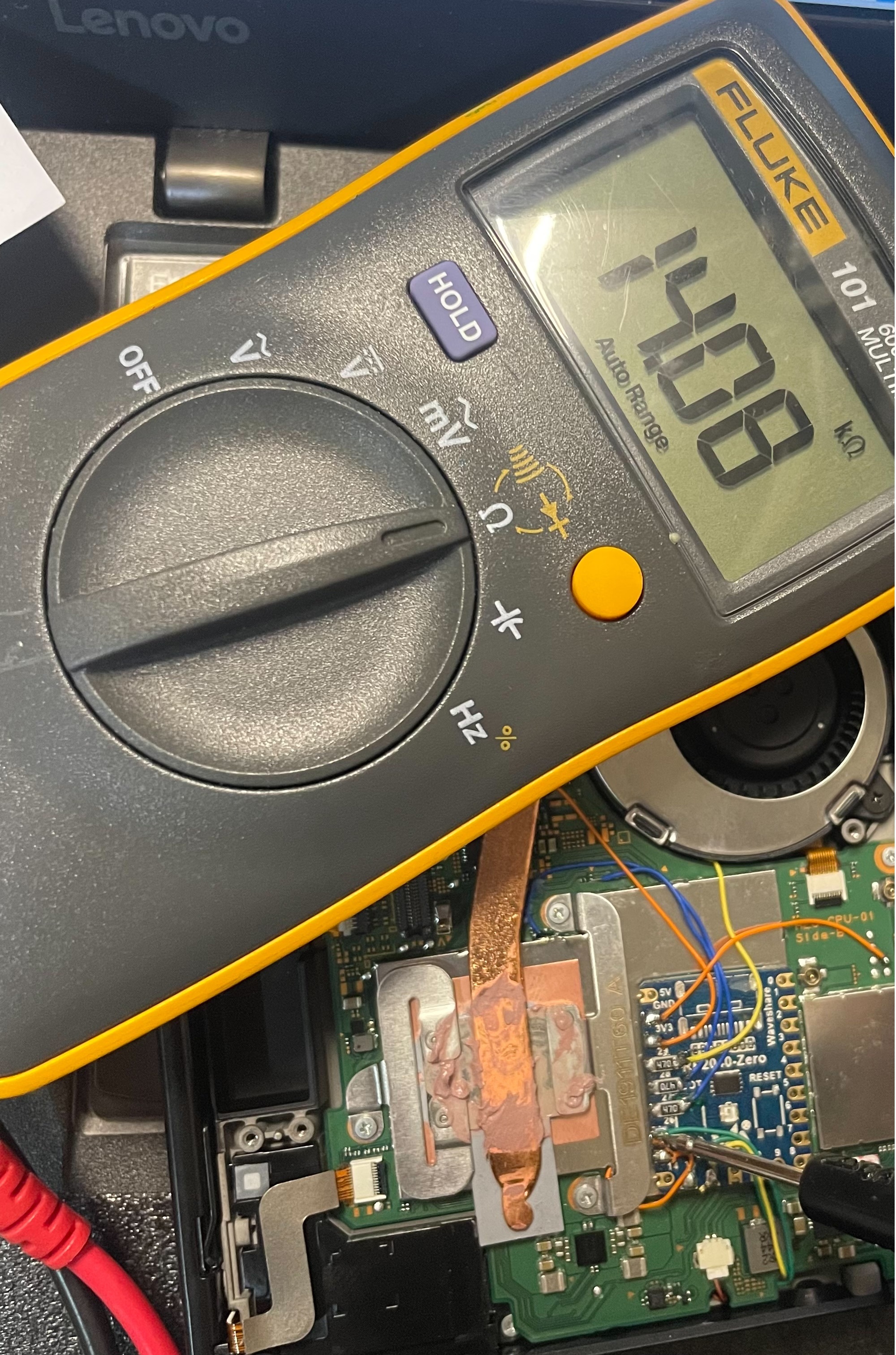

I thought the problem was the micro sd slot. But it looks like it has a short when I tighten those screws near the ZR button. There is some short, it happens in this region. As you can see in the photo, this line has very low resistance, next to the ft9cj touch chip. Whenever I tighten the screw the micro sd does not work. And Hakete doesn't get up.

Was the broken resistor no reading at all after you took it off board?
I wrote it wrong, clk was bad. I did not cut off enough material from cpu shield and it was hard to reach, line broke near via.
I currently have the same issue as you. CMD resistors seem broken and switch black screen. Waiting for replacements to arrive. Did you redo the install after the repair? In what way was the CMD line destroyed? Broken trace? Bad resistor?
I was wrong my issue was clk line. It was hard to reach and line broken near via. The wire only connected to the line not the via. Yes I did the install again now it's work well. I had to replace the cpu flex shortly after install, mosfet died for some reason. But ok since.

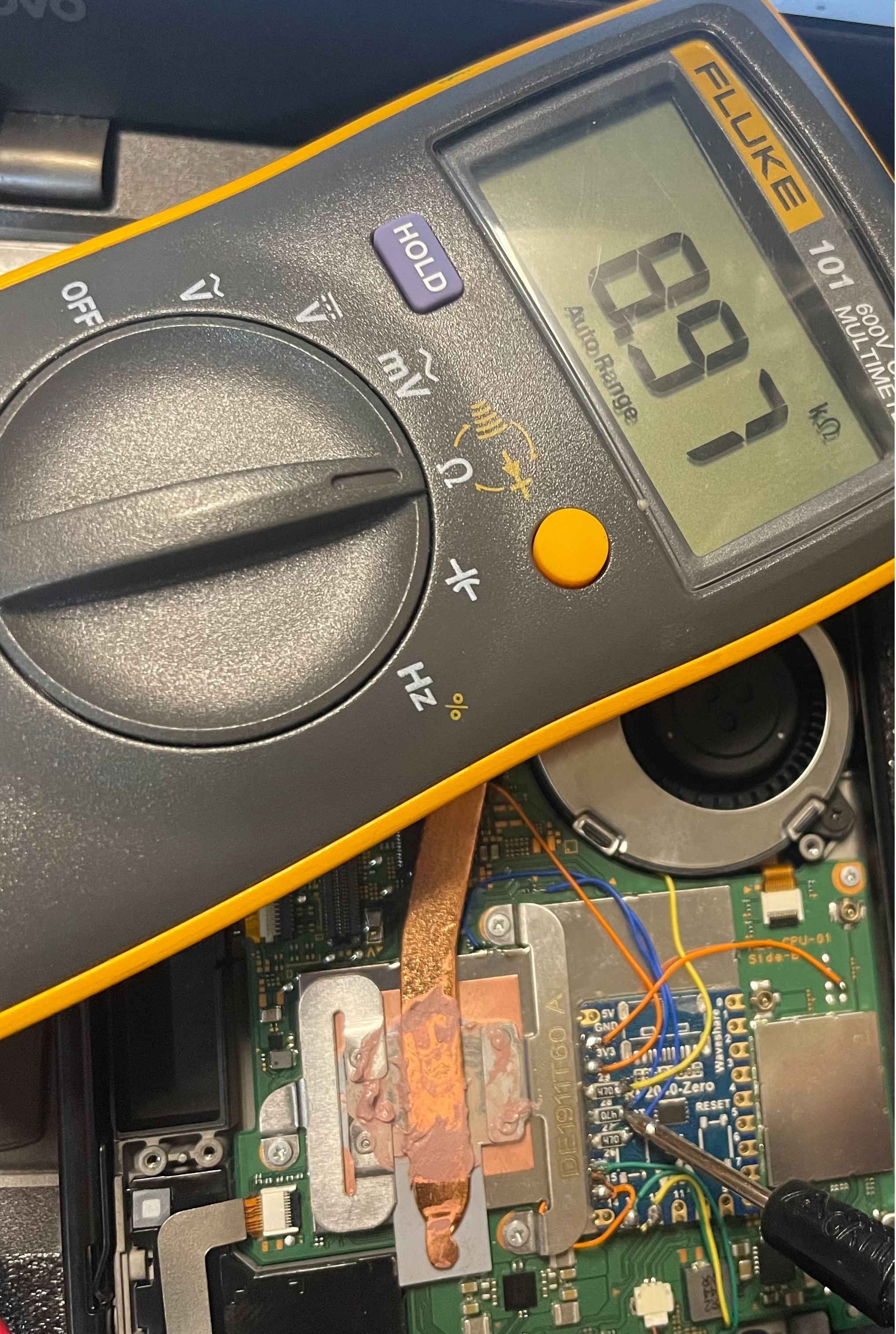

Did you try to turn on the switch after wires soldered to all point, basically before wires connected to pico?
This to analyze whether the culprit is on soldering, adapter or it needs to be combined with pico connected that result in this bsod.

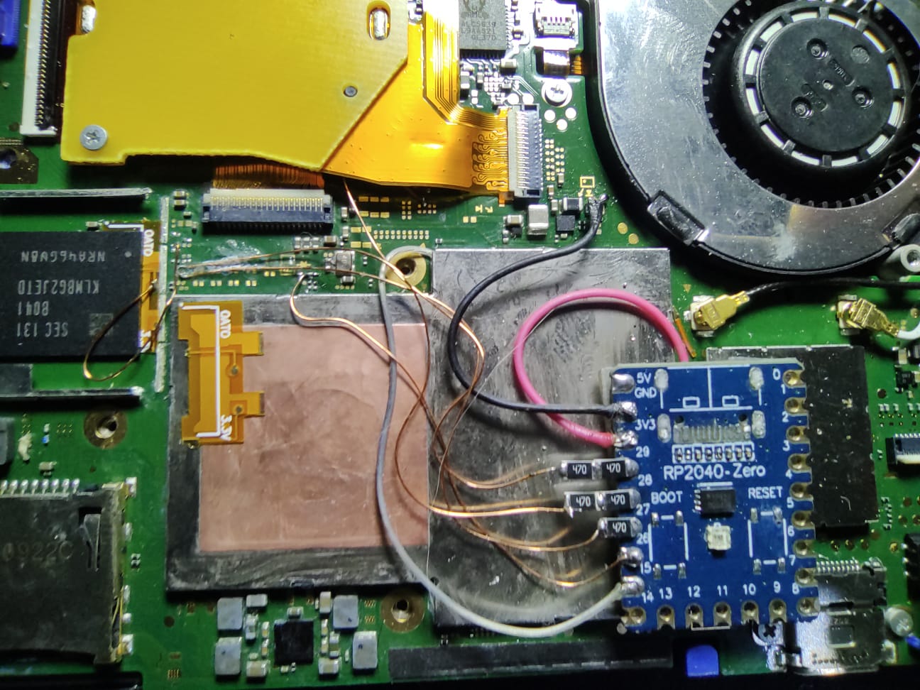

Alright, which one of you chucklef*@#s is selling pre-flashed picoflys on Etsy with the wrong size resistors? (SwitchModService in Plymouth UK according to the etsy listing)View attachment 378090
Jesus, that's awful. No tape under those floppy resistors anyway! 🤣

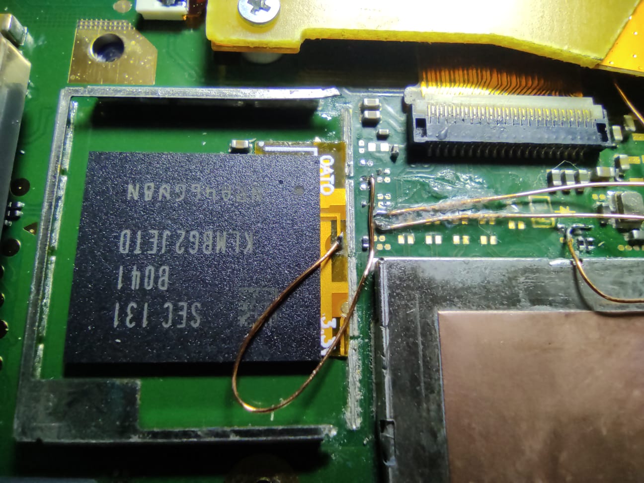

I would try a couple of things here to fix that trace.
1. Easy - Cover the surrounding points with kapton/solder mask and put a blob of solder there in hope that it will create a short between the 2 points (use good flux and sn/pb solder)
2. Medium - use this specific dat0 adapter (as in Oled) as it has no anchor points and then create a bridge from dat0 to one of the points where it need to be (check picture "a5" the blue X on top right)
3. Hard - use a 0.02 jump wire to try to fix the broken trace between two points.
Picture legend:
a1=dat0 in place in oled to give you an idea of size;
a2=dat0 that im talking about;
a3=how it should be placed;
a4=whats going on beneath;
a5=Lite board traces
This is pretty much what @abal1000x is saying but with pictures :D

Be proud of yourselves @QuiTim and @abal1000x , I adapted the solution a little, but the method is all yours. I used one of those crap dat0 cables and did extensive testing using the emmc diagram, and the https://balika011.hu/switch/lite diagrams, to make sure my dat0 and dat1 weren't shorted, (in the end they were, hence the purple screen, since the cmd track resistor was ok) I made a jumper using the rest of the broken track, to what was left of the old track and that's it, I got the SD screen.
It is worth mentioning that since I did not have the correct dat0 adapter, from Munia.io, I used one of those horrible ones, properly cuted, TEMPORARYLY, to obtain the measurement of dat0, and check if the solder of my point was having access to dat0, I knew that dat0 and dat1 could be shorted (purple screen), SO I REMOVED it once I fixed the broken dot, and here we are, working!
* I had to add an extra resistor to dat0 pico, as I had intermittent =*** eMMC init failure issues, which I haven't experienced again so far. In any case, I managed to make a full backup of the Nand, with all the prodkeys. benchmark emmc, seems normal.
