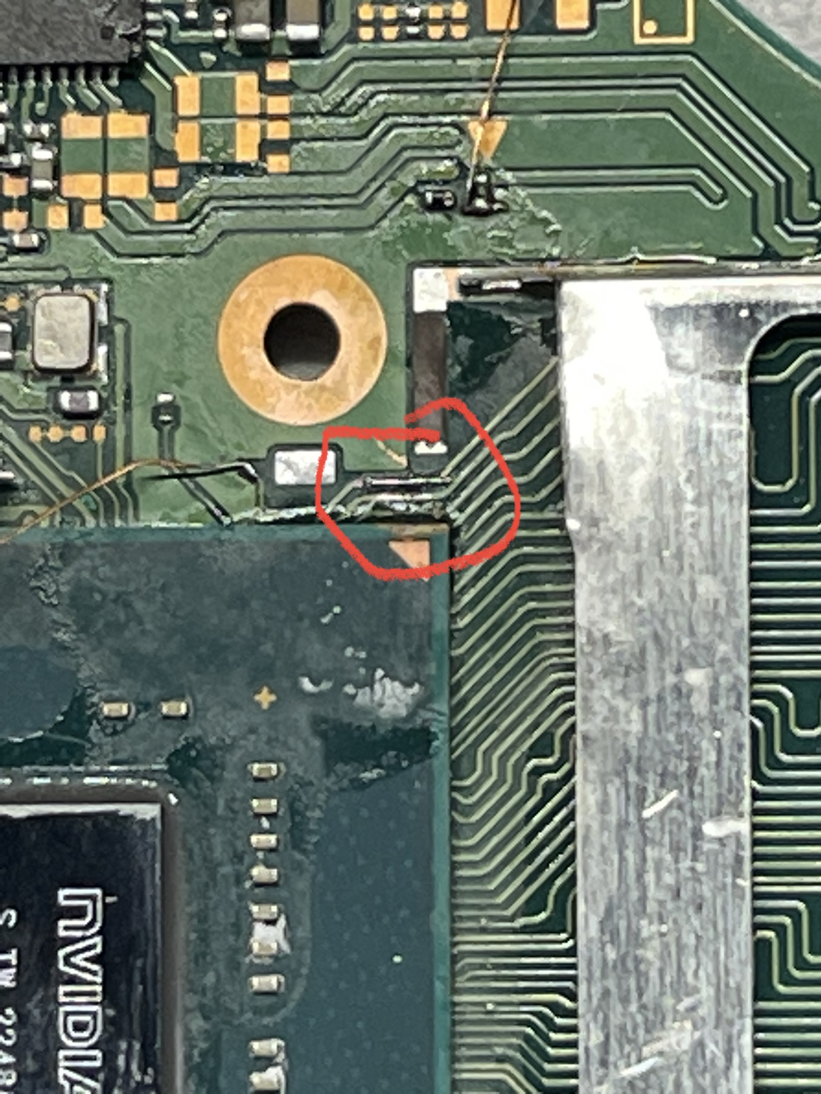

A few back someone found that cmd resistor is broken even when not touch by anything during instalation.
From my exp : broken clk, dat0, rst will result in black sod.
broken cmd will result in purple sod.
Once i had blue sod, thats when i made a scratch on pcb traces near apu n ram when tried to cut the shield bridge.
Oh my God I can’t even begin to Thank you. I had an OLED yesterday that went blue screen of death and I for sure thought it was the flex cable and I just fixed it after seeing your comment. I had broken two traces.
Well, as I said, It had to be mosfet related (either that or some kind of witchcraft :D )
Glad you managed to get it up and running.
Oh man it’s amazing. This group rocks!
could you please show a picture of said trace? I'd like to see If I have the same problem :'(
I have 1 OLED and multiple V2, I'll check the OLED to see if that changes anything
Oh. Mine is only the OLED. I will still send pics though.

Here ya go.

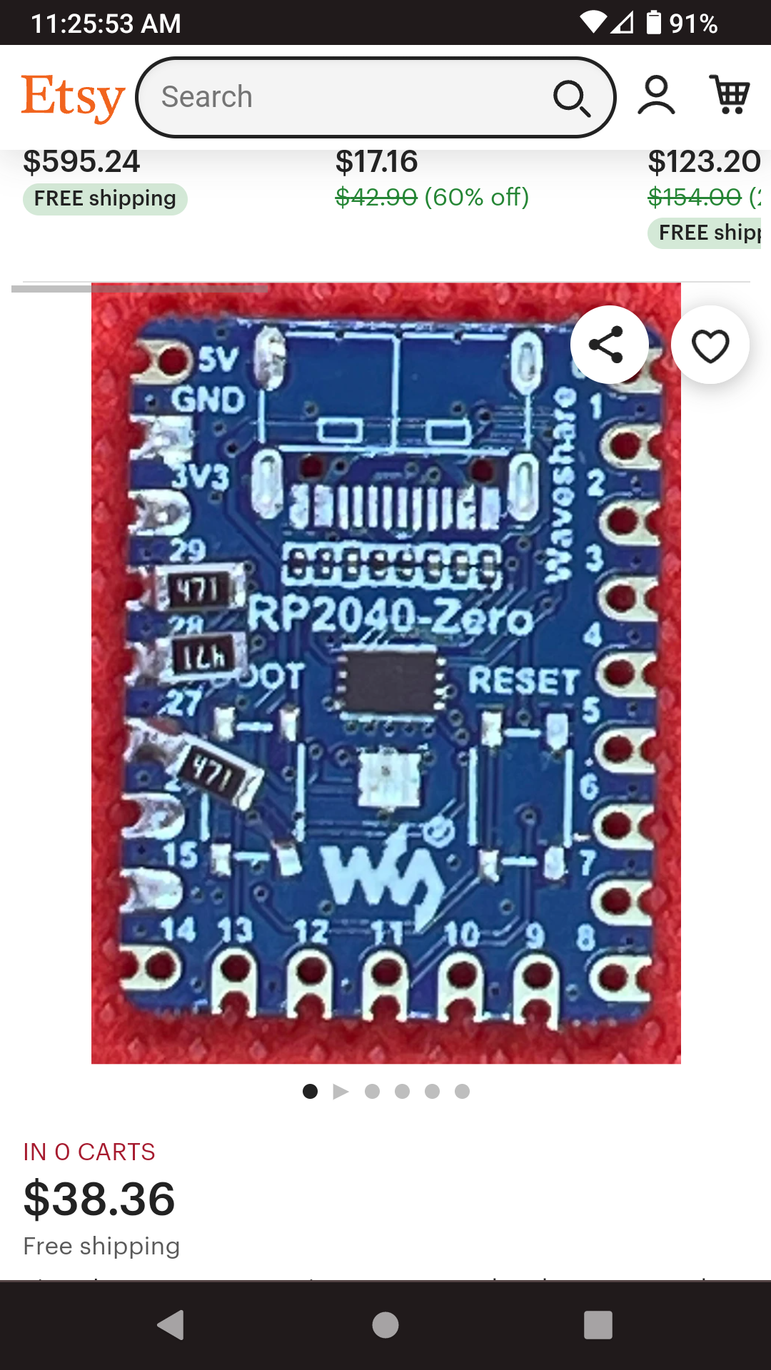

Alright, which one of you chucklef*@#s is selling pre-flashed picoflys on Etsy with the wrong size resistors? (SwitchModService in Plymouth UK according to the etsy listing)View attachment 378090
Good Lord. What has the world come to. Not even the intellectual capacity to use the correct value resistors. Mind boggling stuff. How do we smite this fool @lightninjay and who do you think it is?
I dunno about smite, but I messaged them on Etsy to correct them, so hopefully nobody dumb enough to pay that price for a picofly gets one, attempts an install, corrupts their eMMC, and then comes to cry about it here.
40 dollars literally will buy 10 of the new RP2040-Tiny board, and they don't require any prep...
