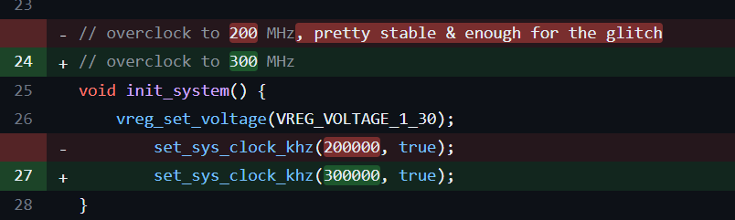

Actually been thinking about it, why some pico board just cannot glitch or direct bsod.
But if we replace the pico then suddenly it can work.
Maybe this happen because now we set the pico clock to 300mhz.. i dont remember what clock before that (it seems 200mhz).
Also maybe with this high oc some board just cannot reach that clock then failed to function (or maybe theres a rollback on the code?? so its kinda no issue??).
Not yet tried to custom build the firmware myself.
Anyone have insight on this.?

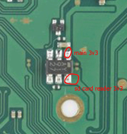

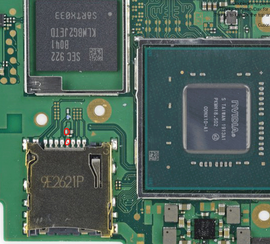

@deeps @QuiTim Are there any other alternative point for gnd and 3.3v point on Lite? 2 point on V6 guide is a little bit far for me, Thank you.
gnd you can get basically anywhere, like one of the outer legs of the sd card reader. see pic for 3v3
edit: do not use this 3v3 point, it seems to cause problems.

I dont think its save using that 3.3v
says who? hwfly lite uses that point
edit: I found your discussion on the subject, but never saw any reports whether changing 3v3 point fixed the issue, or even if others with similar issue were using the same 3v3 point
But from the point side its just the same 3.3v in another line.
it's not actually. the sd card reader 3v3 isn't directly connected to the other 3v3 points. it is sourced through this chip (see attachment). googling ay9127 gives nothing. not sure what it does

https://gbatemp.net/threads/picofly-a-hwfly-switch-modchip.622701/post-10156012
From the guy that use that point, he said its solved. But its only one confirmation, it might be that his microsd power line troubled even before the picofly installation. I am just taking it note, if hwfly did really use that point.
thanks! the videos in that post certainly make it look like there isn't enough power available on that 3v3 rail to power both the sd card and the picofly. as i said it's not the same 3v3 source as the other points, see post above
I think the 300mhz is when you connect sda and slc but i need to see the code
Reactions: Dee87
It's worth a shot - but unlikely. IMHO I think the 3V3 line is more likely - perhaps low current on the line causing issues through the system. Has anyone got reference voltage & current values?
