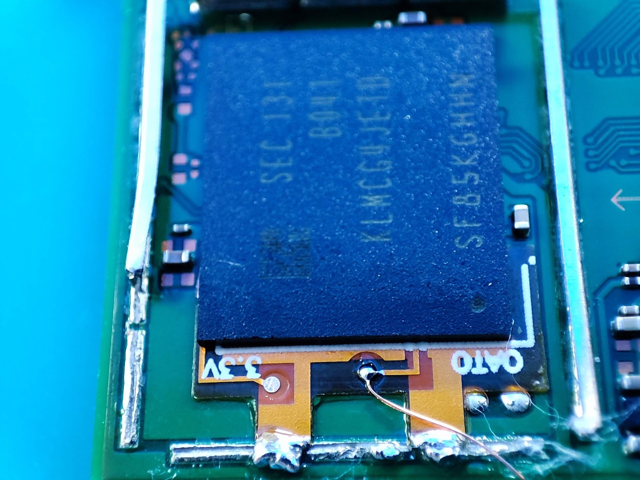

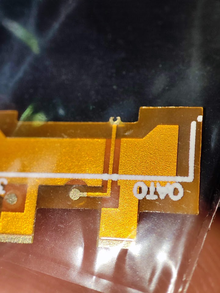

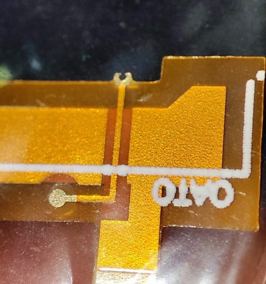

Hi guys, quick question about an OLED RP2040-zero install. Everything seems to be fine, diode mode test gives good values, but on boot I get =* (no dat0) and it goes directly to OFW. dat0 shows continuity to the RP2040 with good values though...
The supplier I used sent a janky OATO flex for the emmc and when installed, it is offset to the right and the contact point seems to have a really bad shape but does seem to contact the correct pin. Could it be a bad dat0 contact, or is there a possibility for another issue? I have the 4 anchor point dat0 on it's way but if there's anything else to check before swapping the adaptors I'm open for ideas.

=* means the pico doesn't read the voltage in the range 1.6-2.0v
So i am sure there is disconnection somewhere on the dat0 line.
Maybe the 47ohms resistor burned?
Voltage from emmc? I checked the resistors, all read 48 still with no shorts. dat0 line shows a strong connection. No wiggle at all on the adaptor. Also, it stopped giving =* when I just checked and now gives =** (emmc initi failure).

If you know embedded, this code simply check the voltage. The =* error is simply the rp2040 read the gpio pin on dat0 voltage and is not around 1.8 +- 0.2V.
=** is different error. The d0 voltage check are passed means it connected. This could be lot of scenario. I am not focused now, afraid giving wrong analyze.
If you said is true, when you check the error change from =* to =** then the connection on your d0 line is unstablle. Please make sure its okay first (before connecting power or turn it on). Because one mistake in there could corrupt your emmc, which lead to blue screen or black screen which will be very difficult to analyze and solved.
Just cheap analyze (i am not thourough in here), initialization error means that that rp2040 couldn't read emmc initialization activity in CMD line which supposed to be happening after a Reset. It could be the CMD line is unstable, or CLK line is unstable.
Hm, CMD and CLK are the two I have the most confidence in. Honestly, I think the 'OATO' adaptor is just bad and others have recommended avoiding it, the claw contact looks bad, and there's a high chance it's just not making good enough contact, which could result in the voltage error. So far, the board still boots into OFW so the emmc is still good.
I'll wait for the good DAT0 adaptor to arrive in a day or so and give that one a try and see how it turns out first. I don't want to have to remove the mask I put on the CLK point.

It could be a short on dat0, in my experience if the adapter makes a short under emmc it still gives the correct diode value. I would cut the left side of the dat0 adapter (like abal1000x did earlier) or just wait for the good one.
Just check the photo and you will see why this is possible
Yeah the old one isn't viable now, one of the ground 'legs' tore when I tried to desolder it to make the change :D The newer 4 anchor point one is hitting my mailbox any day now so I'll just use that. Thanks!
