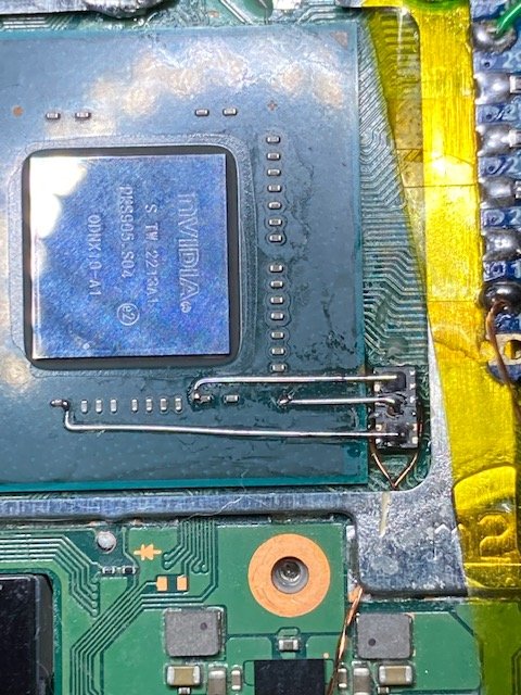

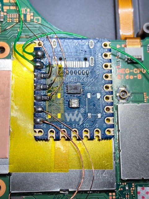

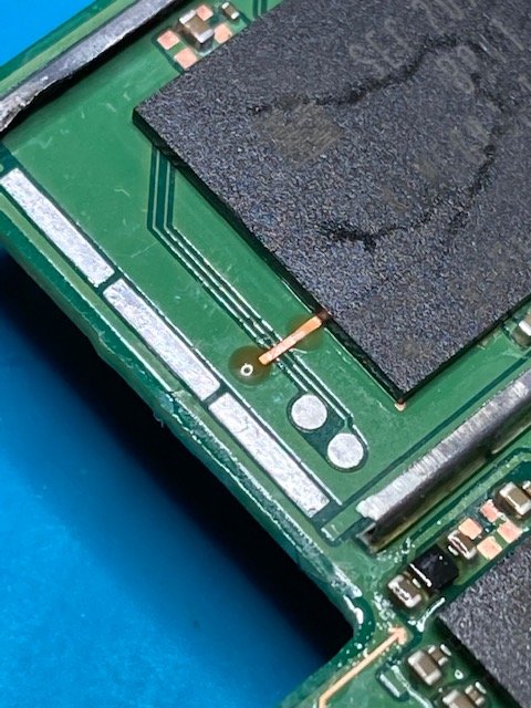

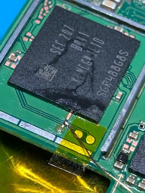

Thank you so very much @abal1000x for helping me diagnose the corrupt emmc black screen.
I resoldered everything including a permanent dat0 adapter and not only did this fix it, but it boots INSTANTLY
View attachment 377111View attachment 377112View attachment 377113View attachment 377114
Hey bro the installation is neat, where did you get the tiny copper thing for Dat 0 > B-)B-)
