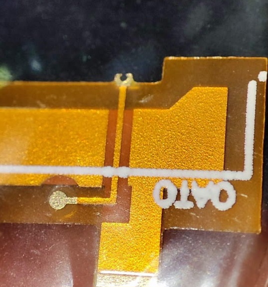

@k28 you are used to previous hwlfy mod chips (when they used to sell the good dat0) and you probably did not think to check/inspect the ones that are shipping now. Check the photo for the difference

Can somebody recomment me a seller that sells the good ones? I always end up getting the bad ones.
I think right now everyone has these bad ones. Still can't find a reliable one form Ali.
There is one member here that made some custom ones, they have good contact point but no anchors so you need to use solder mask/glue to fix them on place.

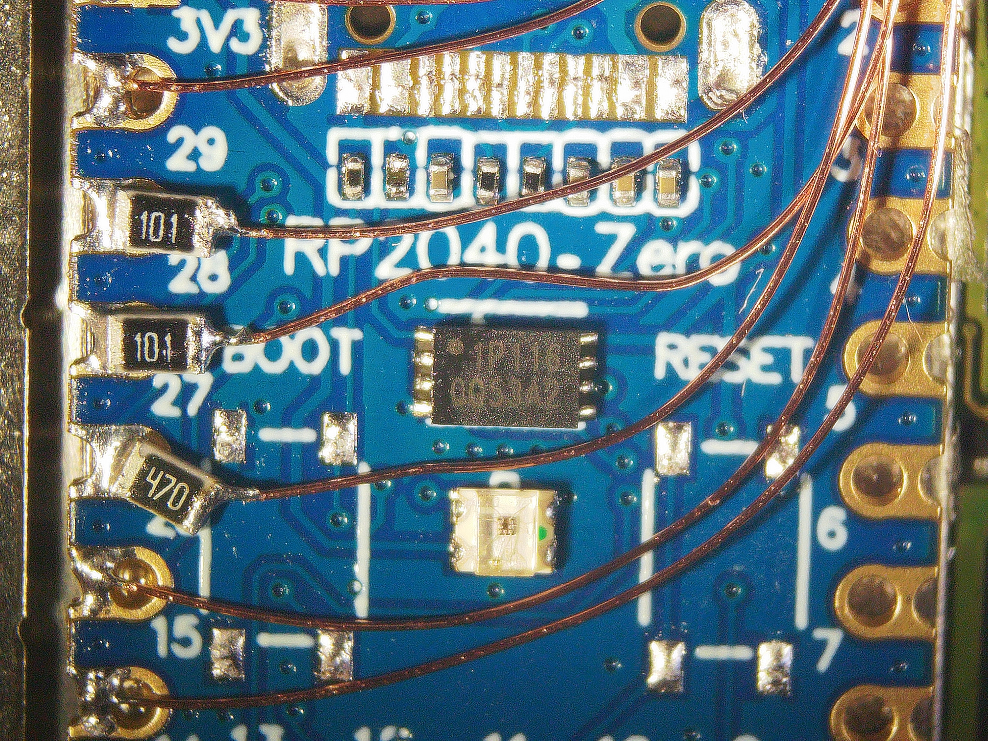

does anyone know what are the size of the SMD resistors pre-installed on the rp2040 zero/tiny?
Me and a few friends have been doing 100ohm installs on dat0/cmd lately. All switches have been working 100% in ofw, which is sometimes unstable or prone to corruption with 47ohm. I would recommend everyone to do the same. No reason to stick with 47ohm.
