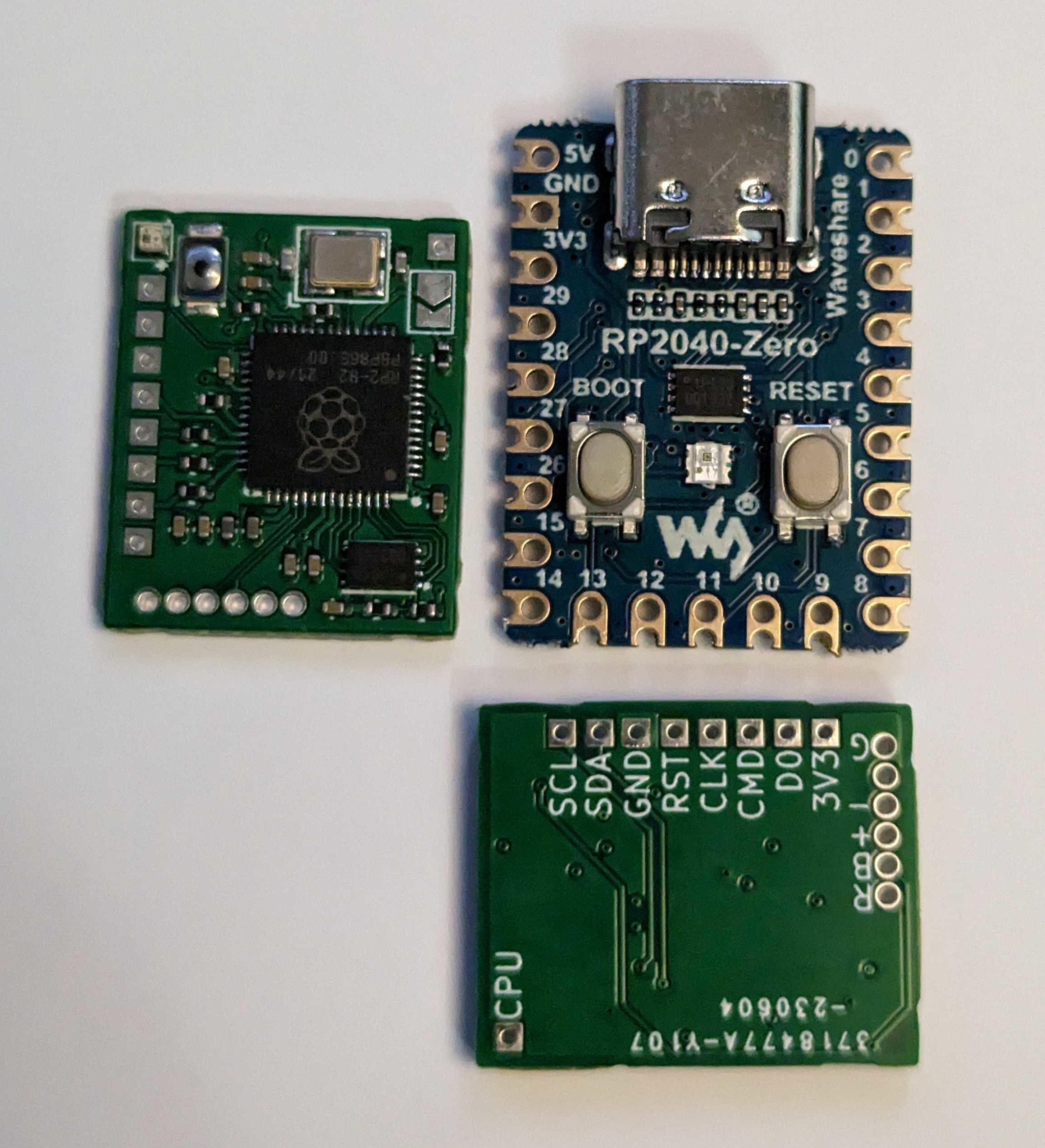

Thought I'd share here as many of you probably don't follow the mcfly thread... I've just finished testing my first batch of custom picofly boards (I'm calling it fly2040) and they work perfectly. The design is in KiCad and completely open-source.
Some benefits are:
  • Smaller than the tiny - it's 15.56mm x 18.97mm
  • Does not have a 5V -> 3.3V regulator on board.
  • Does not have a USB connector to remove.
  • Does have an on board boot button that's so small it doesn't need to be removed.
  • Has a solder jumper for an optional pull down resistor on the CPU pad (10K).
  • Has 3x 47 Ohm resistors for CLK, CMD, D0
  • Designed to be programmed with 1.27mm pogo pins clip.
  • Easily ordered from JLCPCB with assembly (JLC parts).
https://github.com/floxcap/fly2040/tree/main/pcb/fly2040_min
fly2040 (front/back) next to a zero:
Great work. I'm gonna go ahead a try to figure out how to order a couple of these from JLCPCb.
Thank you for sharing this
Reactions: floxcap

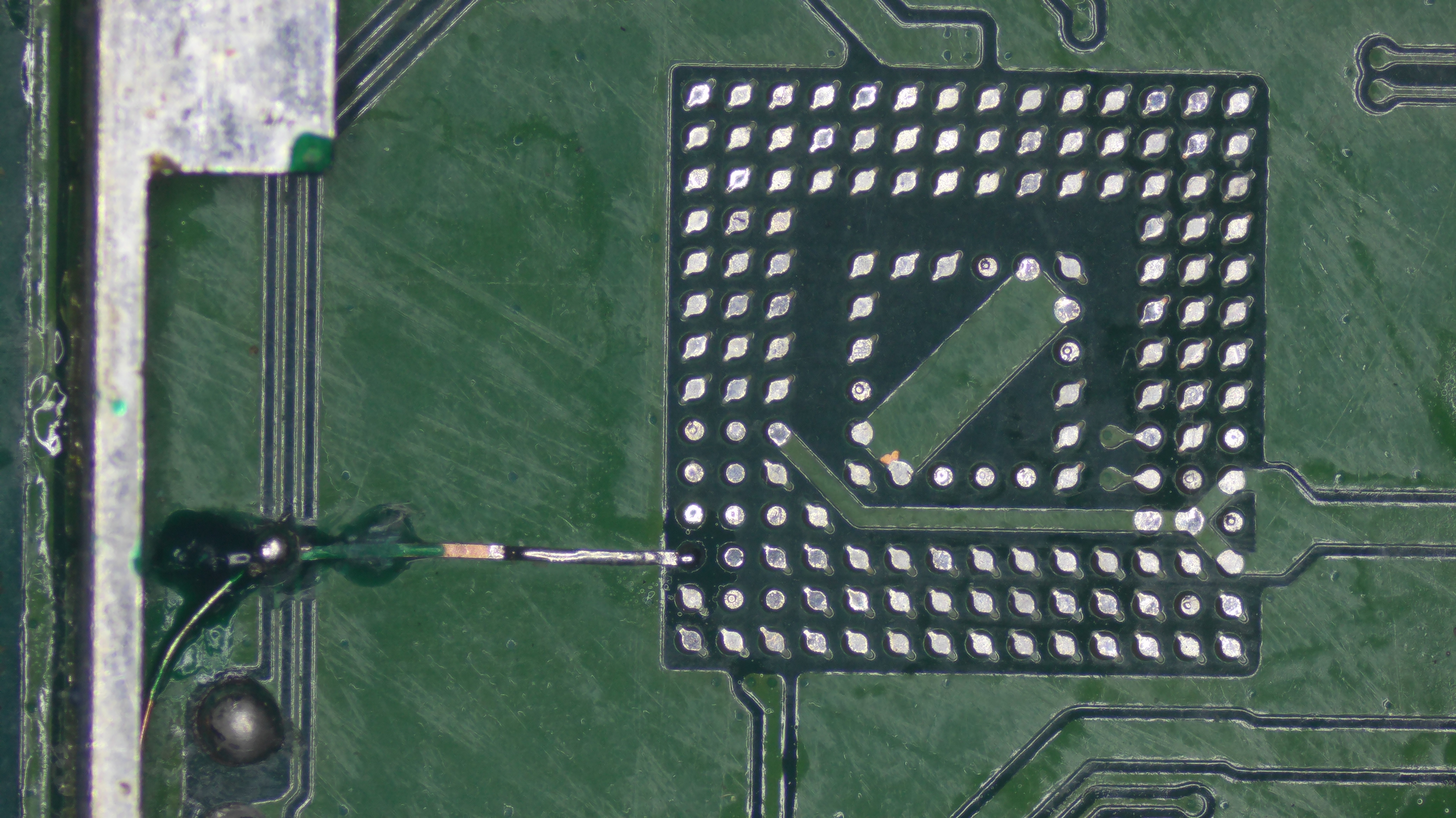

hi guys im installing picofly in v1 patched switch. im having issues with soldering the soldering dosent stick to the motherboard of switch especially those rst dat etc points..i soldered v1 cable 34 points to connect to cpu it worked fine .i tried on dead mobile board and soldering is sticking normal no issue .only switch motherboard is causing this issue....im also using flux ..can you guys suggest what might be causing this? ??any suggession will be highly appretiated regards

He use dat0 adapter same that i was add pic before. And it is not bridge how that work with him perfect job.
It appears as though they are intentionally shifting the adapter to the side which includes a pin that is hooked to nothing. This was discussed as a potential option earlier in the thread, but is still a messy and unreliable option.
Either get a better adapter, or set a permanent DAT0, as @Dee87 frequently suggests. But do NOT install shitty OATO adapters and then ask here why things aren't working, when you likely shorted the DAT0 on your/your customer's OLED and now have a headache of a recovery process ahead of you.
