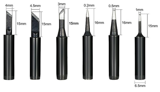

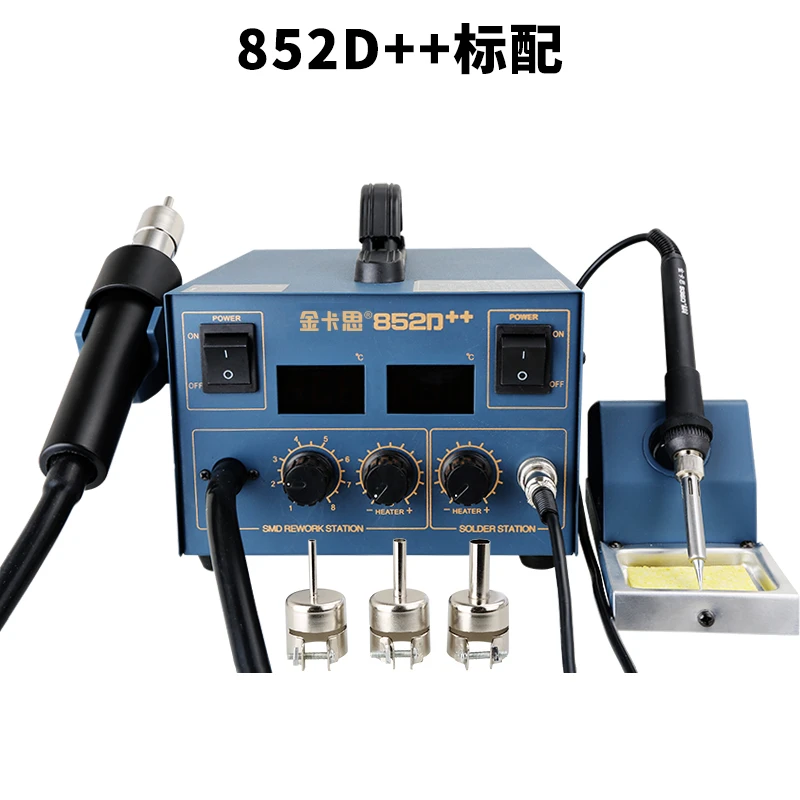

From these i would go with 0.2mm. What kind of soldering iron do you have?
I use a JYD 852 D
This one uses 900m tips and Ersa original ones.
I would not save on a tip because this is a very critical point in doing this mod.
Having a good temperature controll and ability of the tip to hold solder is crucial for this mod (from my point of view).
I would go with J type or K, 0.1mm or 0.2mm for soldering lines on switch pcb. For Pico you can use a larger one if you like.
Get a good quality one.

Thanks for the advice, i'll look into some good j/K type tips.
Just in case they're out of my budget, would the one i showed you earlier do the job?

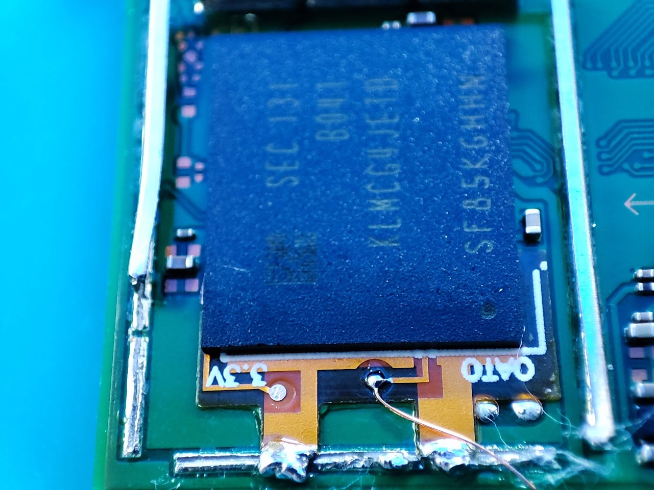

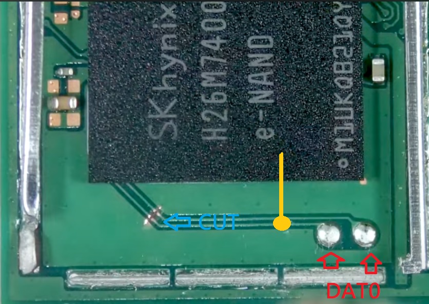

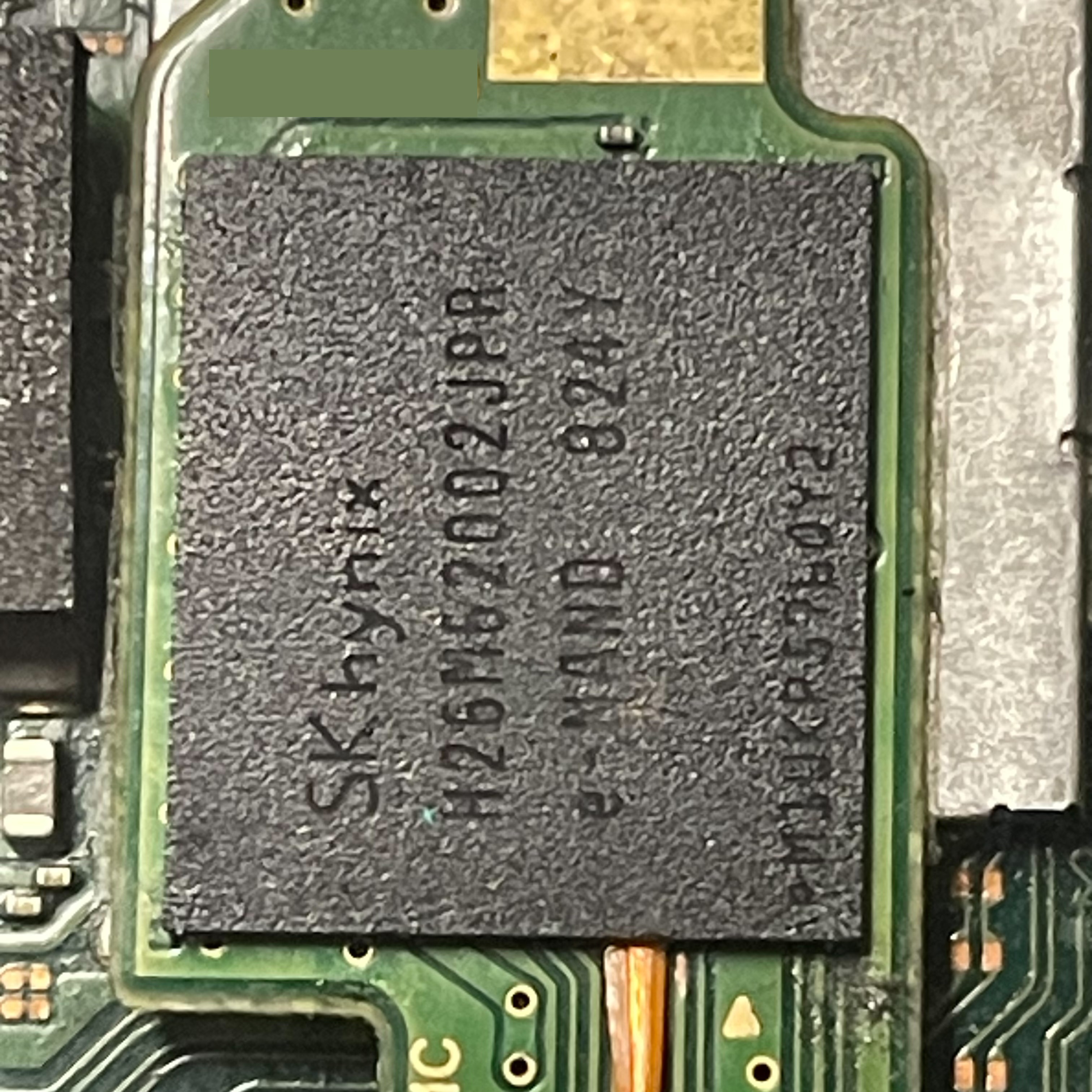

The OATO strikes again. If you go back a page, I have almost the same issue as you using this adaptor. I've pulled it, and I'm waiting for the more recommended 4 anchor 'DAT0' adaptor to arrive instead. It seems like it's shorting on contact. You could try cutting it as others have shown earlier.
Yeah sure, that 0.2 should be OK, It's just that I find using curved tip a bit easier on this mod.
I find chisel shaped round tips to work really well and give versatility when working. Curved tips too because solder doesn't like to gather on the point of sharp tips. You'll also need an iron that can hold temp very well as the smaller the tip, the easier it will transfer its heat, leaving you with a cold tip welded to hard solder while waiting for the iron to heat up again. In a worst case scenario, your iron won't be able to heat the tip quick enough and the board will leach the heat out, resulting in burned components or a torn trace.
i've found this 2mm one, thoughts?
Thanks for the advice, would this be a suitable chisel tip?
Reactions: Danook28 and QuiTim

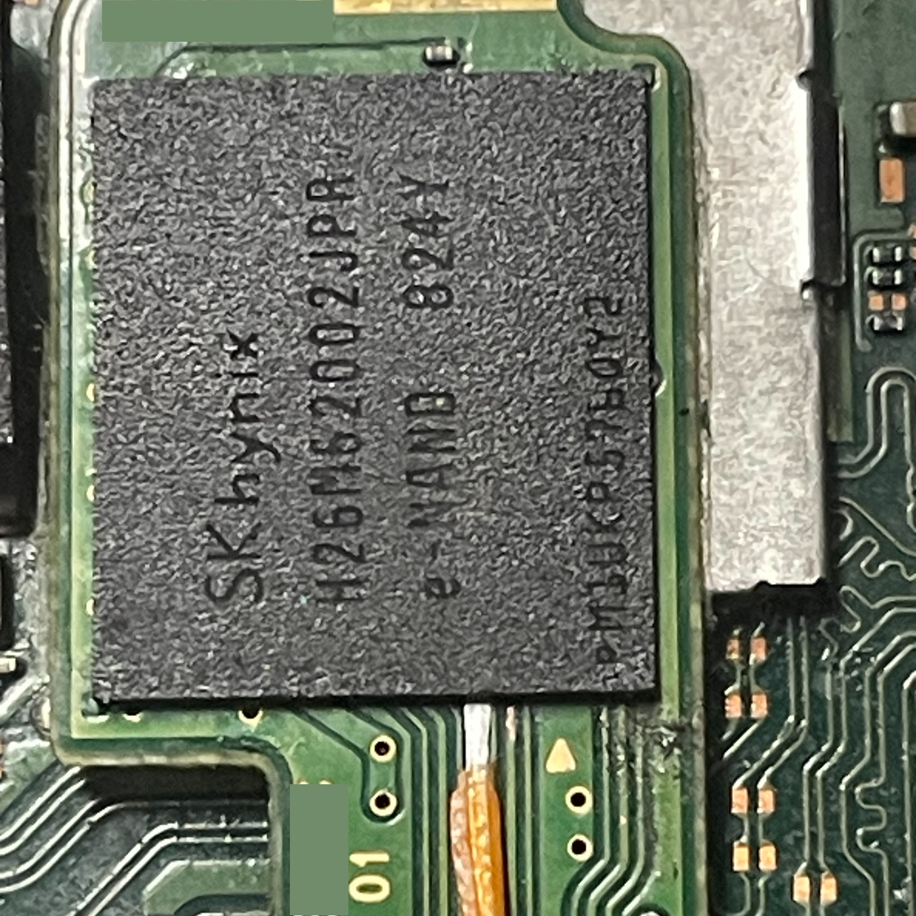

Personal Simple idea I don’t know if it’s possible to use it on the OLED version AWD30 OK cable (squeezed) Insert EMMC DAT0 address Use PCB circuit Fixed No entity Experiment just personal idea

learn reballing :-) hahahahahaha i know u guys probaly start hating my reballing comments Xd
Do you think that this solder paste is ok for reballing the emmc?
