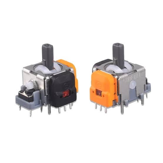

Hi! I don't know if someone already did it but I've tried it myself. Sometime ago i've started a bit of study and tests with hall effect sticks for the gamepad. The nearest working was a PS4 model. The horizontal axis worked while the vertical one kept dead. So i noticed that stick uses two different sensors and today i had an idea: why not trying changing the vertical sensor to the same one that worked with the horizontal axis? And now we have a 100% working hall effect stick for the gamepad!. It's still on tests but you can see for yourself.

Until now the only "collateral symptom" i've found is the inverted axis when i fully turn left or down running vwii games. Something like that usually happens when we replace the analogic stick for bad quality ones. Worked perfectly with Nintendont.

So you used PS4 compatible stick for this? I wanted for a long time something like this, my pad stick are getting loose after all this years
Yes. I've bought another pair to make the right stick. They are the same of this pic but only the black sensor works. What i did was changing the orange sensor for another black and solder the stick into the gamepad stick's board.

The new pair just arrived. The black sensor is what we're looking for. It reads "R - 5 B" Tomorrow i will install into the gamepad's right stick place and test the results.
