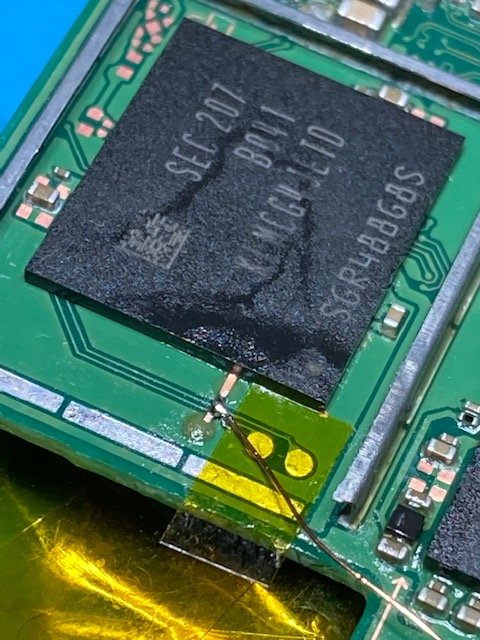

The best one using 0.3mm, fast glitching, smooth, but its difficult to solder, and need to kapton tape, because when the shield closed, always failed similar with your cases. Try 0.1mm didn't work. Try 0.2mm work, but not good enough. All using single line. The last one, use double line (U-shaped), seems stable. I playing games while heat, then reboot the glitch still works (3-4 seconds).

Is the wire enameled? Is that what you’re using for the other points as well?

All enameled.
For other than mosfet, use 0.1mm enameled (including the 3.3V and GND). Using flex in the mosfet is the safest method. The reason using 0.1mm is to reduce the probability of the pad on the pcb ripped. Small diameter, small mechanical force its exerted, when accidentally pulled.
The GND is risky to take off, so if you want to be more secure, connect 2 gnd point to the picofly, for precaution. If the GND disconnected, then the G supplied to the mosfet is unexpected. The same with the CMD/CLK/D0 that goes to the emmc. The worst case scenario, emmc, cpu, and the pico burned.
Enameled is difficult, need to kapton tape to make sure its not short circuit.
If you want to be easier just use the isolated one, around 34awg.
I use enameled because its cheap. I don't use flex because its cheaper using copper. But this required the person to be experienced on micro soldering.
Great thank you for all the info. I wanted to let you know I pulled the flex out of that switch lite and installed a single mosfet. Works flawlessly. I used 0.1 enameled wire, looped, and twisted together. I was so excited I forgot to take a pic. Will take one tomorrow. I did have to instal SDA and SCL but that seems like every time I install a pico. Maybe it’s the 0.1 wire. Anyways. It’s up and running which is amazing!

So the culprit is the flex after all?
there are a few good distrubitors of the flex cable but there are also alot ones who send out trash cables , we have seen alot of people having issues.
after installing mosfets without flex the issue where gone.
its the same with those crappy dat0 adapters.
so like i say use mosfets and save that money u pay and waiting time for the flex and be done with it
