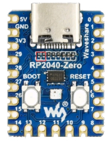

Hello guys! I accidentally remove and lost 2 of the resistor near the USB port pins of the rp2040 while removing the USB port. Do i need to buy a new rp2040 or will this one still work?
Which ones exactly did you lose? If it's truly the resistors on the USB lines (there are 2, 5.1k resistors to trigger the USB-C protocol), and you are already done flashing your firmware, no foul.
However, there are also capacitors near those resistors, and you may have swept those off instead. I would say try plugging in the rp2040 to power to try and see if it blinks, but you've removed the port. You could solder a temporary usb plug to the pins and power it from USB if you feel confident enough to do that.
Solder Black to pin 1, and Red to pin 2 and that should work for checking if you need to replace those resistors/caps (or buy a new board), or if everything will work.
the 2 of those got lost by me accidentaly.
View attachment 365239the 2 of those got lost by me accidentaly.
One of those is typically unpopulated anyway, so that's fine, and the other also seems irrelevant to anything but the USB.
Thanks. I already flashed it before removing the usb port. I tried the pin 1 black and pin 2 red but the rp2040 did not power on. Then I tried the red and black on the usb pins then plugged it on my laptop and it has blue led light then flashed purple. I guess I can still use this rp2040 right?
