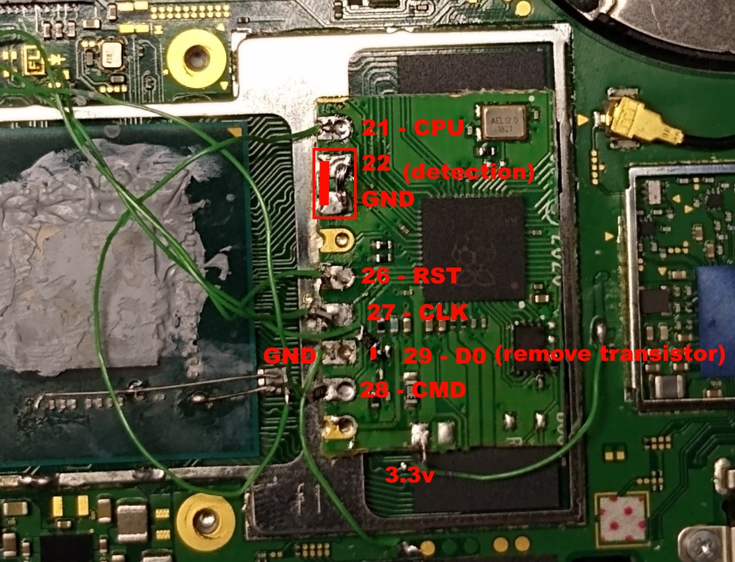

I followed the instructions and successfully installed in some lites, but this one lite goes boot then pink then out of whim i try to connect it in my pc to find out it goes rcm. I flashed it properly. I even changed rp2040 i thought it is just faulty.

LED must be RED after USB write. if you see green, set "RGB mode" jumper
WHITE = eMMC write
BLUE = glitch
PURPLE = eMMC boot failure, check CMD / CLK
YELLOW = eMMC write failure, check D0 / unsupported eMMC
CYAN = no reaction to glitch, check mosfet wire
GREEN = success
Check your CMD/CLK since you got purple light.

I did clean flux again, change picofly, check shorts and continuity but it still acts up.

I forgot to take a pic of the mosfet install before closing it up, sorry. However it looks very much like the one rehius posted, except mine is messier: https://gbatemp.net/attachments/rpico-jpg.364817/
I accidentally used different wires for the points - 30AWG for the S/ground wire, 34AWG for the D/cap wire and 34AWG for the G/cpu wire.

One OLED I worked on kept giving me purple. I quadrupled my CMD and CLK. Both were good. I decided to re-solder everything and noticed that the APU caps were not soldered correctly into the flex cable. I resoldered them and it worked. I kept wondering why was it not giving a Cyan color? Since that's the CPU color. Any idea?

Im not sure if it apply to flex cable as it apply to mosfet.
