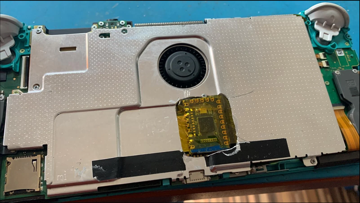

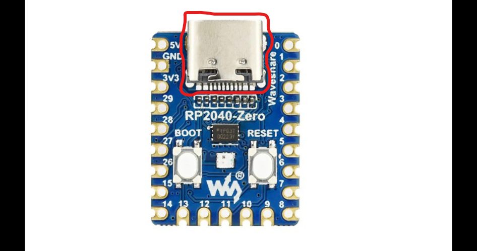

if i cut hole like this
and fit rp2040 without removing the usb c , is it goin fit?
No. See attached pic - i've placed a ruler on top of the side supports, which is where the back of the case rests so it is the same height as the case. there's a rp2040-zero with connectors removed (under the kapton tape) and a rp2040 unmodified in the pic. As you can see the USB connector is far too tall.

It does not fit without causing strain and a bulge in the case.

I just modded a lite with a rp2040-zero and single mosfet, worked perfectly first time. My reflections are:
- attaching mosfet directly to the cap is not a good idea. the mosfet is taller than the apu and will lead to bad thermal conductivity since the shield will cover both apu and mosfet. I put the mosfet in the space between apu and ram.
- Soldering mosfet to caps (with or without wire) is hard as hell. By far the hardest part of the mod. Absolutely not worth the extra time it takes over buying the ribbon cable.
- There is no way to fit a 2040-zero under the full body heat shield, even if connector and buttons are removed. If someone claims they did then their heat shield is bent to hell and will cause a bulge in the housing. A hole in the shield is necessary.
- single mosfet attached by wire to single cap seems to work fine.
- working with solder mask is messy and spreads everywhere unless dried enough. Maybe it's just my shitty aliexpress product though.
