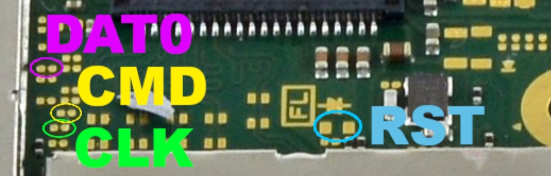

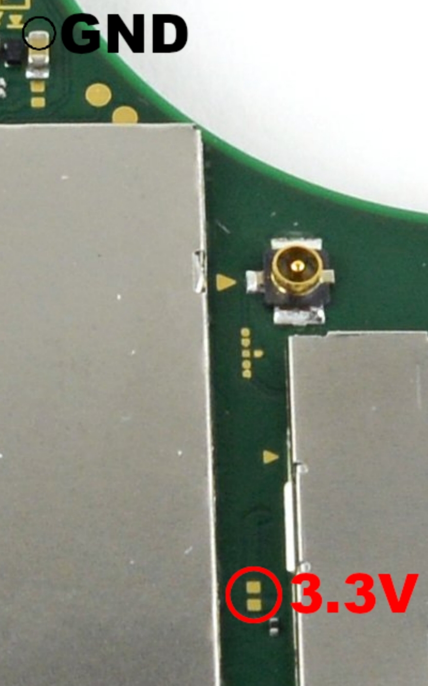

hello everyone, sorry for my english.
I have a few doubts.
I have a lite, the picofly uses the same points as hwfly, because I have seen in the images that you don't get the 3.3v from the same place or is it an alternative point and if so, should it be bridged?
another would be that in the capture of hwfly a point is used but in yours you mark two points with a circle that must be joined or choose one of the two?
RST is ONLY the LEFT square point(in that cyan circle)
either one, they all work in pair(interconnected)

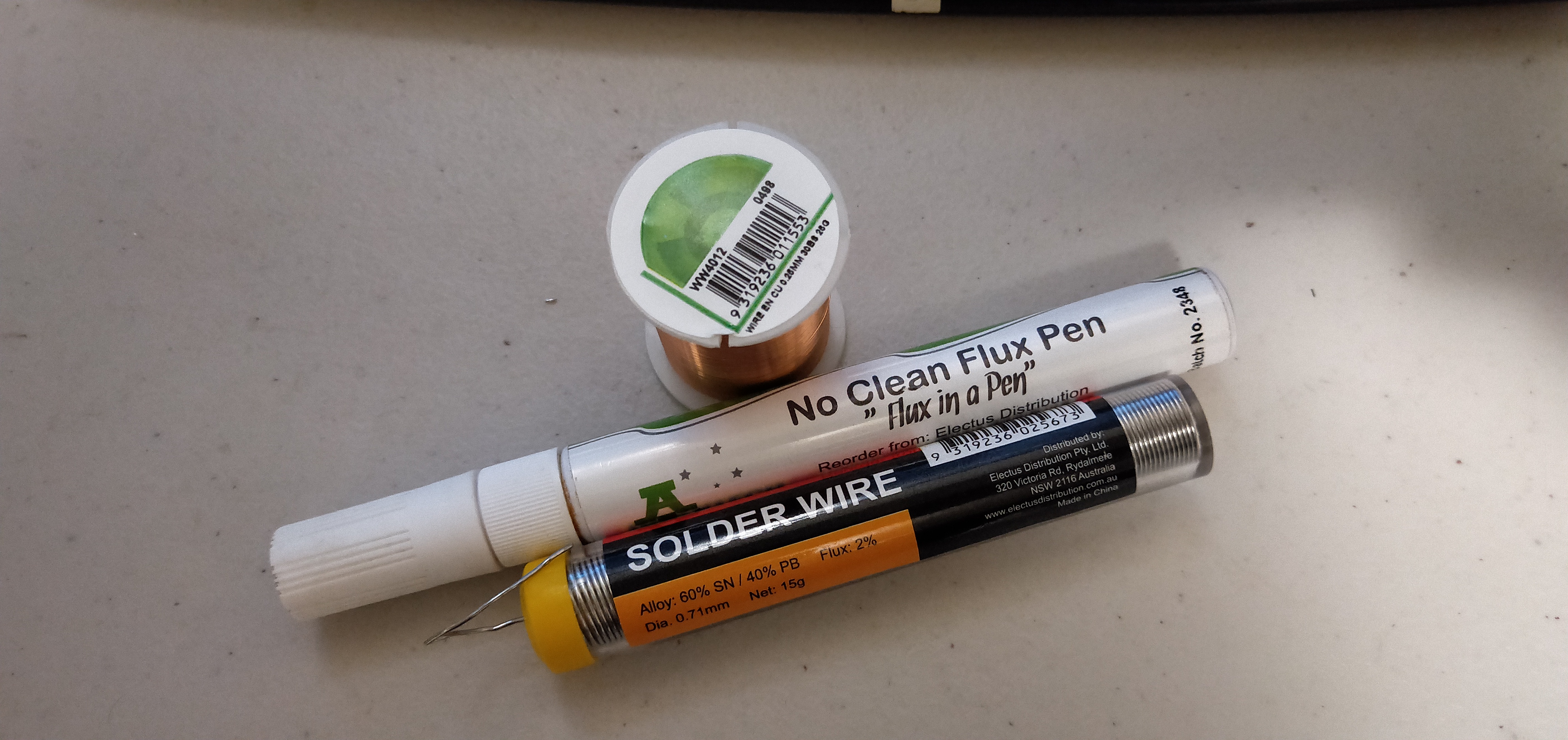

I smell jaycar no clean flux
Edit and solder ;)
