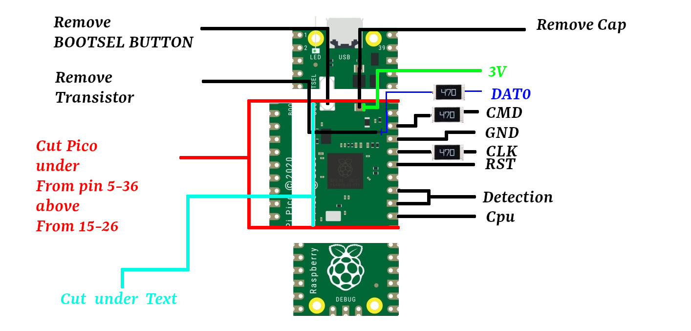

but only remove them after u succesfully tested them switch with a 2.6+ firmware otherwise if u have issues u will have to resolder
here is an update pinout and cutting guide for the raspi pico
have fun
have fun
Oh God cutting up a pico surely easier just to use a 2040 zero
