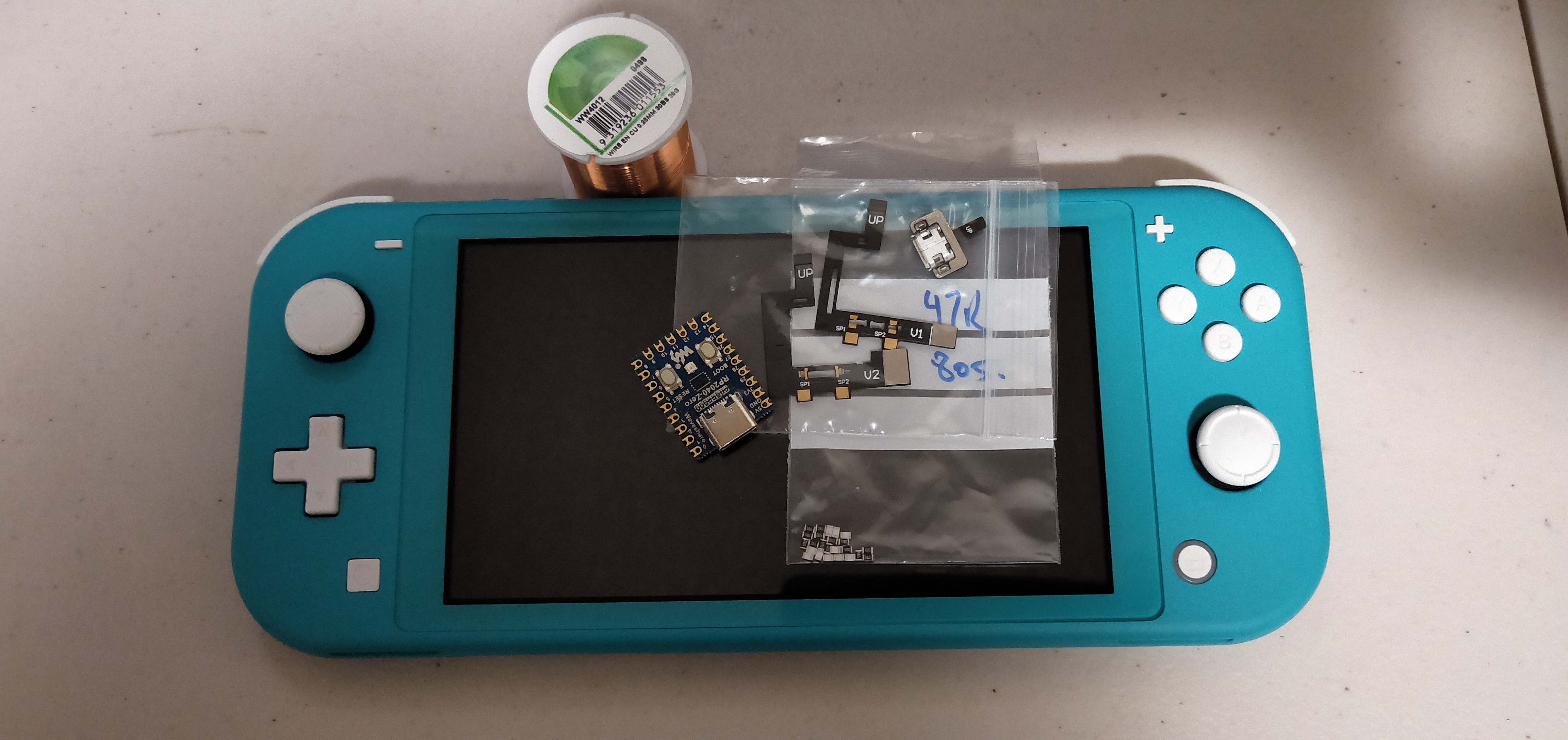

...oops! forgot to include it in the pic ๐Ÿ˜…
..this is only what i got on hand..
Best of luck, mate!
If you find it too difficult with the thick solder wire, try getting something like 0.25. I find it much easier to work with (less bridging etc).
And if you find it too difficult with the 0.2mm magnet wire, then going to 0.1mm might make it easier still. Although on lite it might be just fine.
And lastly, if the liquid flux burns off too quickly, then โ€œkingbo rma 218โ€ tacky flux from AliEx is decent. Not amtech, but decent.
