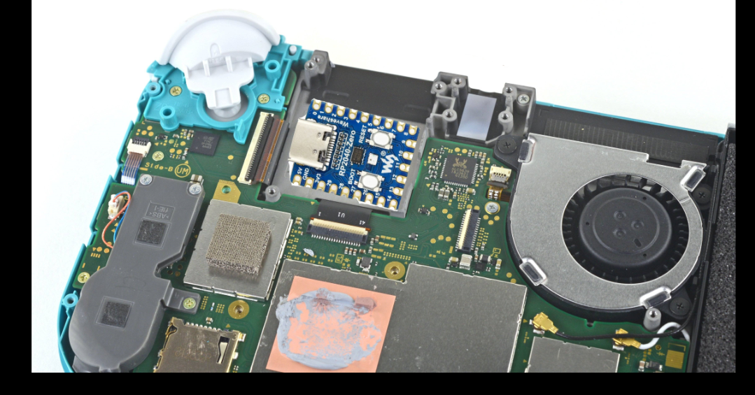

So how do you guys stick mosfet to the board and rp2040 to the shield?
Double sided tape? Kapton tape? Solder mask?
solder mask for the mosfet and a few layers of double sided tape on the sides of the 2040 to match the height of the chips on the board

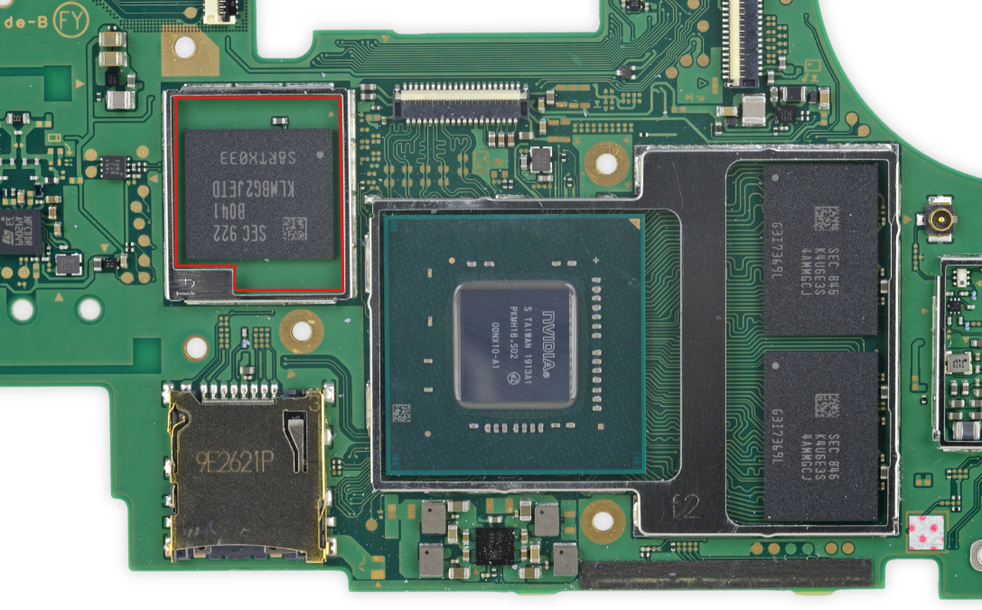

yeah im thinkin that too... emmc cover

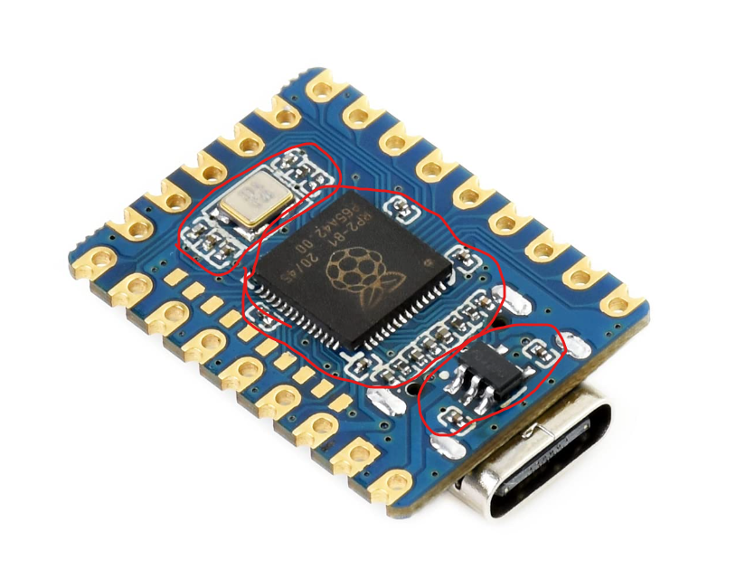

the rp2040 back side, gonna fit there? (kapton tape prepared)
those make rp2040 not flat T T
The smaller black chip marked in red (LDP?) is the tallest point on this side of the rp2040, and when mounting on top of the emmc shield it will stick out south of the emmc shield = not a problem. I'm measuring here with an opened switch lite and an rp2040 and it looks fine to me.

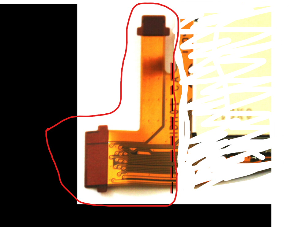

if we cut the cartridge reader, is it gonna still working? the audio jack ?
this position look fit, but sacrifice the cartridge reader... (rp2040zero sleep there)
this flex after cutting, only use for audio jack
work? or nay?
work? or nay?
if its anything like the 3ds, part of those traces will be needed to power on.
IDK just test with the whole flex remove for now?

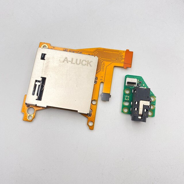

Simple question: I have a broken flex cable lying around. Is it possible to salvage the mosfet and use it on a standalone mosfet install?

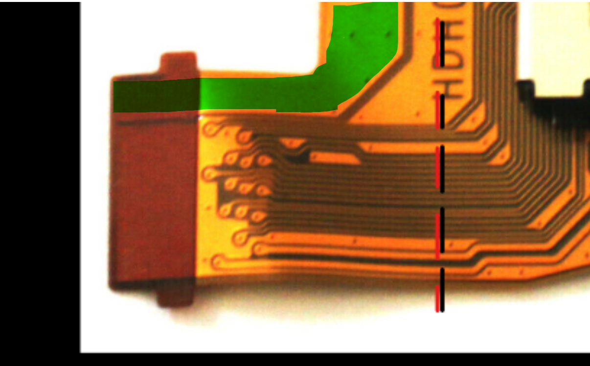

hmn... idk if it need power or not.
but my idea so, it only to make the audio jack workin, cuz on that image, you can see the layout audio and cartridge reader is different path.
green for audio jack path >
and it connect to jack PCB audio (see image)
but its only teori...
and sadly
i dont have extra cartridge reader...
maybe someone who have a broken cartridge reader can try , is the audio still workin

I mean like, just disconnect the flex from the motherboard, if it still powers on and works, then there is more of a chance of your idea working
i think i saw some videos people who try picofly without the flex, it still can power on.
minute 17:13
no cartridge reader plug
maybe speaker still workin. idk
if someday i have extra cartridge reader i can try.

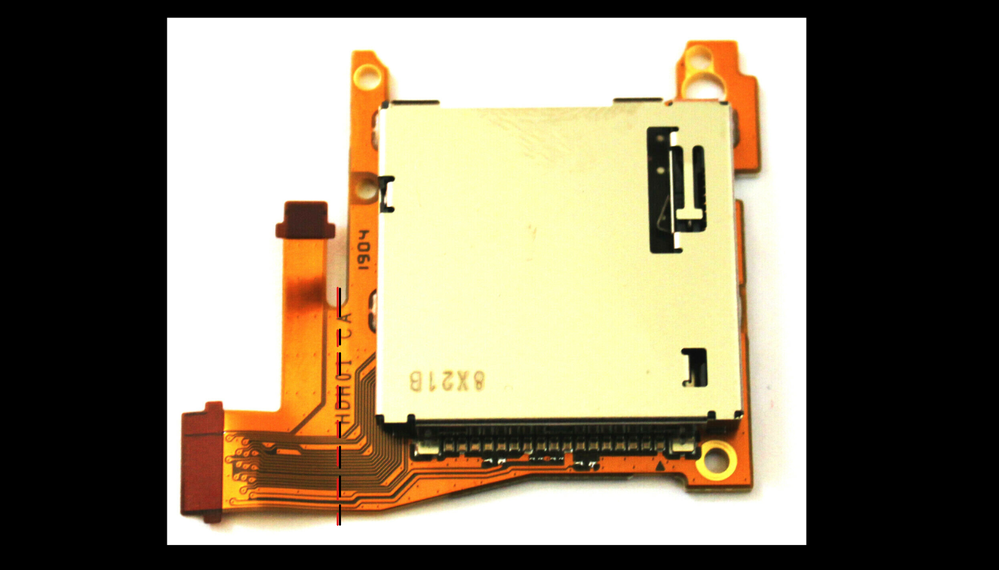

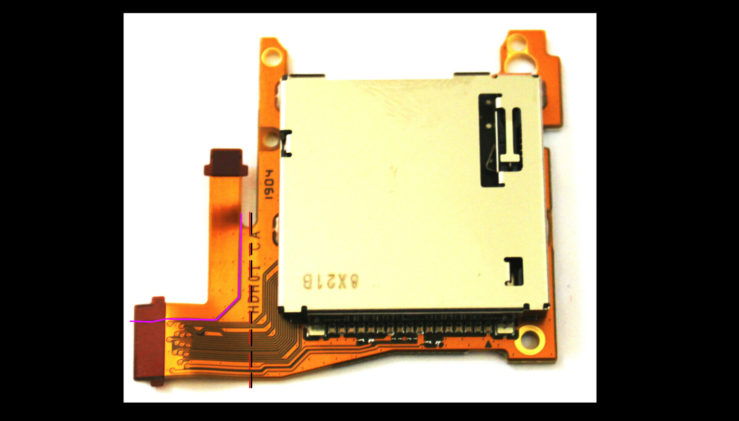

WARNING* this is only imagine question
ive been imagine this alternative...
(this only for people who only use digital games from eshop)
(warning this is only idea)

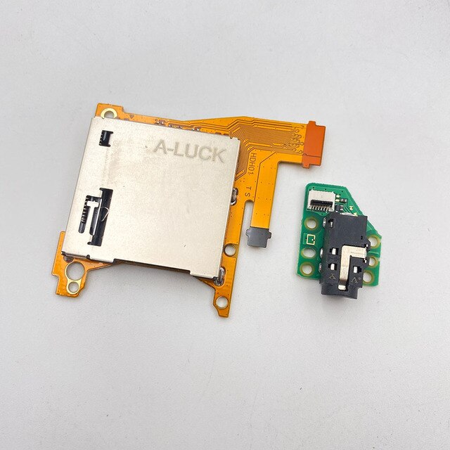

work? or nay?
If so, you don't need to sacrifice anything.

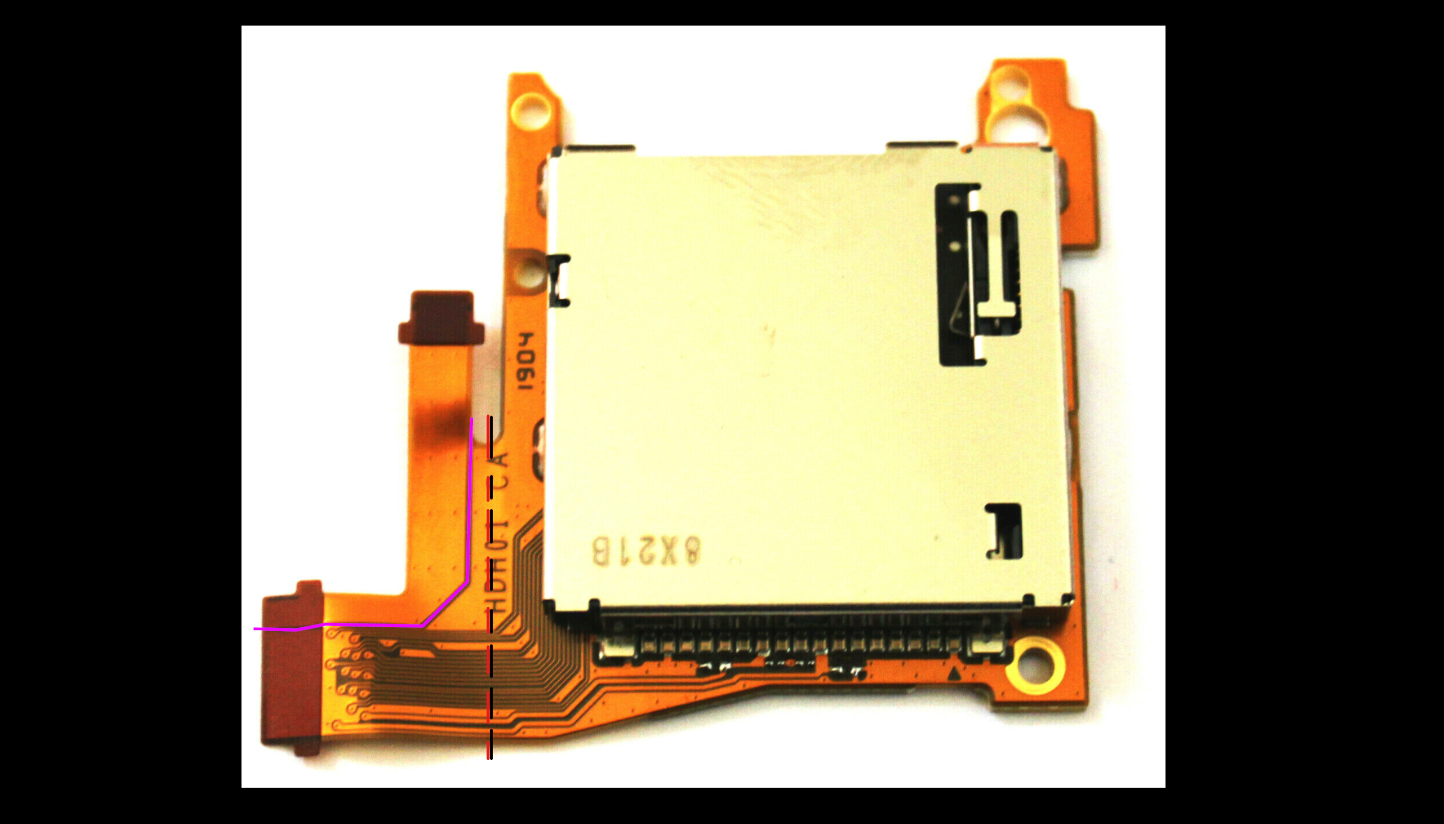

work? or nay?
If you cut right on the pink line with an exacto knife, you should theoretically be able to make a mini flex that will still work in the large flex receiver, you'll just need to align it before closing the flex connector's latch. That would only hook up the headphone jack and completely leave the Cartridge reader "off-the-hook" so-to-speak.
However, I see no reason for this mod, considering how cleanly the RP2040-zero can already be mounted with a little bit of planning.
Reactions: LogicalMadness
