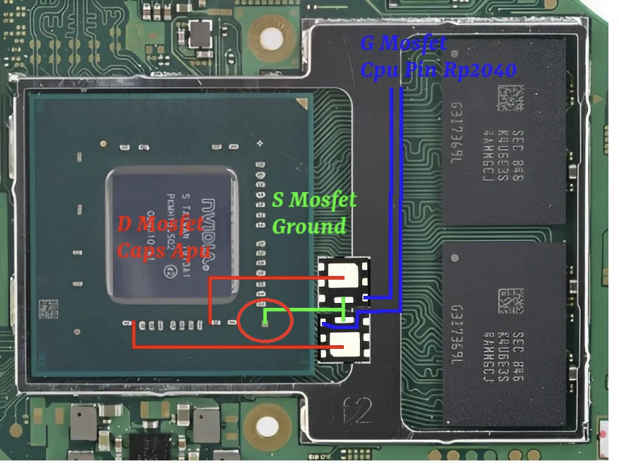

My MOSFET order got stuck on AliExpress. I got no use for this V1 Cable. Will remove the MOSFET and install it on Lite. Any tips on removing it? Hot air? direct solder iron? and Am I to expect the same pinout as in here? Thanks

Taking your time and being extra cautious. I like that philosophy. I'm in a different situation where I have V1 cable and a Lite. Will try to remove the MOSFET and install it directly.

On OLED flex I had two NP2016DR. If that's a case for you, remove it with hot air and here you can find a datasheet (pins look to be in the same place).
You rock! Thanks. The link you shared is for Sthetix's HATS install. I've seen that video. He didn't mention any MOSFETs, did he? Couldn't find any related links in the description too.

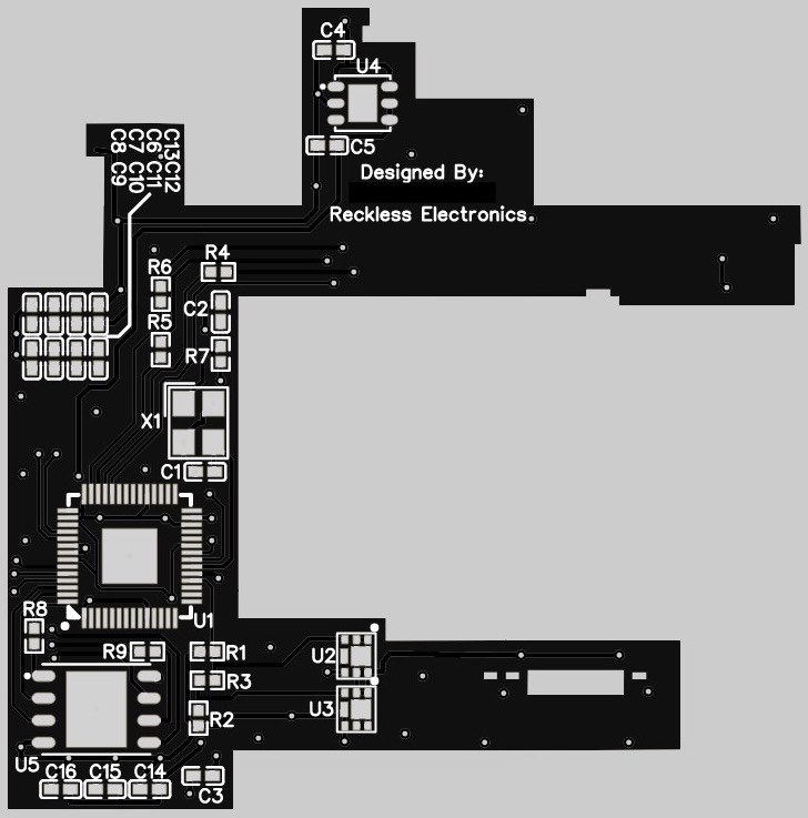

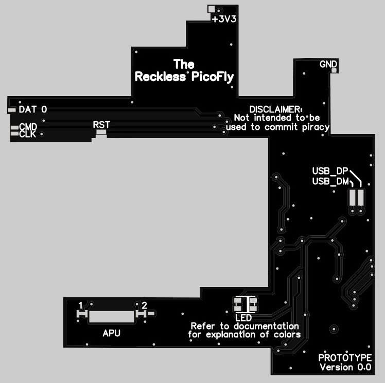

Not sure if anyone else has produced a design that is quick to solder on and nests inside the switch easier yet. I just finished this one today and it is intended to be a flexible PCB. It is just a prototype and will need some adjustments I'm sure, but I mapped the GPIOs the same as the original Waveshare board so I believe the original firmware will flash to this with no issue.
EDIT: I forgot to include that this is for the Lite. I don't have any other units to measure but once I verify functionality I would be willing to adapt the design and/or post the files needed to modify to fit other units.
Anyone interested in this thing?
Woooow now this is awesome .
Beautiful job !!!
Is this gone be open source or for sale?
I'm Very interested , hit me up
