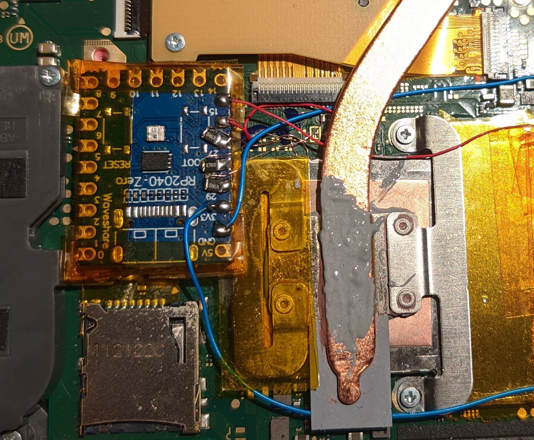

Just opened my Lite and moved the Pico from #1 to #2, and can confirm that on the #2 position it's a perfect fit, no need to cut the shield and has enough room to fit everything without extra pressure. Just make sure to insulate nicely the Pico (top, bottom and sides) with Kapton tape.
The only thing that I don't like about #2 position, are the longer wires for GND and +3.3V, but it works good anyway.

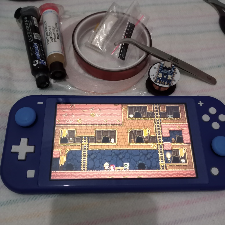

my RP2040zero just arrive!!!
all parts !! Assamble!!!:switch:
soon ill do the mosfet first... ill do no rush...
but before that let me spelunky run first ~ whip whip~!!
HONESTLY THEY ARE THE WIRES THAT MATTE
Honestly those wires matter least afaik
flash the latest firmware before anything ;)
