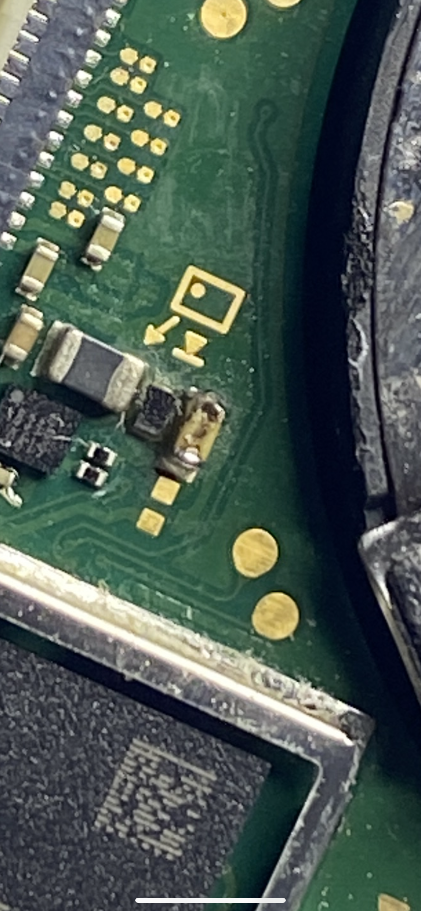

During the installation i damaged the switch, I found a damaged component, anyone knows what its parameters are ?

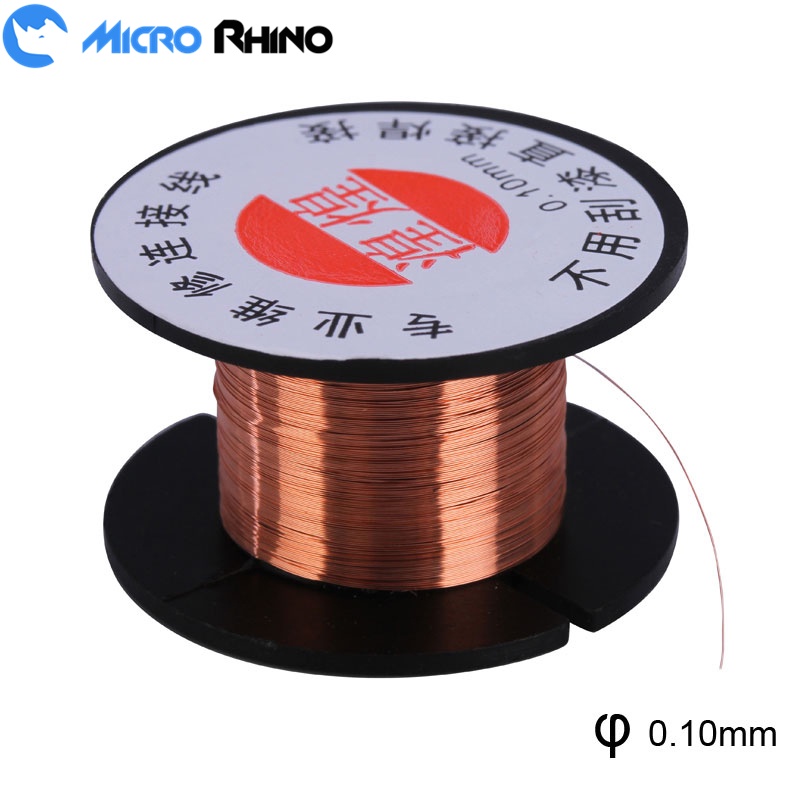

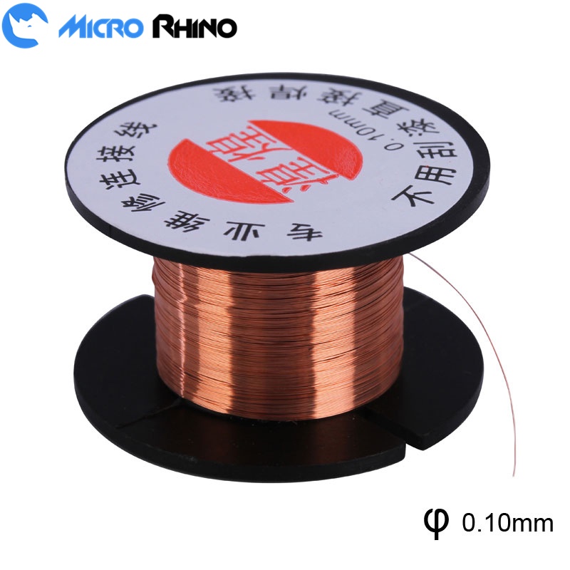

can someone confirm, is it ok to use 0.10mm enamel copper wire for all purpose ?
even the dual mosfet ?
We already talked about this... Use higher diameter for the capacitors of the APU (Drain) and for the Source of the MOSFET.
Can enamel thin wire work for APU MOSFET? Sure!
How long enamel will work? Hope forever, though for how long do you think that a such thin wire can support passing high currents over 10A on each powercycle of the console? Look for the long term, at least 0.2mm or higher for those connections, for the Gate the enamel is ok, since it's only triggering the transistor.
