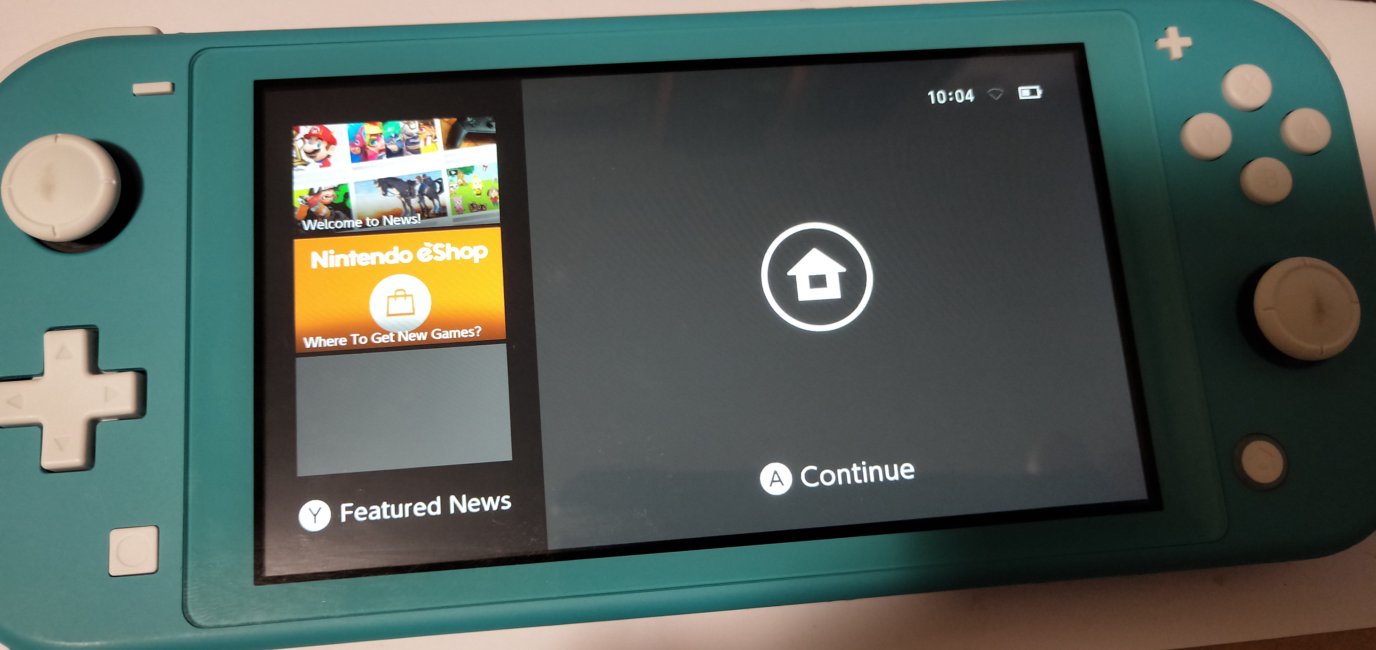

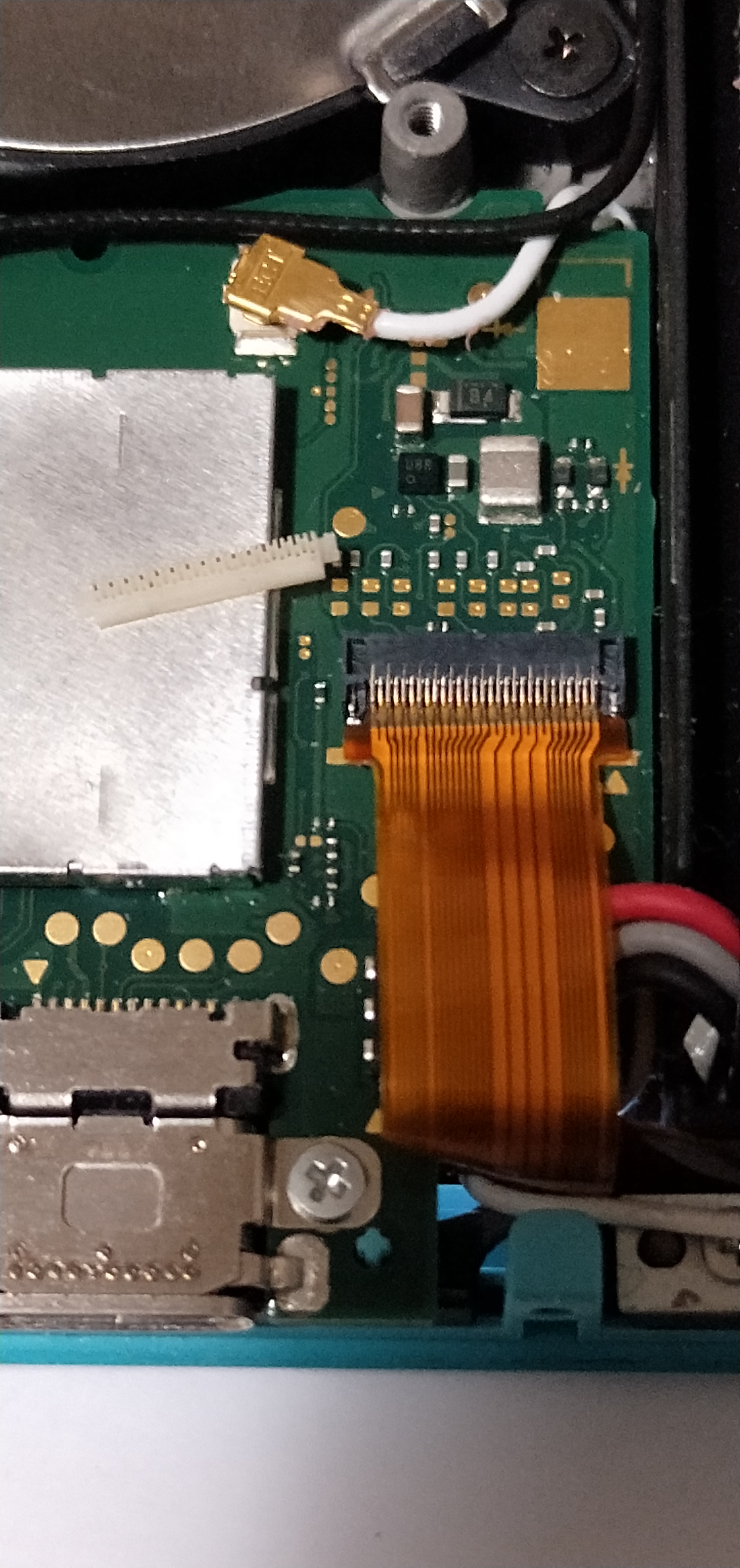

....question:
does picofly detect if LCD is functioning or not? does it have an effect on pico's operation?
the locking mech on the LCD (?) flat cable came loose and i think this is what causing the PINK LED (?) have to test further...
but when i applied pressure on the connector (still without the locking mech) lite lcd still working ( thank God! 😭)
..now how to put the locking mech back....

that's not LCD connector but its the backlight and left side D-PADS and power button
ohh, thought it was... although i wonder if that being disconnected has an effect on the Pico, hence me getting Pink LED after checking all wires are OK...?
..I'll try to re assemble again tomorrow (2 am here)
No, nothing else would effect on pico except the soldering. The glitch sequence still works with only battery connected+power button push

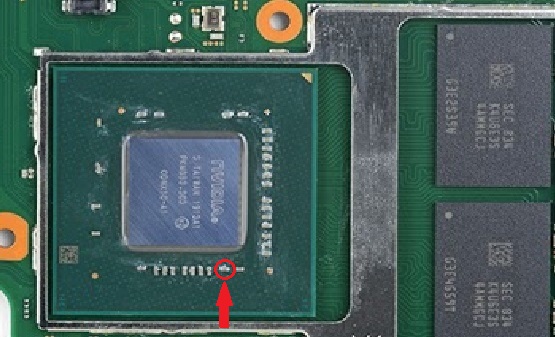

Gud day all. I'm new here just moded my switch v2 (mariko) using picofly in which a cpu capacitor (SP2) got remove/damage i would like to ask what is the value and its ok for it not to be replaced?

It is POSSIBLE but WAAAAYYYY closer to impossible to put JUST the latch back. In my experience, the whole connector needs to be replaced. Not an easy task to solder plastic pieces, you need more tools than just an iron (I use a bottom\pre-heater and air wand).
I have seen people make different 'hacky' solutions work, though. EG shove a small piece of plastic in w\ the ribbon and then tape\glue the whole thing down.
