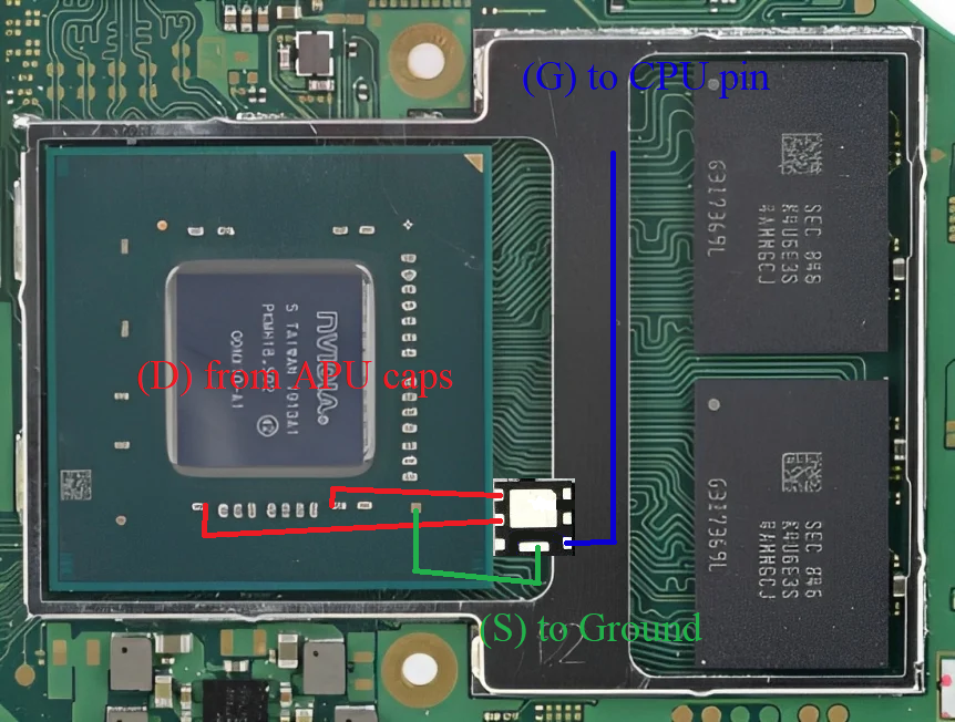

Hi guys, I salvaged the mosfet from an unused v1 flex cable and I need to install it into a Mariko switch.
According to a previous poster, it's a NP2016 mosfet (Here's the data sheet).
It has the same layout of the other more used mosfet and it looks a little bit weaker (but it was on the original flex cable, so I would assume it to still be plenty enough).
That said, considering that rehius himself said that single mosfet install to both caps should work without issues, does the attached scheme image make sense?
And assuming I don't short anything but the single mosfet is simply not enough will something bad happen or can I just desolder everything and wait for more mosfets?
Also, can I use simple epoxy to keep wires and components in place? UV resin would cost me a liver (bonus pic of the epoxy I got from the local electronics shop)
Thanks!

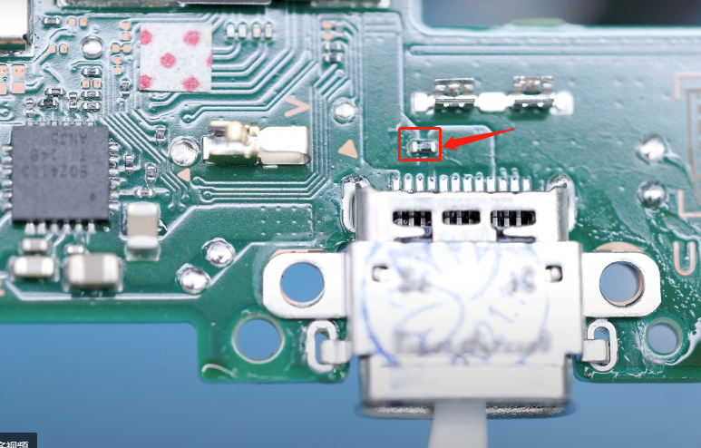

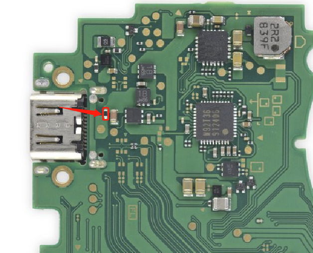

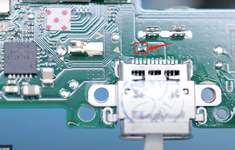

I think the fuse is inside the tegra, in the range of nanometer, can't be seen.
I mean a protection fuse, which cuts when there is an overload

Been repaired on hundreds of switch so far, I rarely see the Fuse/Charge port fuse cuts/blow itself for protection purpose, Switch dies but fuse alive for the most case.
And in theory, the fuse only cuts charging power but does nothing when you "overload" the internal system or installing extra chip and wires.
Any in theory, It only cuts charging power but does nothing when you "overload" the internal system or installing extra chip and wires.
but the oled switch and the lite have it? because i can't find it
