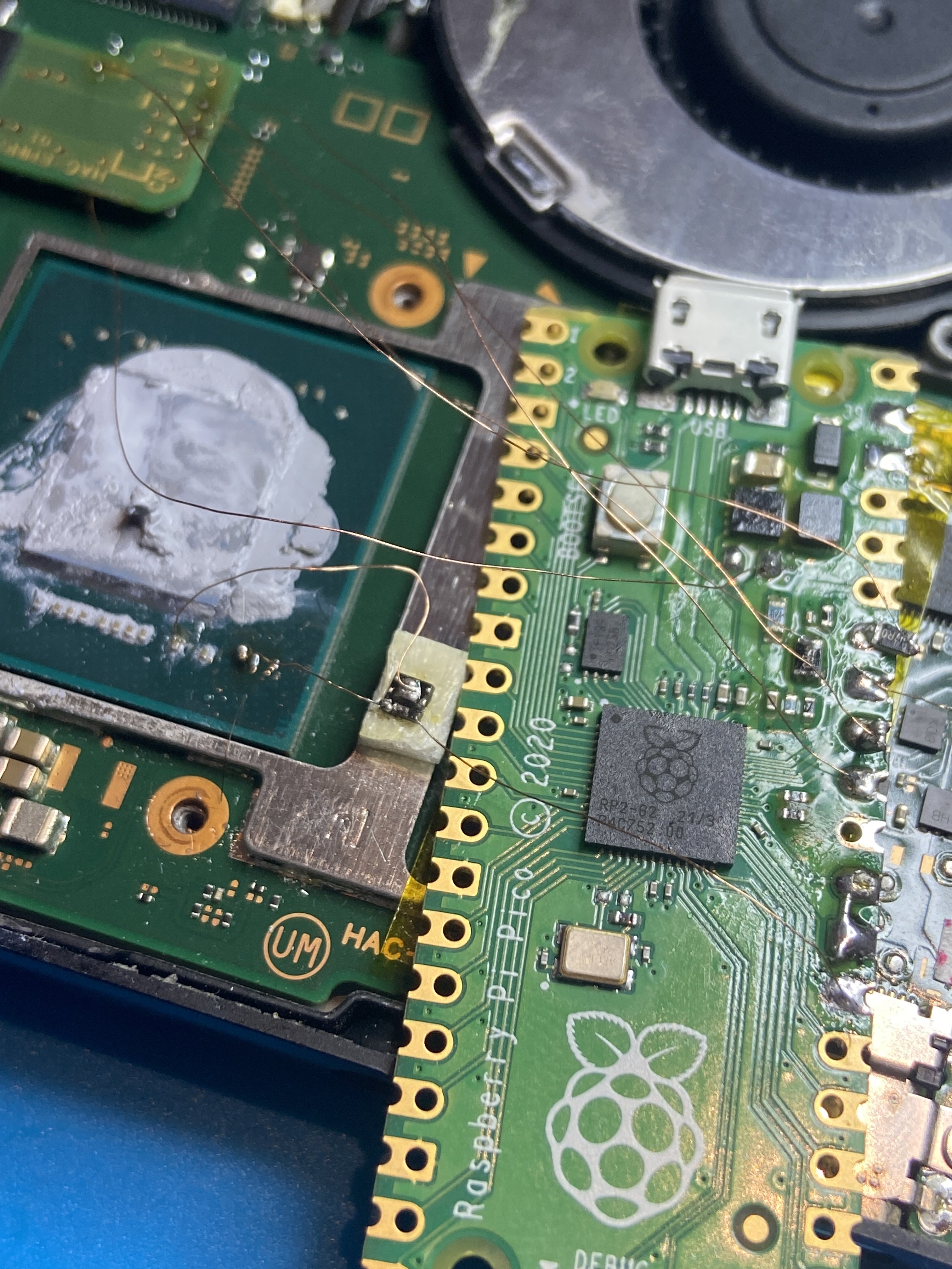

Hello. I installed Raspberry Pico on a V1 with a MOSFET and I was really happy with it, all diodes readings were correct, right before I booted I decided to check the readings one last time, and accidentally I placed the positive prob on ground ,and negative on the MOSFET's G pin. It gave an insane reading and now nothing. I get 0 on the diode when placed on G. Did this kill the MOSFET, the cap?
The Switch boots to stock firmware with no problems.

replace them and check?
