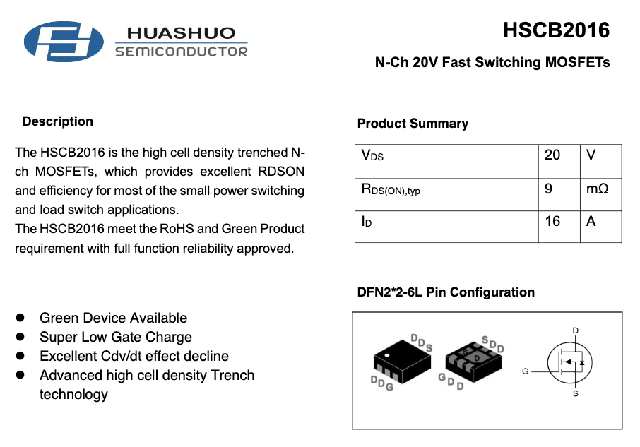

Hey guys I ran into a parts issue with the NP2016 when having my boards manufactured and spent a bit of time filtering results to find a comparable MOSFET. I ran across the Huashuo HSCB2016. It appears to be a clone of the NP2016, and they are available through Aliexpress, eBay, and LCSC.
I attached the Datasheet for it but here is a screenshot of the first page.

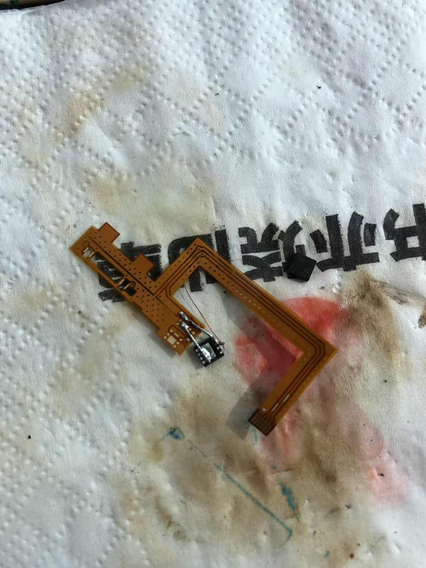

I accidentally dropped this while removing the usb port. Can I use rp2040 for the switch when I lose this? Thank u
I believe these are part of the decoupling caps based on the schematics for that device. It should work fine without them, they just smooth the power going into the power supply from the USB port and would only be used during flashing. The board will derive power from the switch afterward.

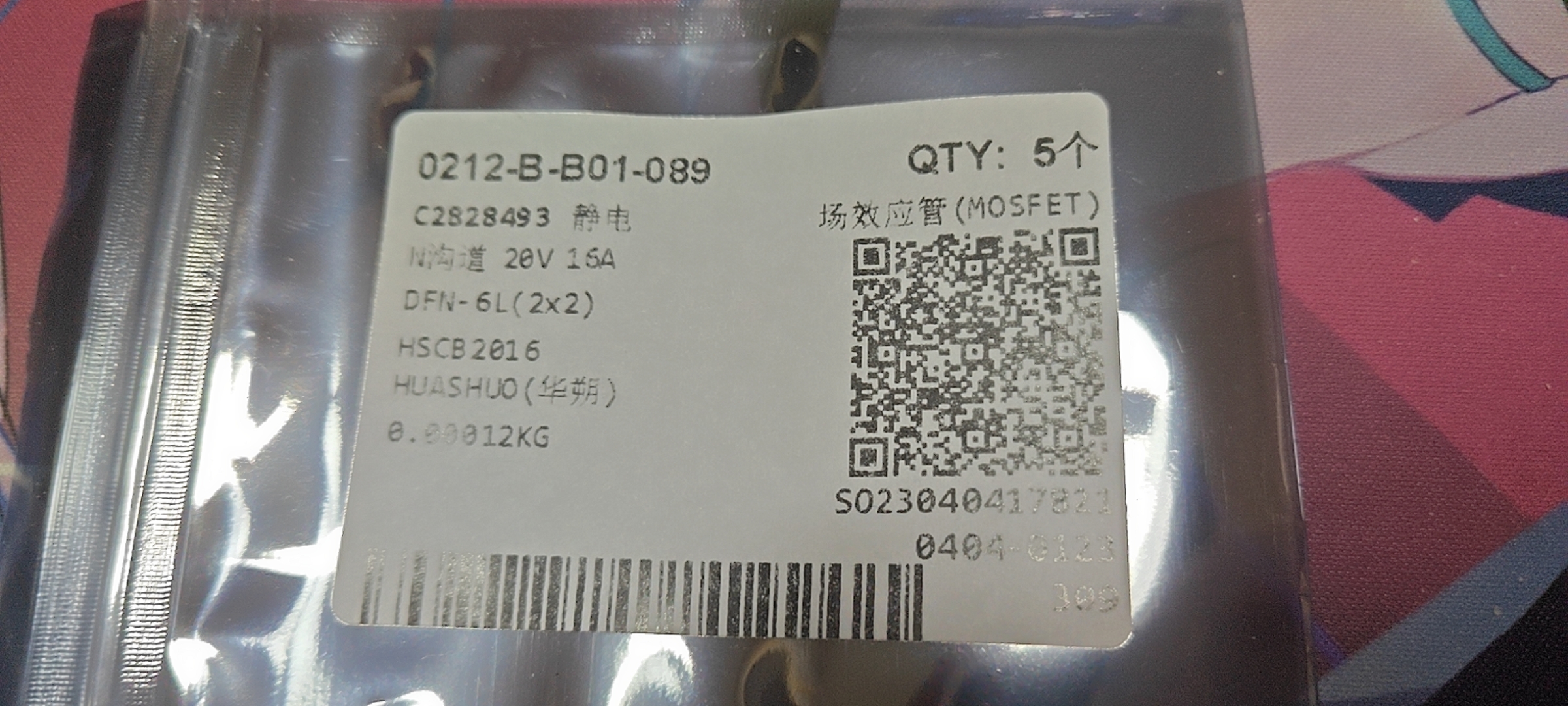

I've bought this but haven't tested it yet
However, I think the AP50N03DF is a better choice
